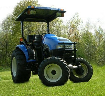

Gary we used a set of Signal Stat snow-plow lights with good results. See attachment

If only I had a canopy.... /forums/images/graemlins/smile.gif
