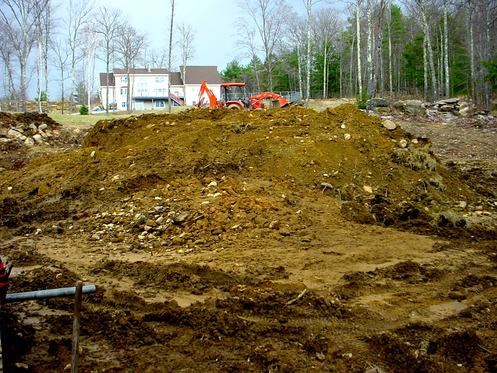

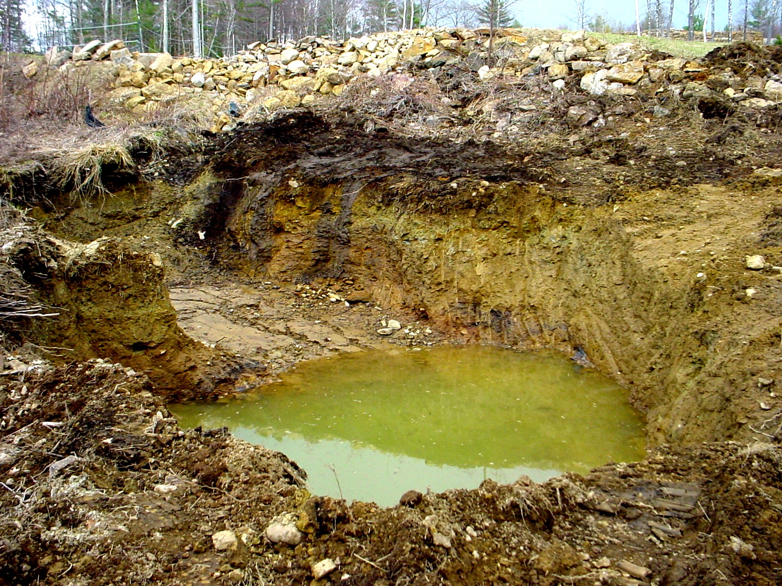

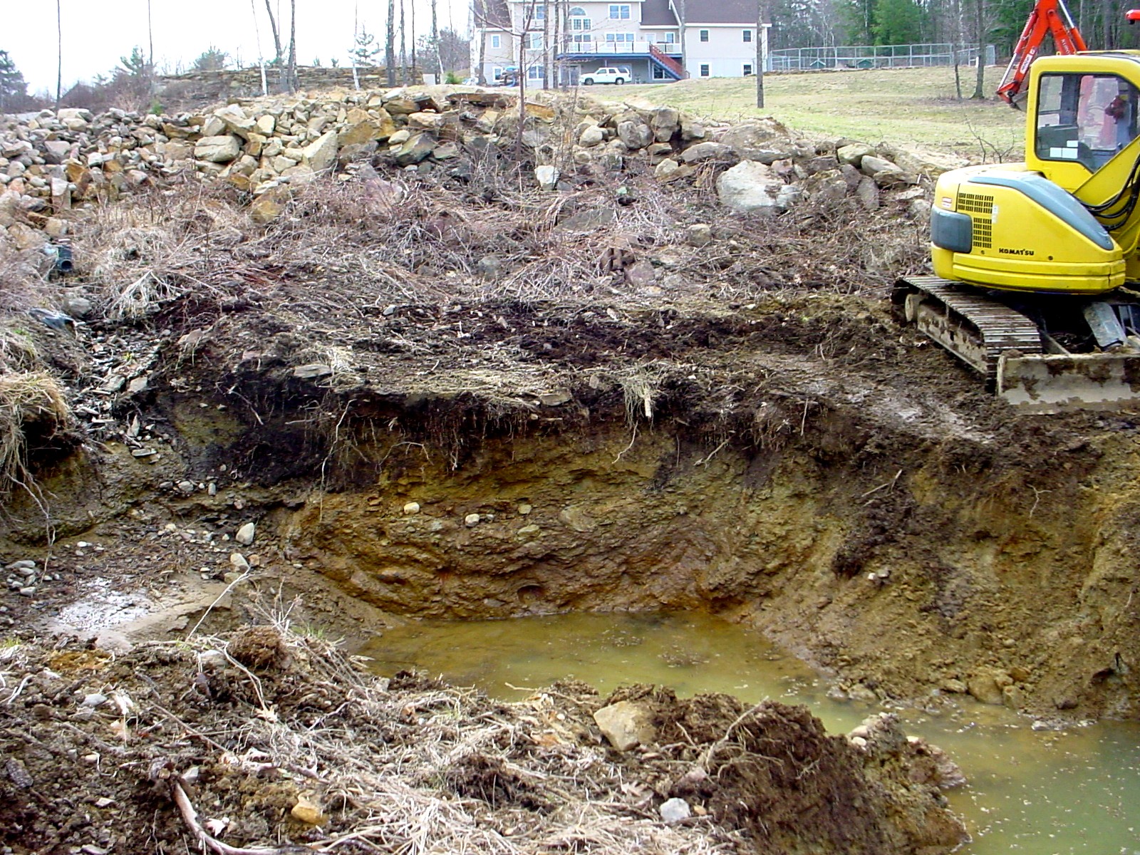

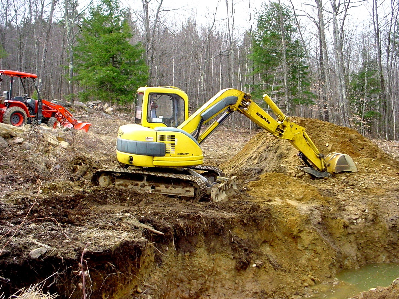

I just started searching for an "Off Grid" irrigation pump during this dangerously dry Spring in Northeast: Good time to dig another deep pond.
I'm digging a 12 deep pond at least 50 across for water storage for irrigation. My static lift to the fields is about 50' and I figure I need at least another 50' of dynamic head (100-120' TDH total) at 3-5 GPM.
