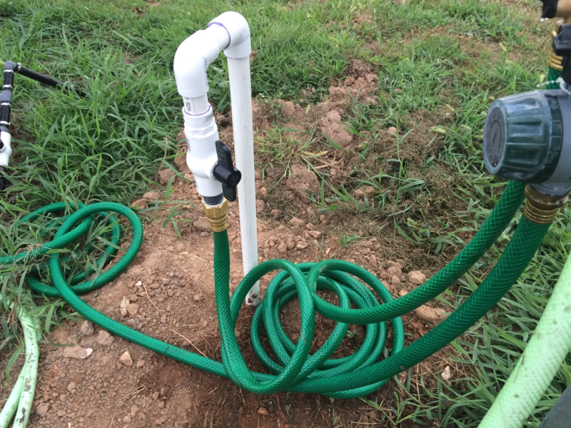

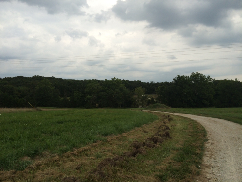

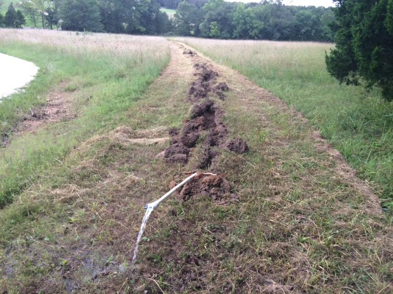

I had a similar situation with our acreage where I wanted to plant a tree nursery a couple of years before building our house. I ended up using solar power to pump from our lake on a drip system. It worked great!! I also do this now for my wife's garden. I have a thread on Tractorbynet that I posted a few years back. I'll try to find it and send you a link.
Thomas
   / Irrigation economics and logistics #29
This thread? http://www.tractorbynet.com/forums/projects/160816-solar-powered-watering-system-tree.html
