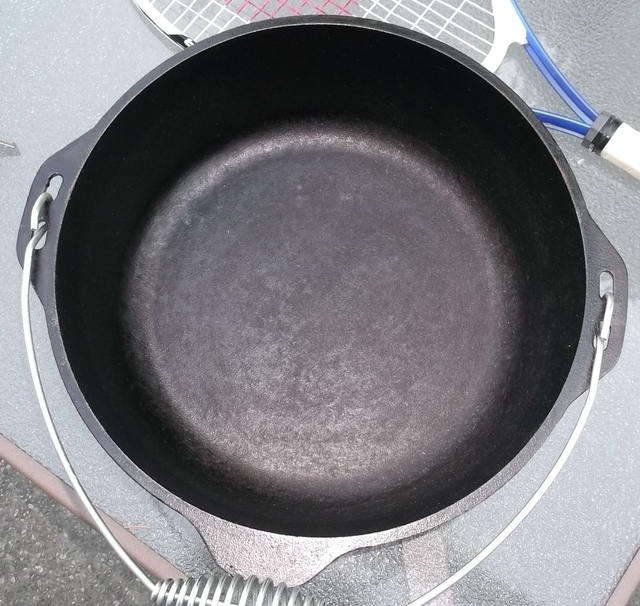

No tomatoes or soap have been in the skillet. I have noticed an improvement when I cook at lower temps, so you are right on with that tip. I think a big problem is the "Lodge" brand. The bottom of the skillet (inside) is kinda rough and it takes more seasoning to fill the voids. I read of the issue in other reviews.
Oh, mainly I'm cooking meats and breakfast foods in the skillet. Eggs, bacon, sausage, chicken , pork etc. Eggs are the toughest
Eggs slide off mine like you wouldn't believe. The Griswold is smooth, smooth. I never have used Lodge. Pork and chicken do stick a little the way I use mine. But like I said, I take mine down to smooth metal every time. Some people let a little buildup occur, I don't. I never cook past half way on the temp setting on my induction cooktop.

Getting cast iron to an "almost" non-stick state can take some time and patients. If the bottom and sides still have that rough look it's not seasoned enough. I use high heat oil in mine (peanut, canola etc) placed in a 300* oven for at least 30 minutes. Let it cool, take it out, wipe it down and repeat a couple of times. When doing eggs I still use some non-stick spray. I never fry bacon, I always bake my bacon.
After each use of the pan I clean it with hot water, place back on the stove on a high heat burner and wait till it just starts to smoke again, then turn the heat off. They get touched up with oil every now and again when I see spots that are getting bare. If there are things stuck to the pan use plastic or something non metal to scrape it off. I treat cast iron like teflon and try not to use to may steel utensils with it.

I belive lodge brand are rough sand cast and not finished. The older castiron was ground to a finish on the inside to leave it much smoother.
Lodge can be significantly improved if you take a flap disk sanding wheel (4.5" grinder) to it and smooth out all those sand cast bumps.
Then season well in the oven.

The Plant Manager has amassed an impressive collection of pans & skillets from eBay, Goodwill, tag sales, etc. Schism is right about the surface finish on the Lodge brand - they appear to be as-cast from a sand casting process, whereas the Griswold and Wagners are mostly machined or ground to a fine finish. I have been very disapointed with the Lodge cast performance and will try the flap wheel on them to see if i can bring them up a notch.

I use a lodge for eggs all the time with no problem (and a little butter as well). We just season it by putting on a little over medium heat and wipe a bit of canola oil on it until it smokes a bit. repeat this a bunch of times. I will usually do this a few times when prepping the ingredients I am cooking such as asian style stir frys, fried rice, or letting a steak rest a bit prior to pan searing it. If something gets stuck even after rinseing and a light scrub with a brush (like potatoes as mentioned) I simply return it to the heat and add some oil and kosher salt and use the salt to sand away the stuck bits of food with a wadded paper towel pushed around with a wooden paddle. This seems to clean the non-stick surface that has built up without removing it.
Up at our country place all the cast iron is over 100 years old (a mix of Griswold and no name pans) and doesn't need anything to improve the non-stick performance. I've considered sanding the Lodge pans smooth. I have a larger pan that the non-stick surface got damaged (spouses training has not been completed) which I haven't gotten around to renewing and I will likely try smoothing that one out prior to seasoning.

Exactly. Quality cast iron is smooth as glass, even before it is seasoned. Once it is seasoned, it is as close to perfect cookware as it's possible to get. Sand cast cookware can be brought up to quality, but it's a lot of work. Use corundum sandpaper, a small pad sander, and be prepared to work on it for hours. It may take several days on and off to buff it down to a smooth condition.
This may be dumb, but why not a flap wheel on an angle grinder?
