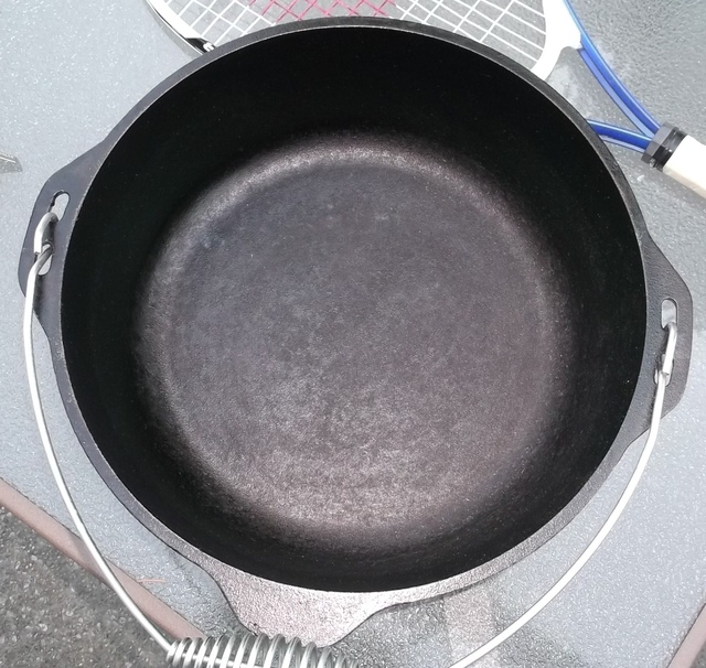

General Lee, Morning..... the best oil to use to season Cast Iron is an oil that has a high iodine number... Flax seed oil fits that the best.... It has a low smoke point and should not be used for frying.... Put a thin layer on the pan and heat to 400-450 deg F.... It will smoke... the oil polymerizes into a very, very hard coating.... I have a new #10 DO with about 6 coatings on it... Nothing sticks to it now.... beans and hocks rinse right out... spaghetti sauce, tomato base will rinse right out.... It may need an additional coating and baking but the coating is still there... Flax Oil can be found on Amazon or your local health food store.... It is worth the price.... After coating CI for years with other oils that don't really work, I am very happy with the Flax Oil coating.... Dave 7-12 Do.jpeg

General Lee, Morning..... the best oil to use to season Cast Iron is an oil that has a high iodine number... Flax seed oil fits that the best.... It has a low smoke point and should not be used for frying.... Put a thin layer on the pan and heat to 400-450 deg F.... It will smoke... the oil polymerizes into a very, very hard coating.... I have a new #10 DO with about 6 coatings on it... Nothing sticks to it now.... beans and hocks rinse right out... spaghetti sauce, tomato base will rinse right out.... It may need an additional coating and baking but the coating is still there... Flax Oil can be found on Amazon or your local health food store.... It is worth the price.... After coating CI for years with other oils that don't really work, I am very happy with the Flax Oil coating.... DaveView attachment 303631
Good stuff here on flax oil Chemistry of Cast Iron Seasoning: A Science-Based How-To
