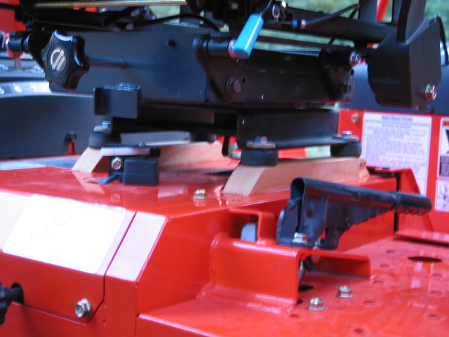

I've got the big guy problem too. My seat was far enough back, but too low for comfort. Here's some pictures showing what I did.
While scrounging in the junk box for parts I came across some fat rubber grommets and added them to the project to cut the vibration. I think these grommets were originally used on some old Chevy PUs to isolate the cab from the frame. Works good. Don't over tighten the grommets. Use Loctite instead.

Thanks, Scotty. I hadn't considered the wood, and I like the grommets. I appreciate it.
The wood was just supposed to be a quick and easy way to see if the height was right.......that was almost 5 years ago...good thing we oiled that wood.. :)
