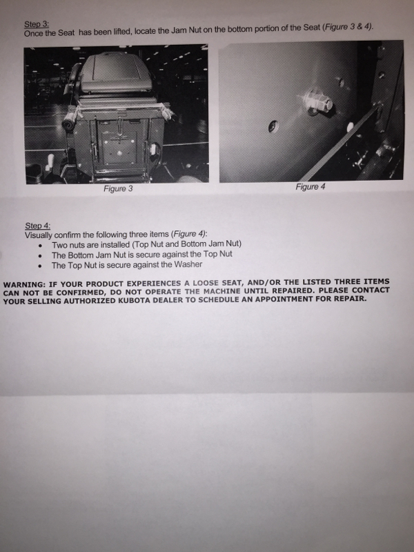

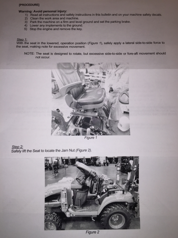

Here the letter I received today. image-88430397.jpg image-3641489792.jpg image-1185905617.jpg
Sorry but my phone did not rotate the letter the correct way.

My seat came loose the second day after I got it last year.They picked it up and had to replace the plastic slides and bearings......JB.

Got it today - heck, it is a nut, tighten it and move on. Should take less than 1 minute.
No way would I go to the trouble of taking it in to a dealer to have them check/repair it. If that is the biggest problem I ever have I will be VERY happy!

I would have done that but half the parts found their way out and were missing.The also came out and got it and brought it back...JB.

Got mine in the mail today also . I already fixed it myself by using a nylock nut in place of the jam nut . Not worth renting a trailer and hauling it thirty miles . It would be nice if they would pay for pick up and drop off too , but that is asking a lot .

I drove mine (BX25) to Barlows last week and drove it back this week after an adjustment. Doubt I'll drive it back to them for this check, believe I'll do it myself and put loc tite on it if it seems loose.:thumbsup:
