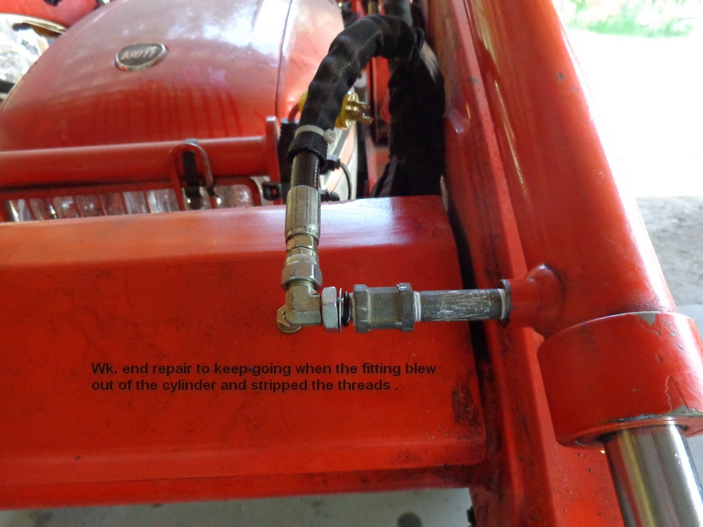

While I'm at it here's a fix I did on a wk. end to finish a job when the fitting blew out of the cylinder that had never been threaded properly to begin with. Pipe thread into m on the cylinder and metric on the ROB into pipe .
I've now redone it with a solid 90 1/4" pipe thread into the cylinder and no. 5 other end for the hose.
This cylinder was a reject from the start after replacing 2 pistons I looked in the cylinder and ended up honing it with a break hone because the weld they did for the fitting had a jagged surface inside.
