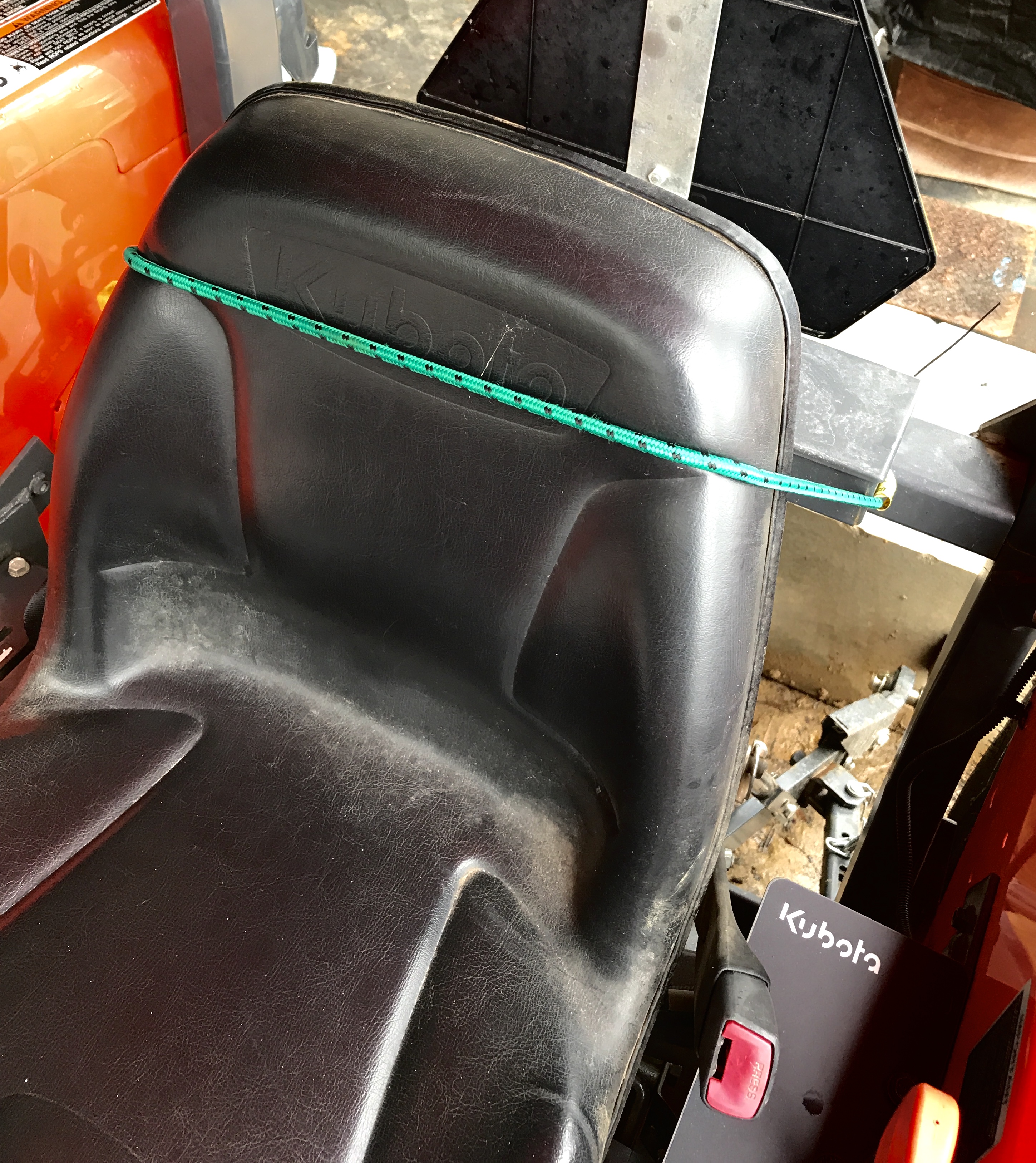

I was loath to permanently disable the safety switch, but definitely need a way to stand while using the forks and when hitching the FEL implements. Trying to press down on the seat with one knee while trying to control the hydrostatic pedal with the other foot was not fun. So, in desperation I came up with this hack and it has been working perfectly.
A slight improvement might be to add a tennis ball or similar to the centre of the bungee, so that when one sits down one is given a definite reminder that the safety switch is not engaged.
Nice simple solution :thumbsup:
