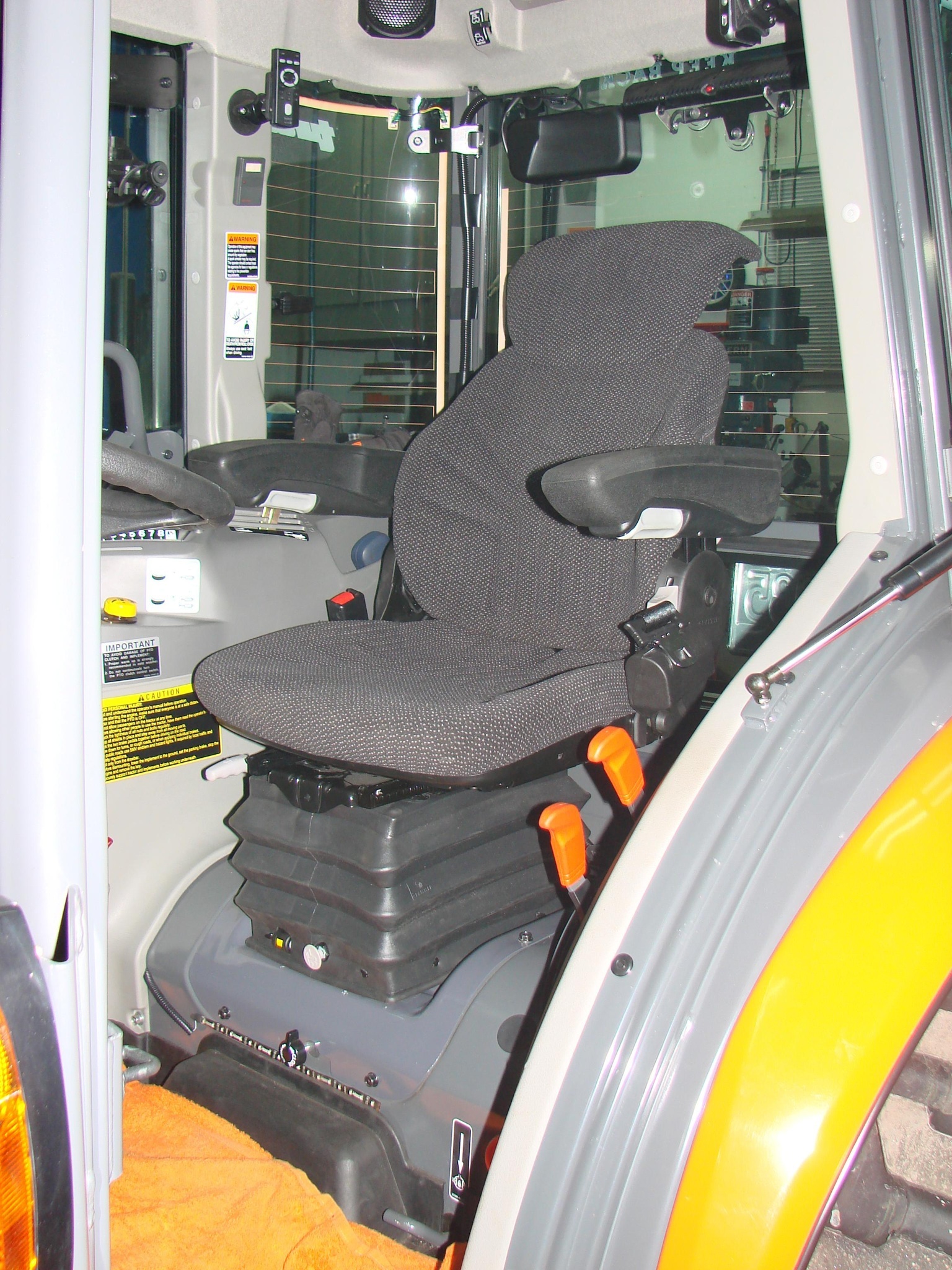

When I had my 2008 Kubota GL4240HSTC the seat was good. Yes their were times it bottomed out but it was rare. The foam In the seat was soft and comfy as well.
When I got the 2011 Kubota GL 5740 HSTC I knew something was differant the minute I sat it it. The seat felt as hard as a rock. It bottomed out twice as much as the 4240's seat even when the spring tention was wound up as tight as it could go but when I had to travel the machine that's when life in the then 20 hour tractor was miserable.
I knew then I had to do something about it and after many hours of research I ended up installing the Grammer air ride seat. Yes it wasn't an easy install because the seat I used was never installed in a tractor like it before but now that I have 115 hours on the machine I can say it was hands down the best thing I ever did to this tractor.
I guess Kubota heard all the complaining because the air ride seat is offered as an option in the new 60 series tractors.
