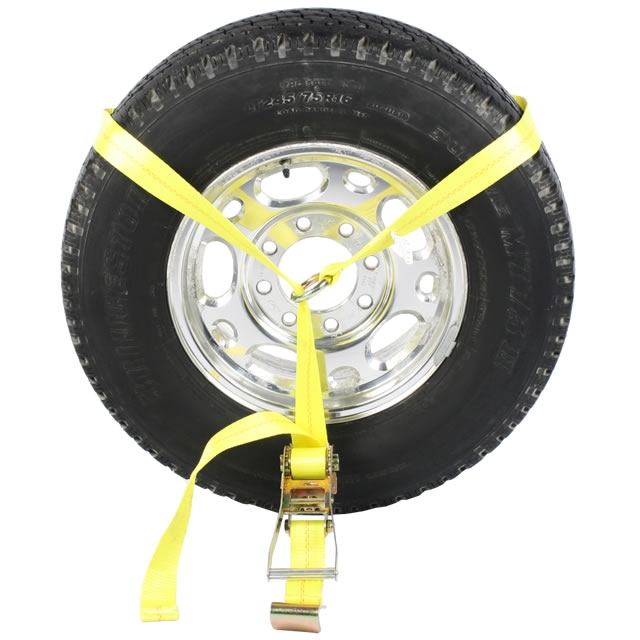

I've never really had a problem tying above suspension on my ATV's but my heavier SXS has been a pain. I've been breaking or cutting them. I picked up 4 of these side mount over tire straps and they stay tight and don't wear on the straps.
Side Mount Wheel Net w/ Ratchet and Flat Hook | USCargoControl
Thanks. Those are cheap enough and may do the trick. Like you I have not had problems with ATV's or anthything else. I tie down pickups, skid steers, backhoes, ATV's, etc on a regular basis and never have an issue but this rhino UTV is a pain. I think part of the problem is the suspension is stiff enough that you can't take enough slack out of it with the ratchet straps even though they are pretty darn right. When you hit the rough roads it starts bouncing.

The wheels on it won't allow running a strap through them.
These straps go over the tire, not through the wheel.

Yes the ones you linked to do and I will try them. I was referring to a previous post that said to try running the straps through the wheels.

I ordered the straps from us cargo control but have not received them yet. I have seen this style used by car haulers. The loop cinches the tire as it is tightened and it is pulling down so I don't think it can slip off the top.
