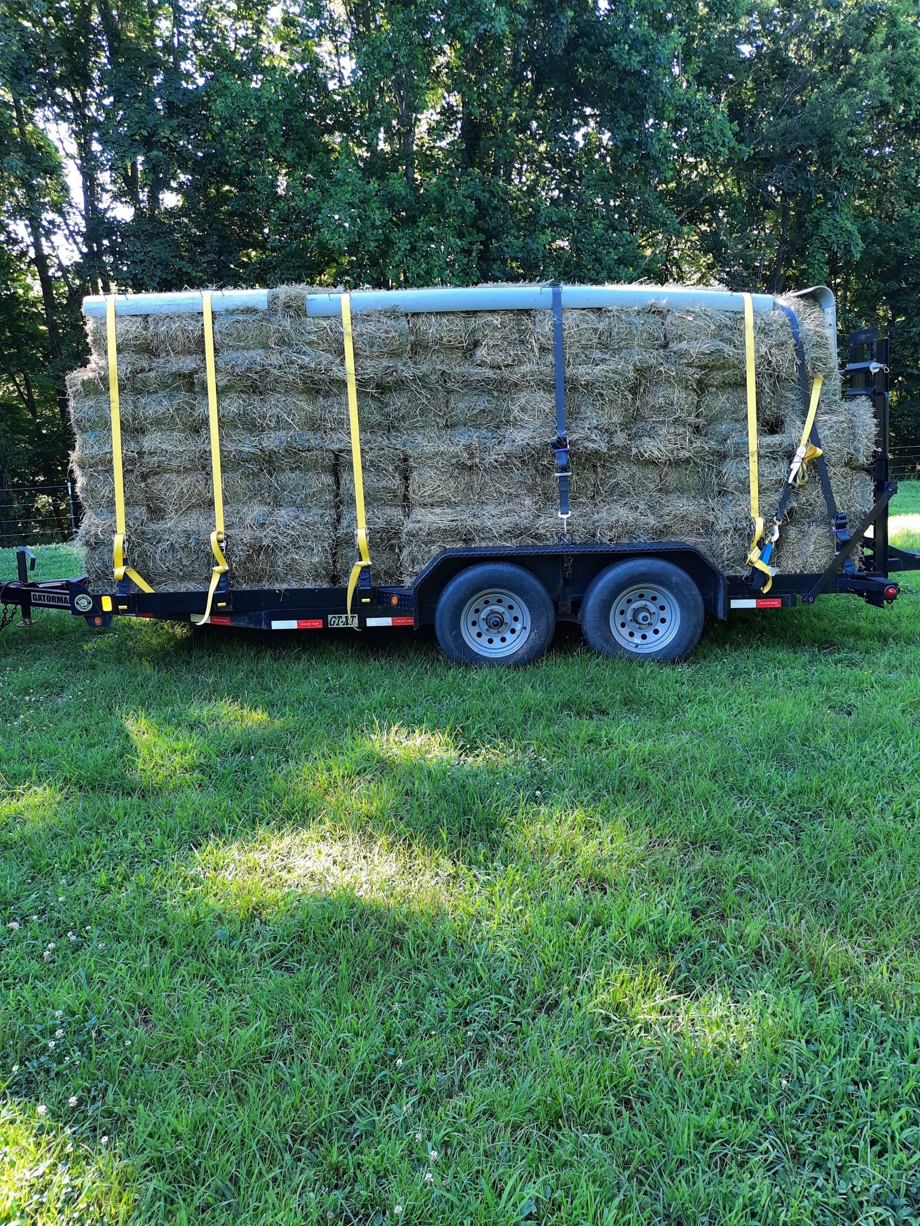

I thought that I would share some simple but effective modifications I have made to my 10k equipment trailer that I mostly use to haul a load of hay for our horses. These mods are also helpful for other uses.
I usually load 100 bales of hay. On the flat side, I can get five layers, twenty bales each. This load was loaded with a grapple. My hay supplier uses an accumulator to gather his small bales then picks them up with the grapple. He cannot get them into his hay barn which I will explain later but he does easily load them onto wagons to get the bales out of the weather until his customers can pick them up. The grapple picks up eight bales at a time. Two "drops" leaves room for four more bales plus a little extra so on this load, I placed the last two on the flat to just about touch the ramps. My guy only had 94 bales on hand and the last one was a "starter" bale, ie; the first one baled and a bit loose so I ran the rear two straps in an "x" pattern to ensure that it stayed put.
With the narrow trailer, loading on the side makes for a tall load hence I use plenty of straps to secure the load.
/ Low cost trailer modifications.
#2
Note the 6 inch PVC pipe split in half with brackets to keep the straps from digging into the hay bales. I can make the hour back road trip with the straps loosening very little. The longer one is usually used on the front of my load but due to the less than full load and the one loose bale, I placed it on the rear for this load.

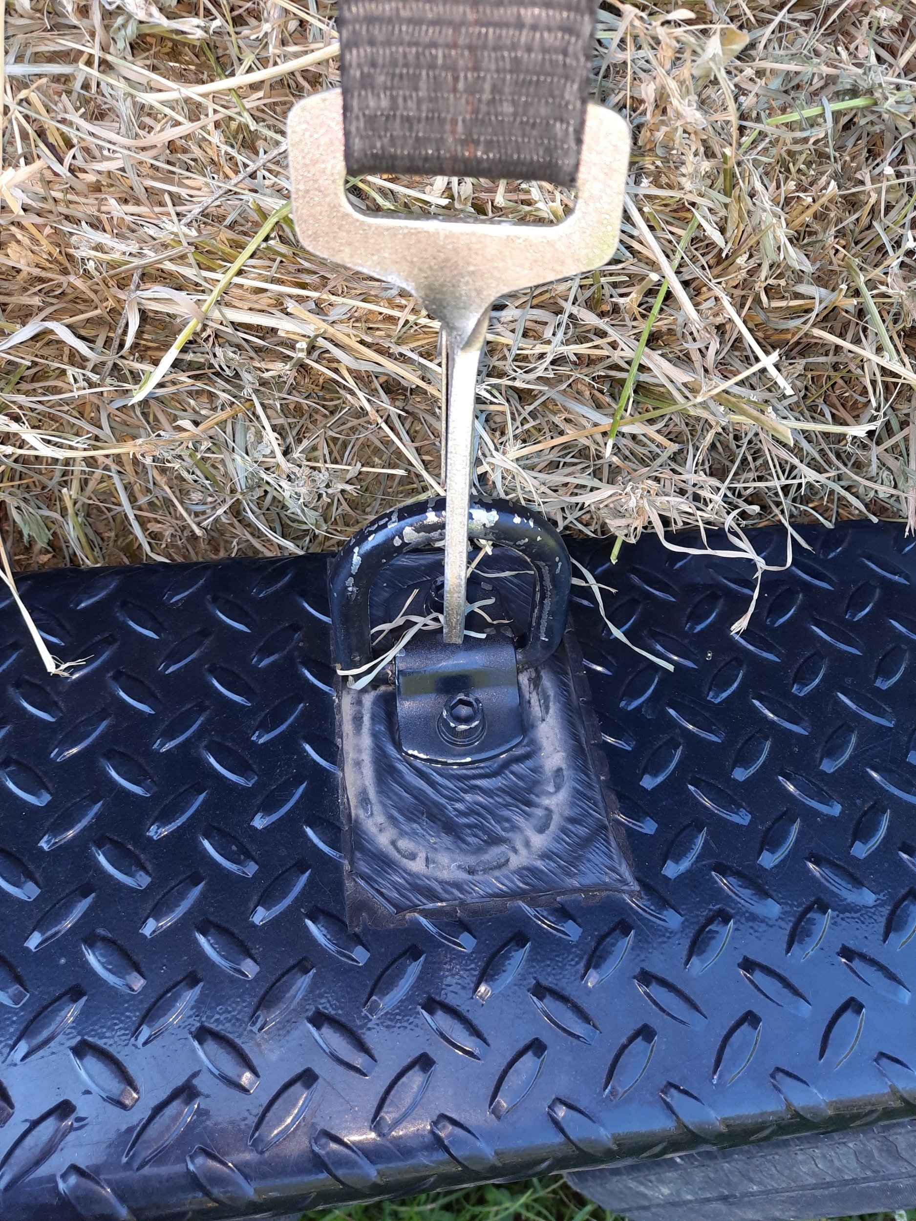

Now for the mods. I welded "D" rings onto the front load stop to secure my flathooks. The vertical angles were only factory welded to the vertical flat side of the angle so I had to also weld them to the flat side under the rings. Prior to this mod, I had to use axle straps on the trailer frame.

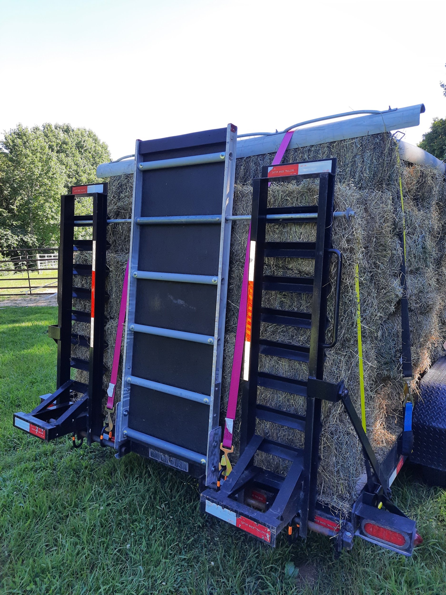

I made up the center ramp to replace a piece of plywood that we used to slide the bales onto the trailer deck rather than toss them. I took an old ladder and widened it to fit onto the pins that hold my ramps on. The one foot spacing on the ladder lines up with the angles on my ramp. In the verticle position, the ramp is secured by sliding a piece of heavy wall conduit through the angles. I used some 1/4" aluminum stock to make open brackets to secure the bottom. I can also use the ramp to walk bales of other items onto the trailer. (I also have a heavier ramp with no gaps to load heavy items by hand or with a cart). The ramp also makes for a nice backstop.

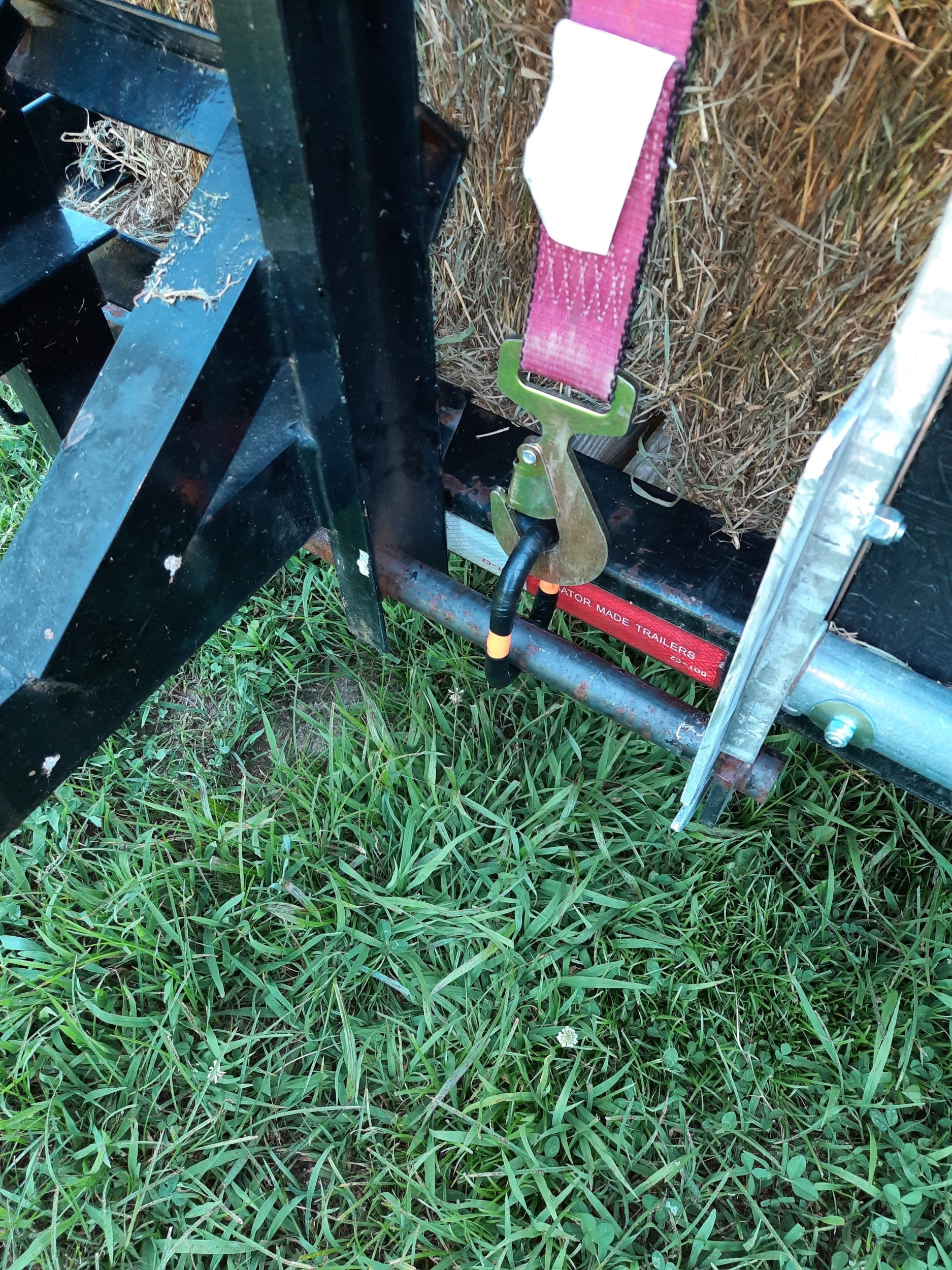

Lastly, I put some oval lifting rings on the pins that hold my ramps. Prior to this, I had to use axle straps to secure my straps to the rear of the trailer.

I made the ramp by cutting an old aluminum ladder in half and using scrap PVC and metal pipe to widen it. I sized the 1/4" aluminum brackets to drop onto the ramp pins while wedging against the trailer when upright so it stays put. While it does hold me if I walk on it, it is not heavy enough for much else.

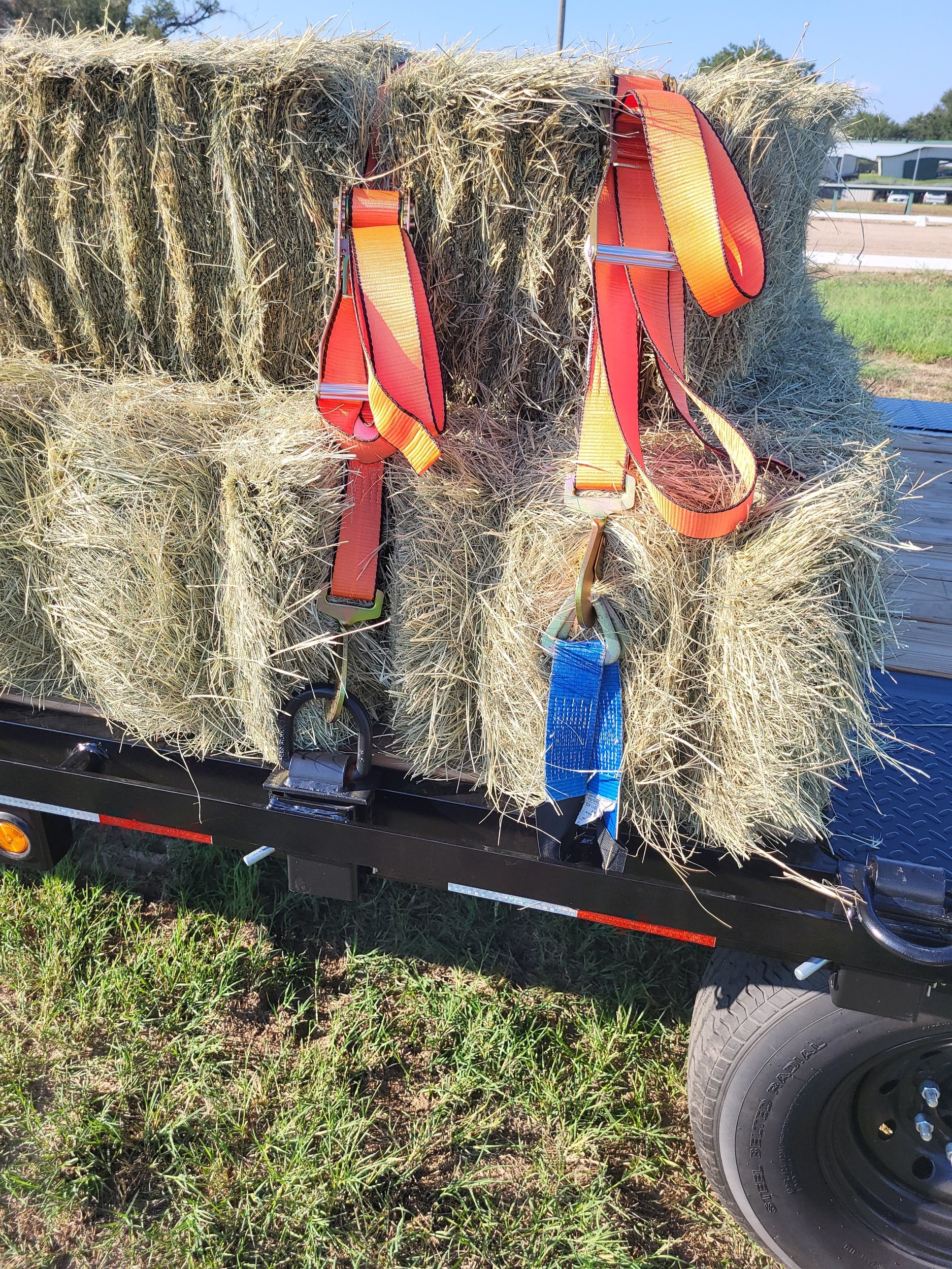

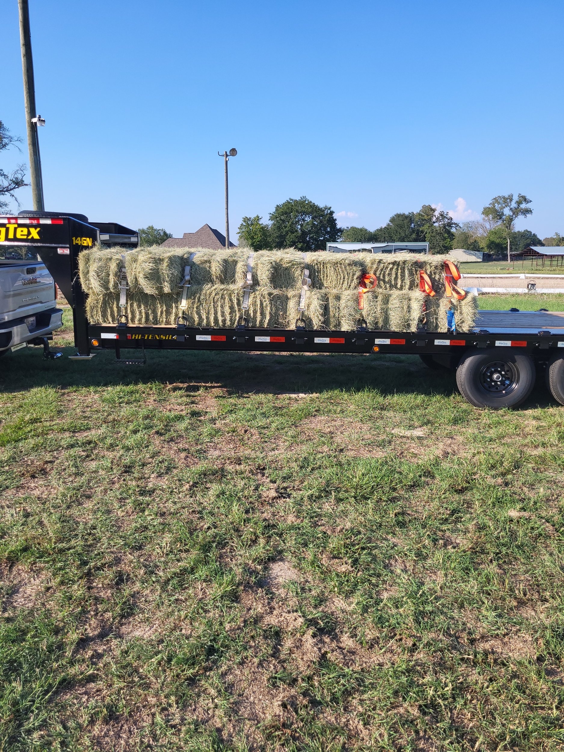

Looks good, I like the PVC edge protector idea. I also use 2" straps with twisted snap hooks when I haul hay. My Big Tex 14GN has stake pockets every 2' so I put d-rings in each one. I use an axle strap on the round rub rail support if I need one in between. Makes it easy to strap everything down by myself, plus even if the straps loosen up a little they cannot come off.
No rub rail on my trailer so I rely on the pockets. I use J-hook straps with rub protectors so I can drop the hook through the pocket and bring it up the outside so there is no worry about coming loose should the load move. I have both twisted and straight hooks that I use with axle straps and now the D-rings.

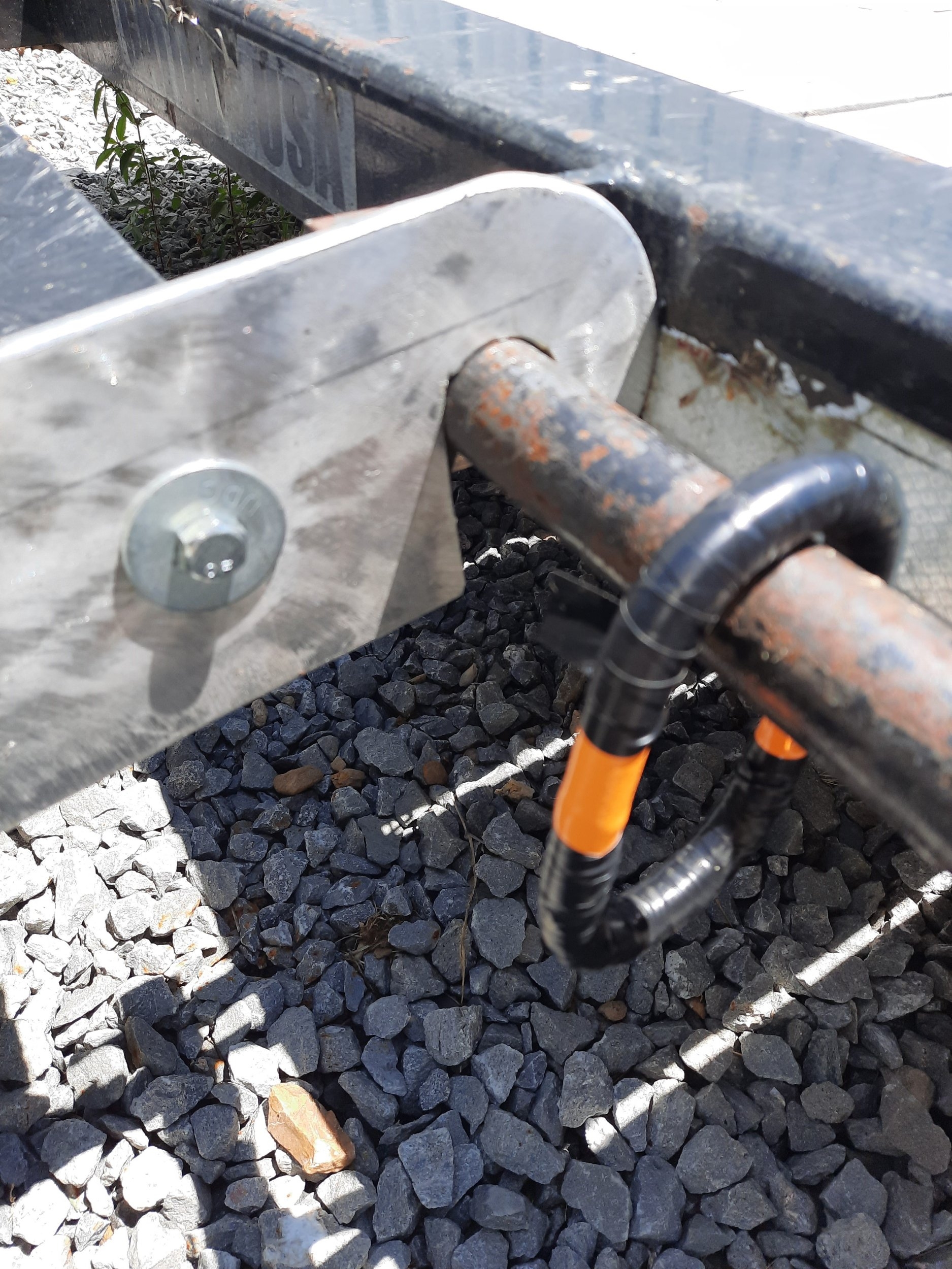

Here is another close up of my hay ramp hooks that allow me to raise and secure it in a near vertical position. Originally, I made the ramp to slide bales of hay onto my trailer rather than to use a sheet of plywood. I used heavy wall conduit to secure it top and bottom. Then I had occasion to load from a ground level barn so I kept the ramp pinned to my lowest angle on the ramps. That did not work so well so I added the aluminum brackets.
That left a large gap which is a safety issue but I rarely load from the ground. The ramp also does not lay flat on the ground.

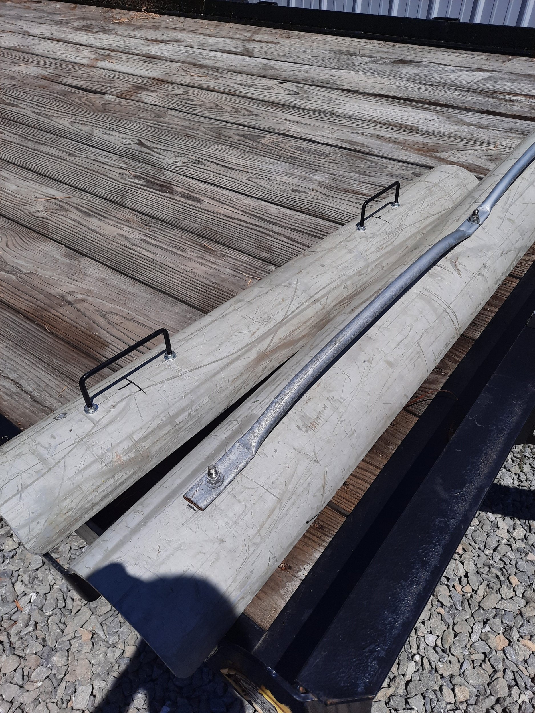

This is my ramp for loading with a hand truck. This was half of a ramp that I made for the box truck that I used to have. It's heavy and lives out in the weather so it looks rough. The steel tabs perform two tasks. They support the ramp so that the aluminum landing plates does not get bent and the bent tabs hook over the ramp pins to secure it to the trailer. The aluminum plate at the base provides a smooth transition to wheel my hand truck over
