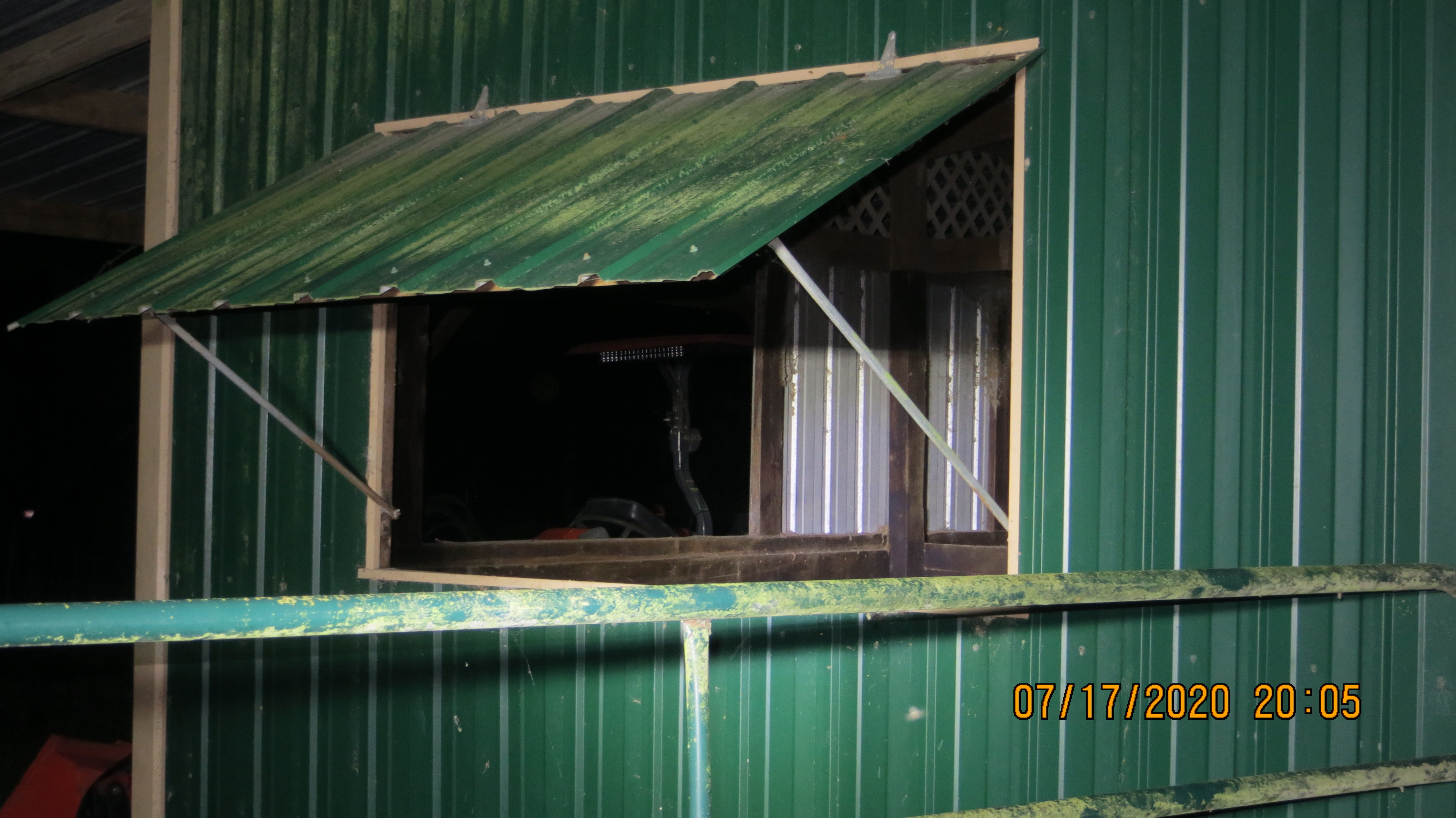

When I built my barn I used the pieces of metal I cut out for the windows as awnings hinged from the top. This keeps out the hot sun and the rain. I used a couple pieces of 1/2" EMT for the braces with holes through the ends to go over studs with wing nuts on the studs. It just takes a couple of minutes to open or close the windows when needed and a latch on the inside keeps them secure. These large 4 X 6' windows keep all of my stalls nice and airy.

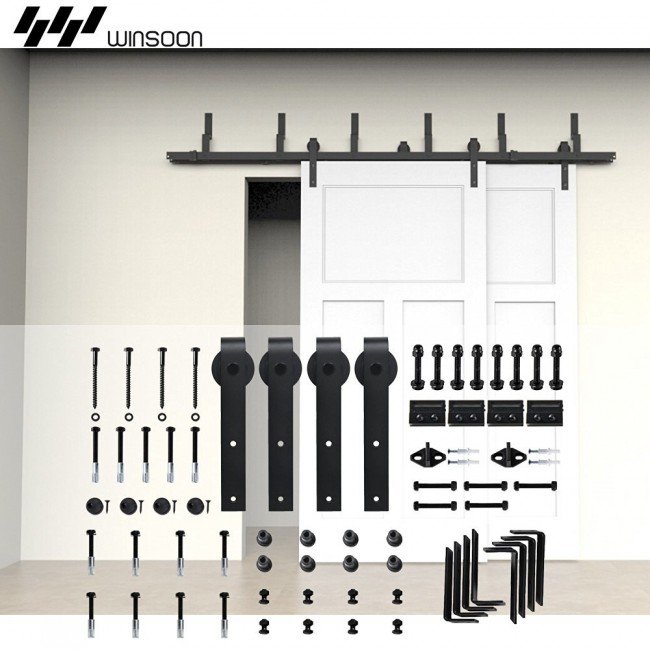

What about sliding barn door style 'doors'? They are smart clean stylish and time proven. And given their popularity in recent years, there are a ton of hardware opitions and styles to choose from. Even if you have two windows in close proximity to each other you could make them wide enough to fit both windows with one 'door'.
You can essentially make them and length and width you choose.images.jpgdownload.jpgwinsoon-5-16ft-sliding-barn-door-hardware-bypass-double-track-kit-bent-basic_356_650x650.jpg
