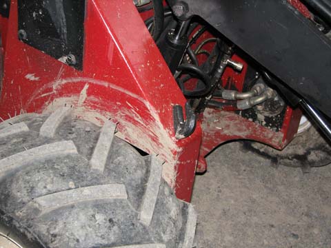

I had weldable hooks attached to the front and rear of my tractor (tractor is made out of 3/4" plate steel so easy to weld to).
Ken
