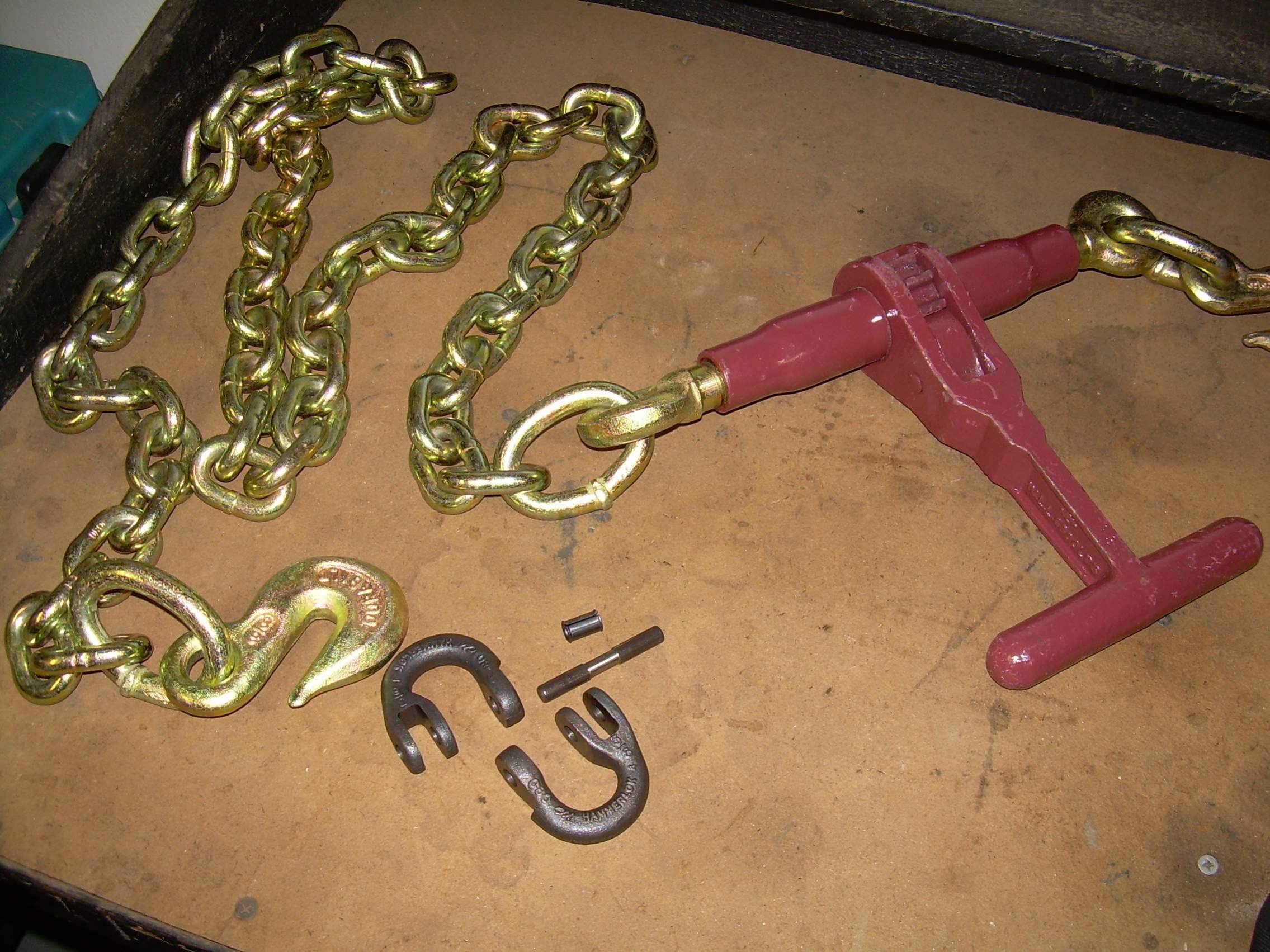

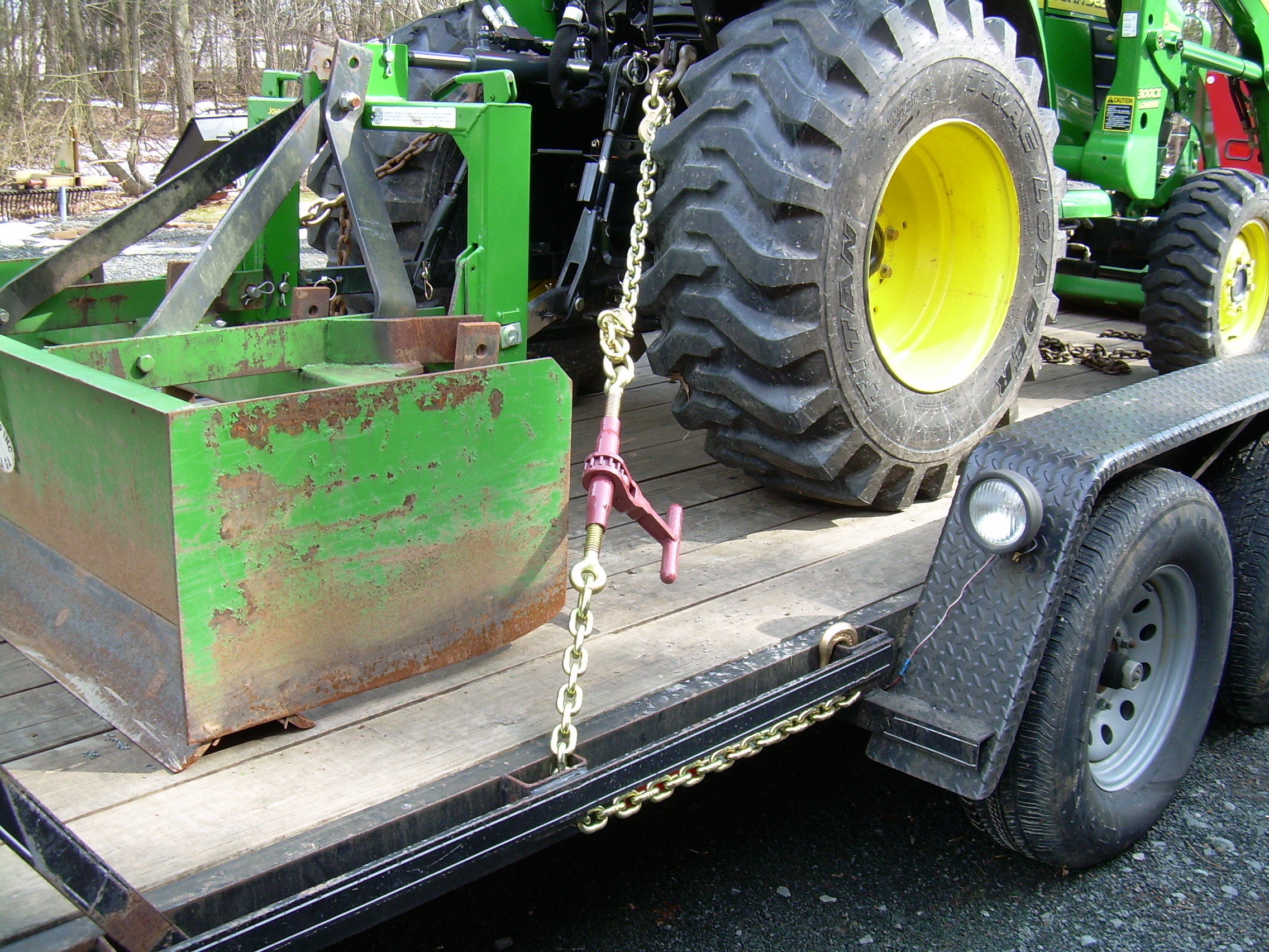

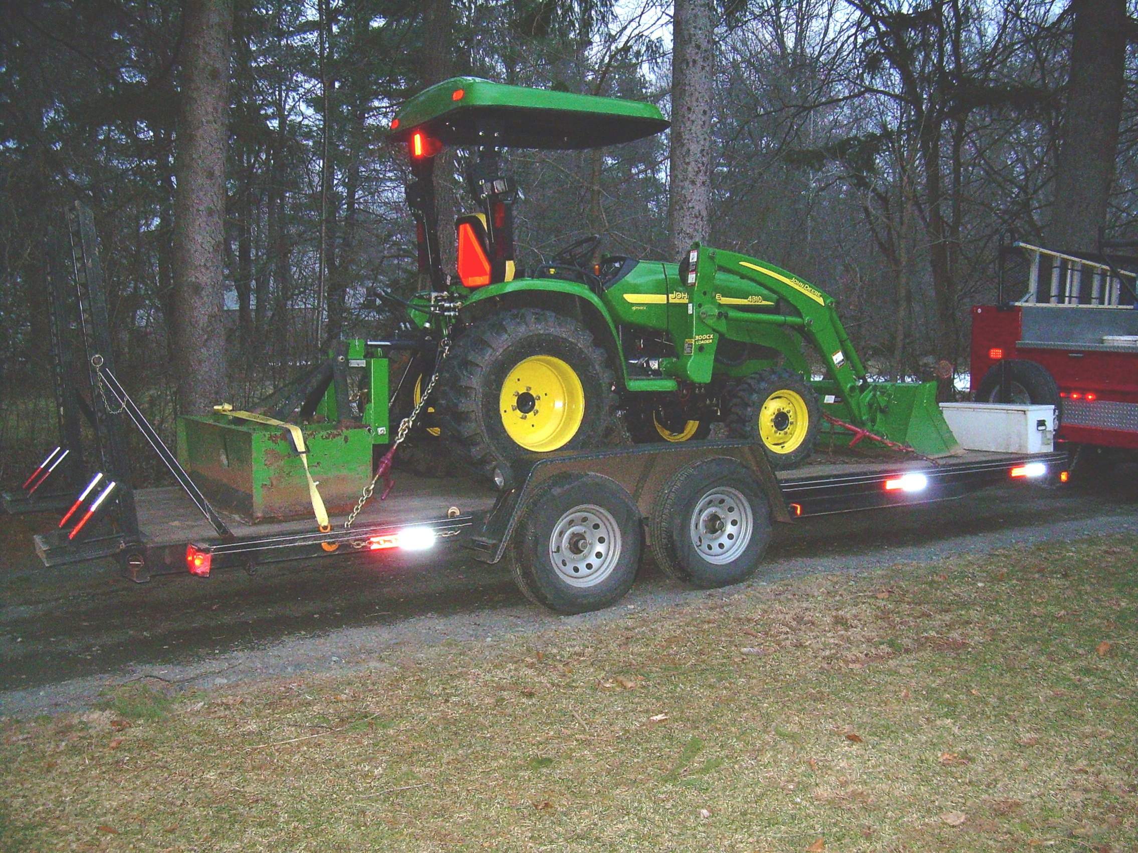

I agree that's why I'm going with all four corners with 3/8 chain and binders, bought 2 new G70 chains and matching binders and already had 2 5400LB binders and unrated chain. so that's about a 6x safety factor using the weight of the tractor added to the 4x safety of the chains and binders, so that equals a 20x safety factor total, I am pretty sure this could withstand a roll over a cliff.

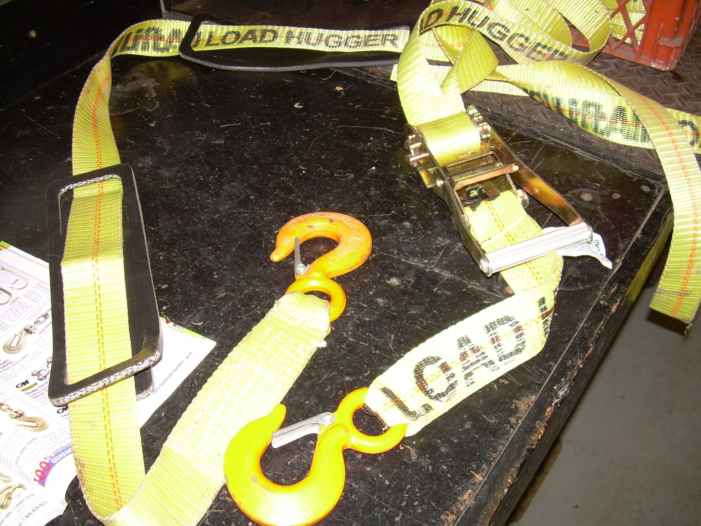

I will use my 2 ratcheting webs for implements, I have not had my Back hoe on in 2 years, but I do want to be able to move that as well, since it will be attached to the machine I would think just rest the bucket on the deck and thread a web strap thru and tie it side to side.
I've also got an extra new ratchet binder I bought from AWdirect, it's a tee handle 6600 pound rating that had a 6' 3/8 G7 chain already attached, I though it would be better to have chain attached but found it isn't, then I cut the chain in half and installed another hook cause I thought that might make it better, but I just decided to stay with the conventional binders. Can't return this one now since I cut it, turned into a $60.00 experiment, I may find a use for it, maybe with the back hoe or other separate implement not connected to the tractor like my forks etc.
