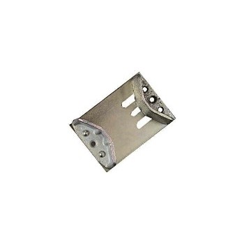

If I understand what it is you are looking for, this is what should meet your need. https://www.hardwareworld.com/Zinc-Sliding-Door-Guides-Visual-Pack-20-pTVE3S5.aspx
I use them on my barn doors.
Lee, that's definitely along the lines of what I need. The only thing that concerns me with those would be that they look kind of sharp and the horses might step on them. Not sure which would break - the horse or the door guide. I'm also considering this one, which is technically made to be used with National's guide track system, but it looks to me like it would work just fine for keeping the door from lifting out even without the track. Plus it's got rolled edges which, at the very least, shouldn't hurt a horse if he steps on it.
   / Securing the bottom of a pair of sliding barn doors? #16
That one is pretty similar to what we have on ours.

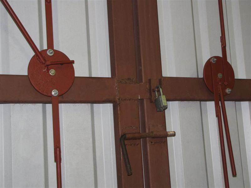

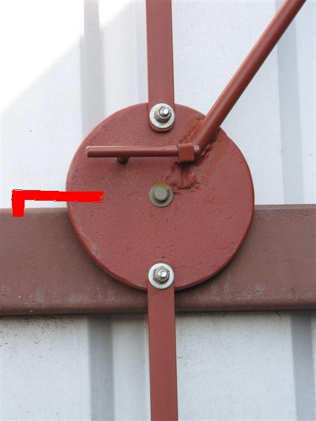

Not sure if this will work but you decide. I made these door locks for my hanger doors. The doors open as bifold doors and I needed to latch them top and bottom. The first picture shows the latched and locked position. To unlock I remove the pin and to unlatch the doors I rotate the handle. As I rotate the handle the locking rods are pulled out freeing the doors. The second picture shows the open and closed position.
The top rod goes into a welded piece on the door truss. The bottom rod goes into a piece of emt that I put into the concrete.
Adapting for your needs you can drill a hole in one door for a pipe. Run a rod thru and attach rods and rotating latch on the inside. On the outside you can have a handle for opening and also locking. The red drawn in area would be a latch from one door to the other. This way you can open from the inside and outside and lock from the outside if needed. Just an idea.
BTW, don't look too close at my welding. These doors were one of my first welding projects. Yet, they have been up about 12 years.

Very nice! That's pretty much exactly what I'm trying to do. I really need to learn to weld. :)
