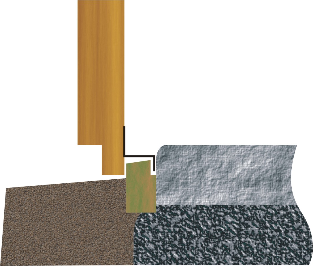

Since your doors are hung from the roller mechanism, you could cut a slit in the slab. Then bolt a piece of flat steel to the back of the door that rides in the "groove". Since it would only be ~1/4" wide, no trip hazards either.
   / Securing the bottom of a pair of sliding barn doors? #32
I haven't looked close at his pix, but I'm guessing that the doors actually hang just outside the slab. I would expect that the framing is even with the edge of the slab. That would be pretty normal for construction. Even so, I imagine we're giving him bits to chew on. Having followed his barn thread, it's obvious the he is very creative and talented.
#33
That's a really good idea - and even easier in my particular case. My slab ends inline with the edge of the posts, but the door hangs 2 1/8" out from there (the thickness of the T1-11 plus a 2x8 header onto which the roller track is bolted), so I need to fill that space at the bottom anyway (I already filled the space on the side). I was planning on ripping a PT 4x4 post down to 2" and bolting that onto the concrete. If I just cut a rabbet along the inner edge, I can make a groove for a steel tab to slide in. Hopefully I can just cut some saw kerfs along the back every foot or so to let the water drain out of the groove.
Thanks for the idea!!

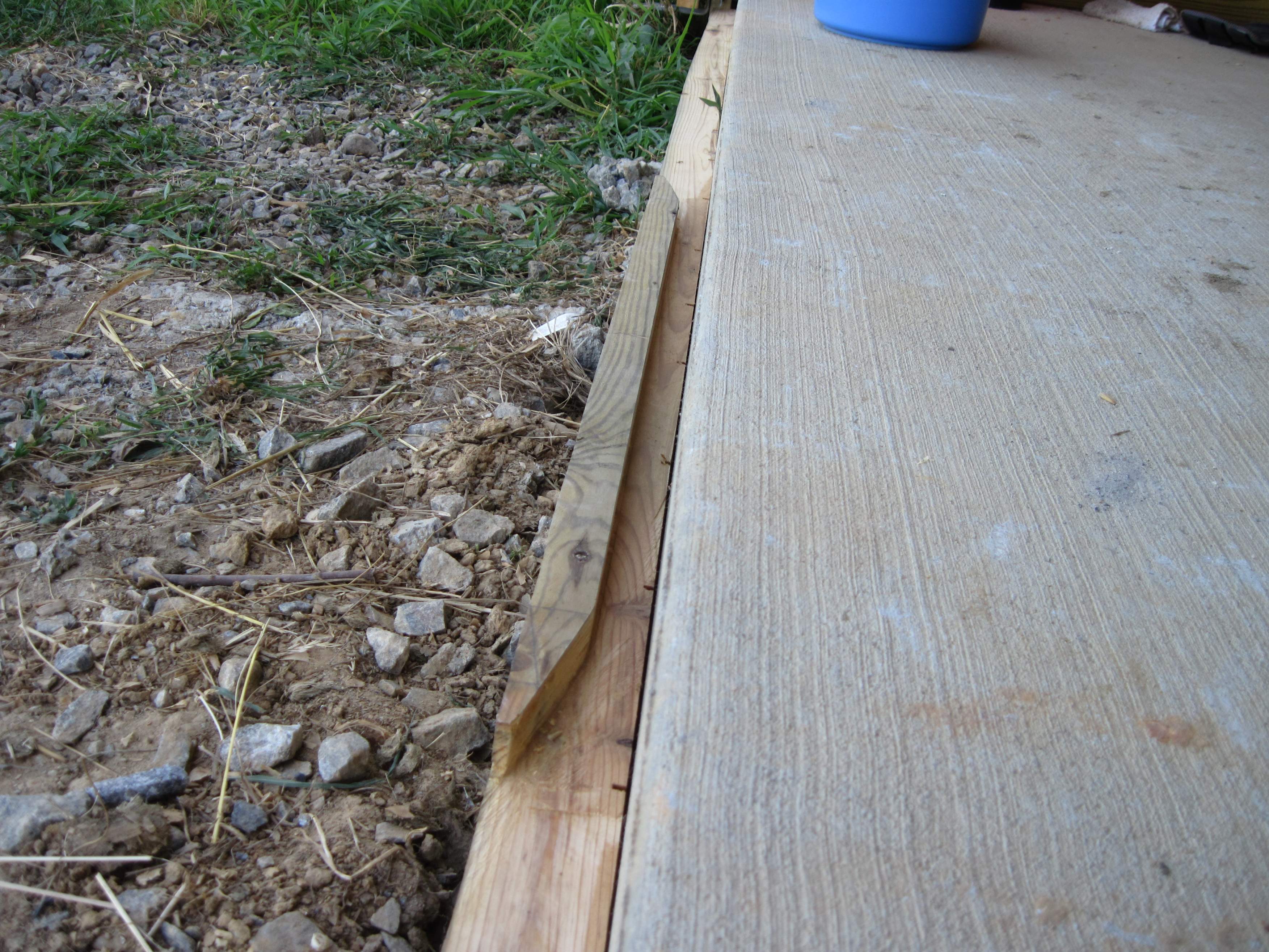

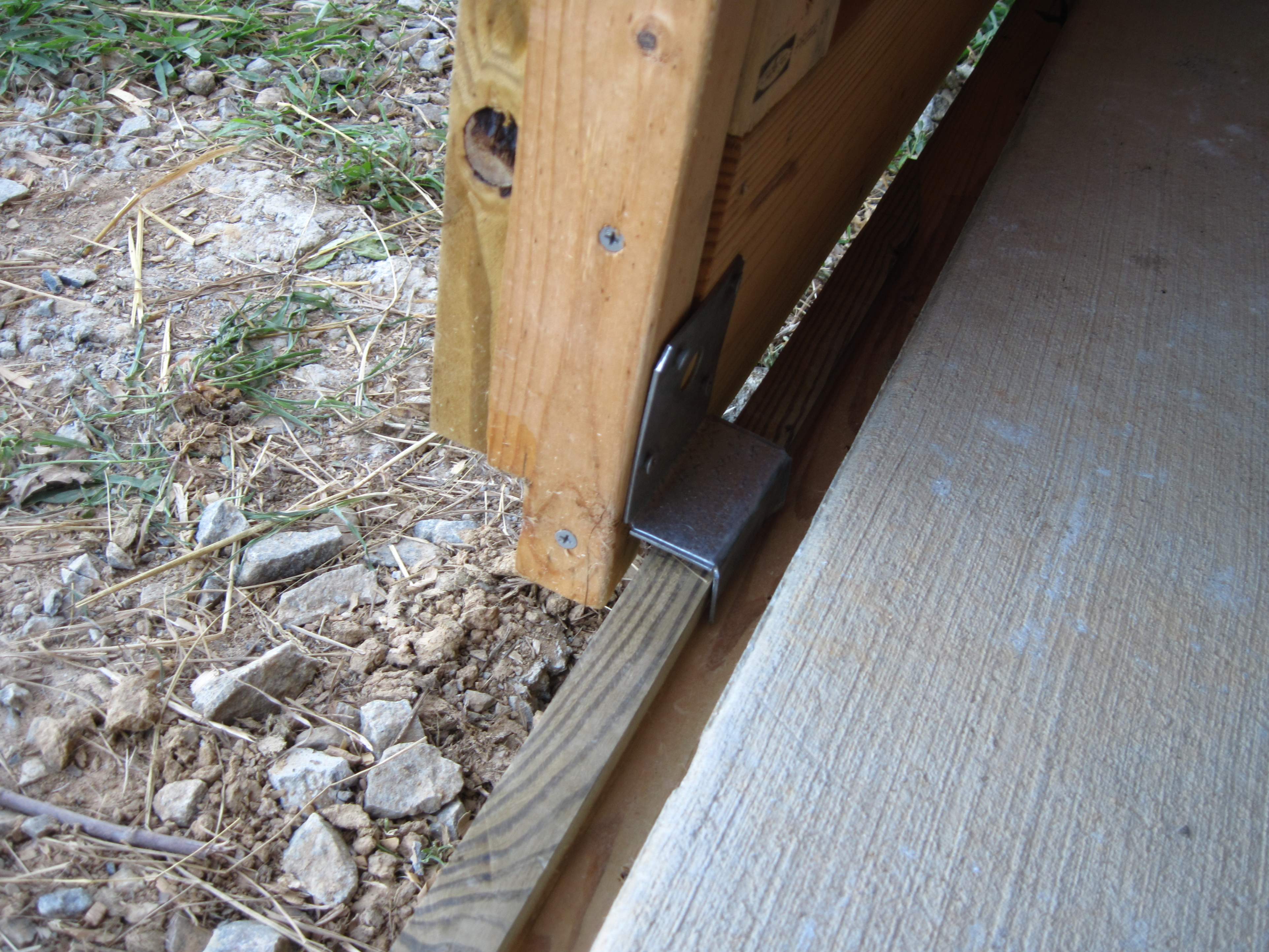

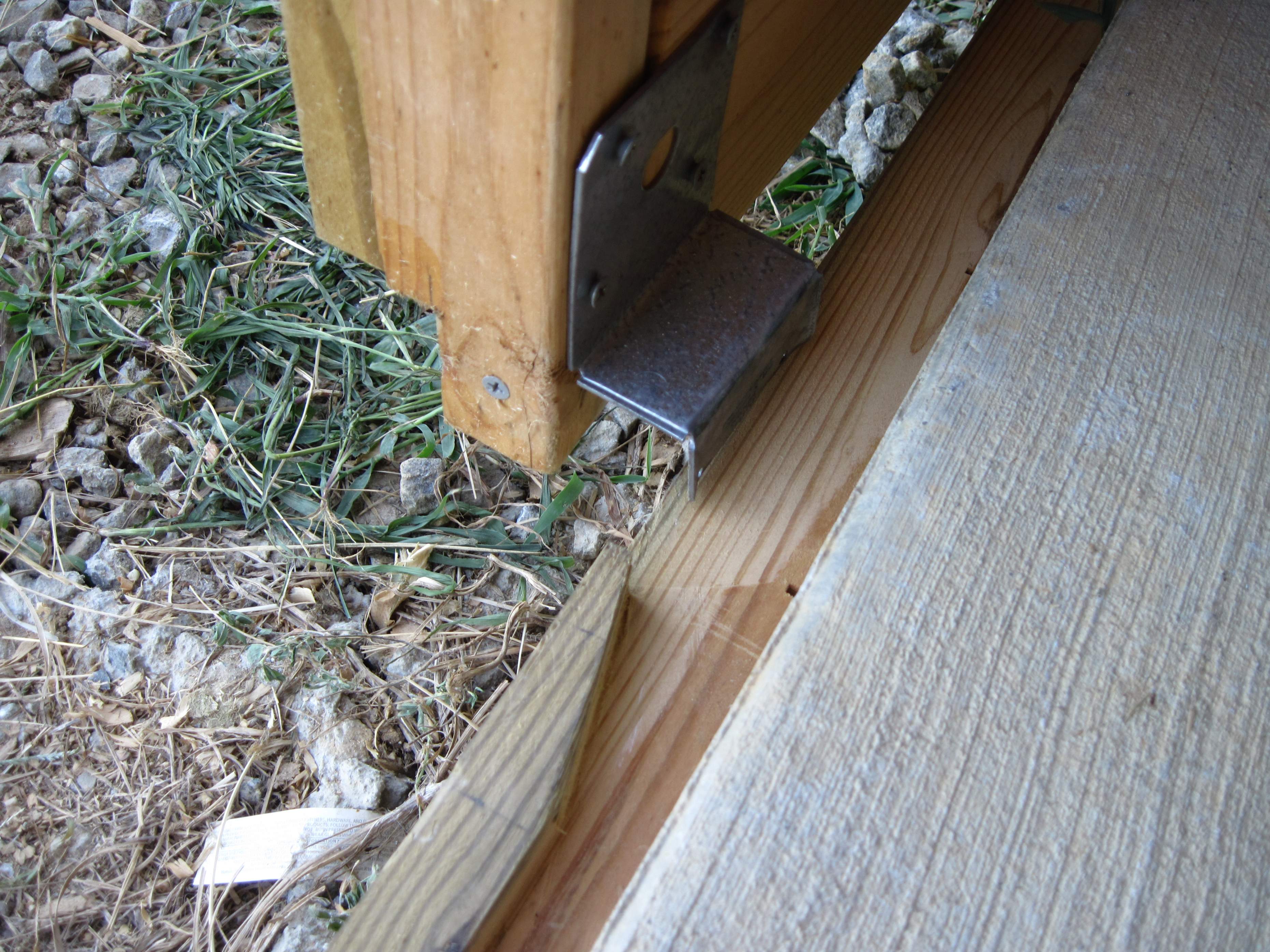

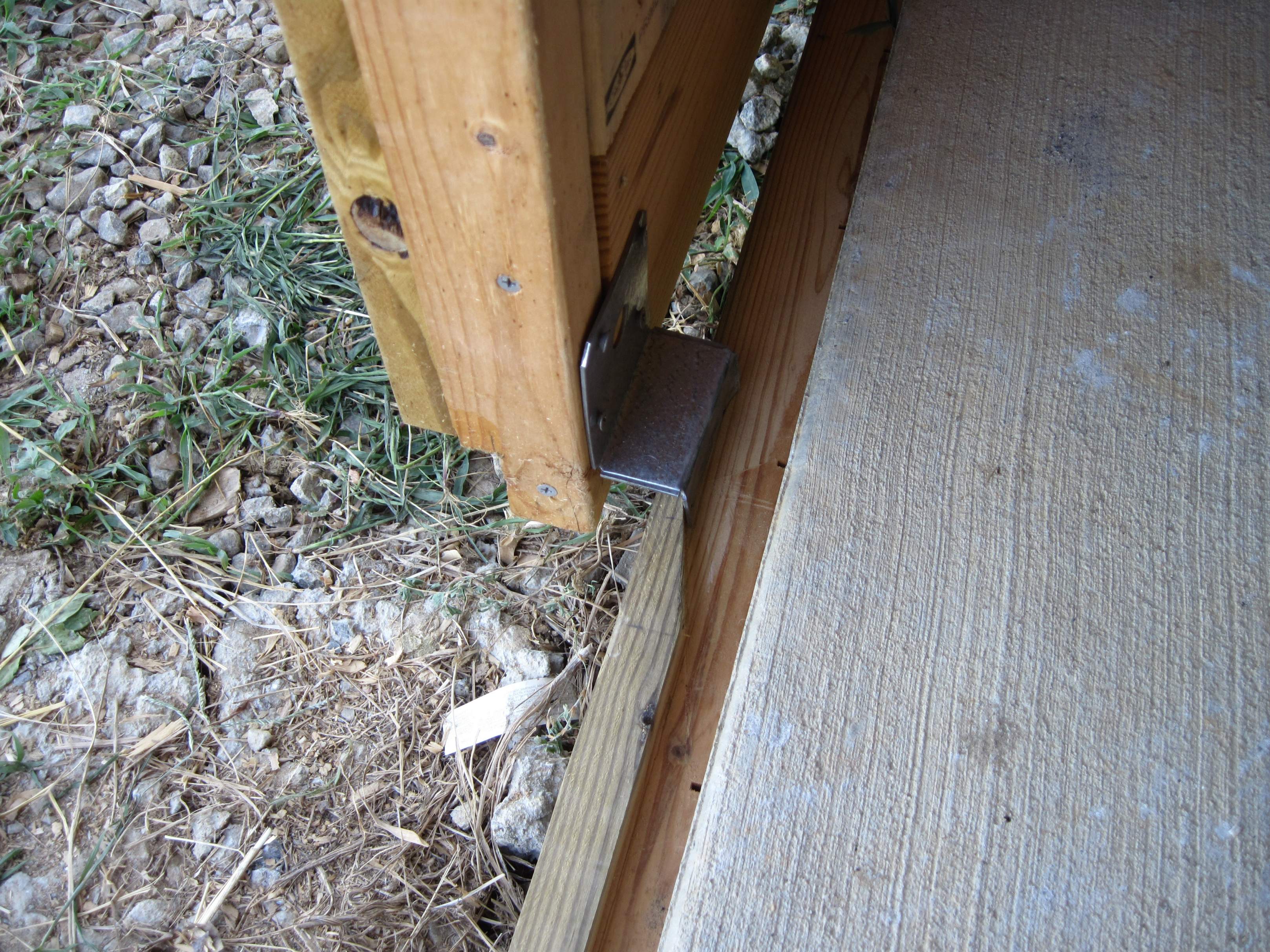

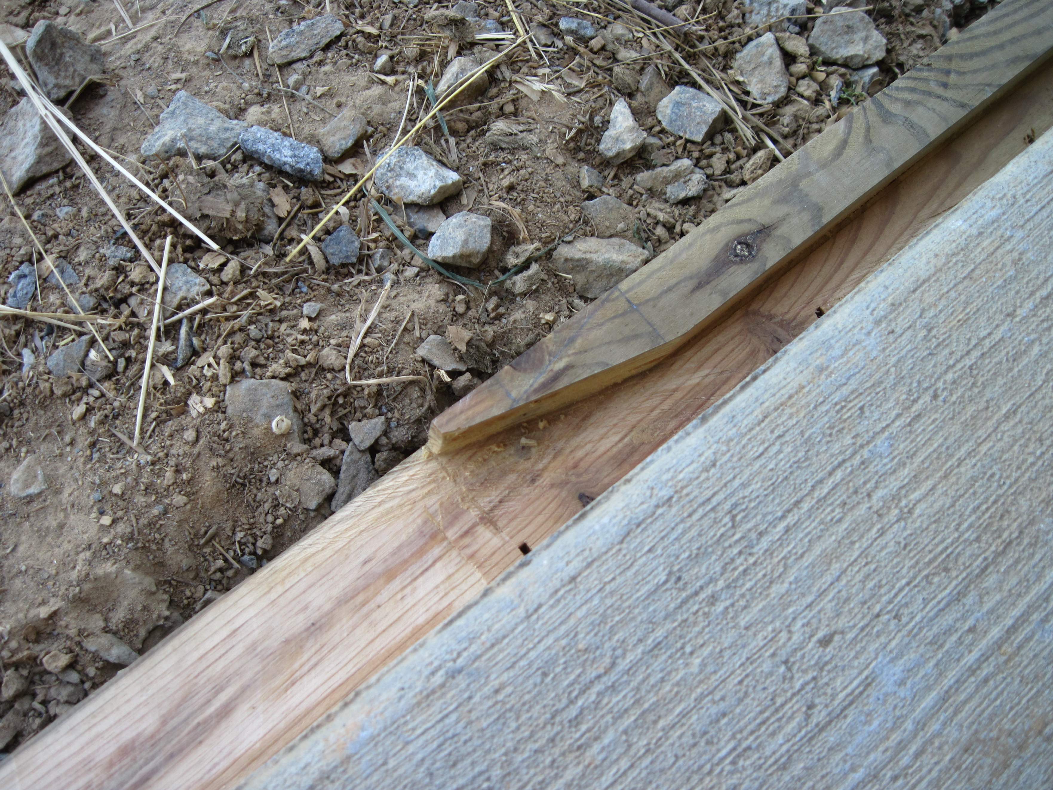

Now that four months have passed, I figured I should probably post an update to this thread.
I did pretty much just what I said I was going to do two posts back (thanks for all the helpful suggestions getting me to that point). After three months of use, I have to say I'm perfectly happy with how it came out.
For the metal brackets that ride in the track I used standard Simpson deck joist ties from HD or Lowes. I cut one side short and bent the edges slightly outward. Couldn't be simpler.
Here are some pictures.
