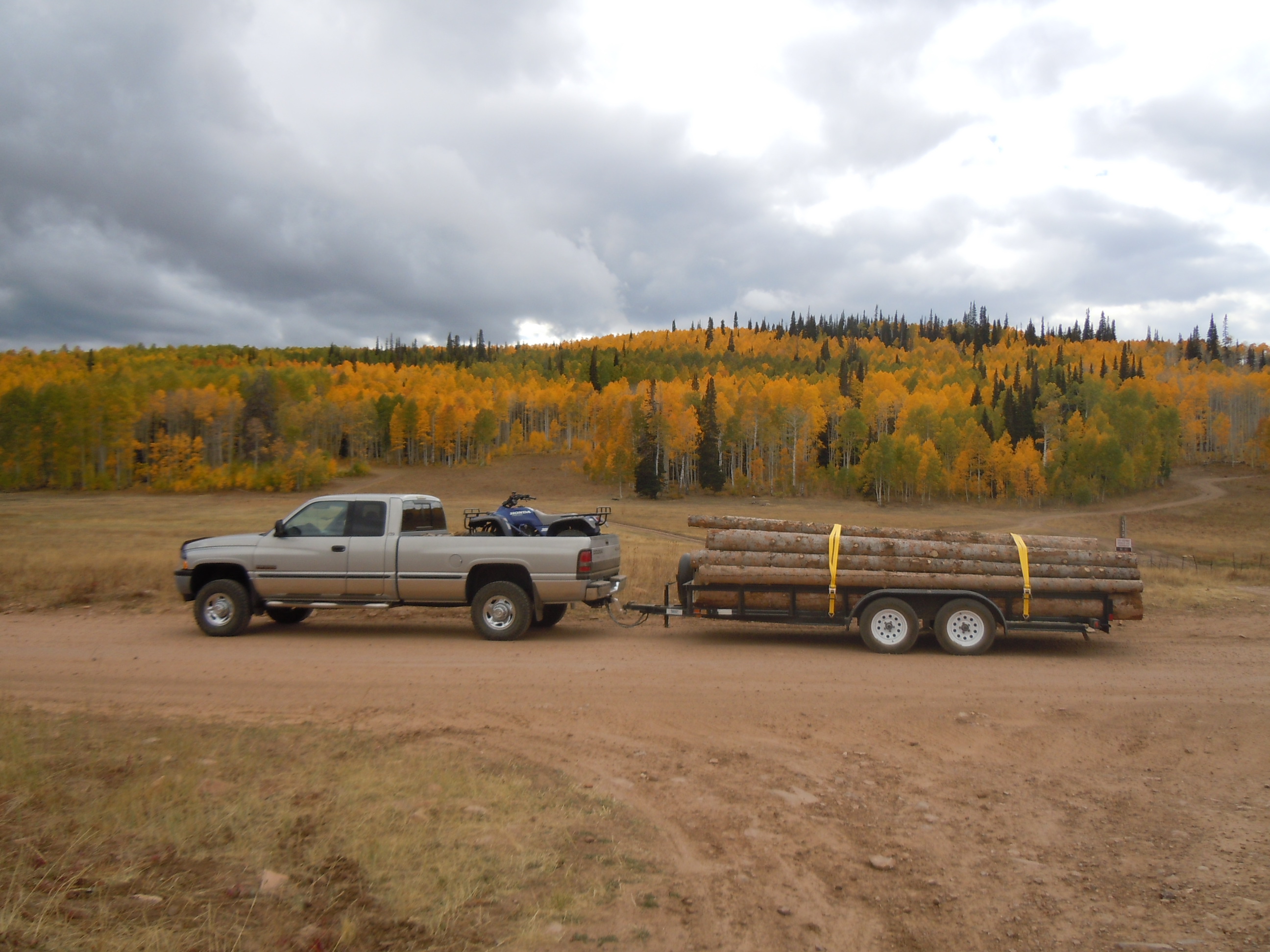

I'm going to put myself in the lucky category; I pull all the time and have never had a problem.
One example of a typical load.
