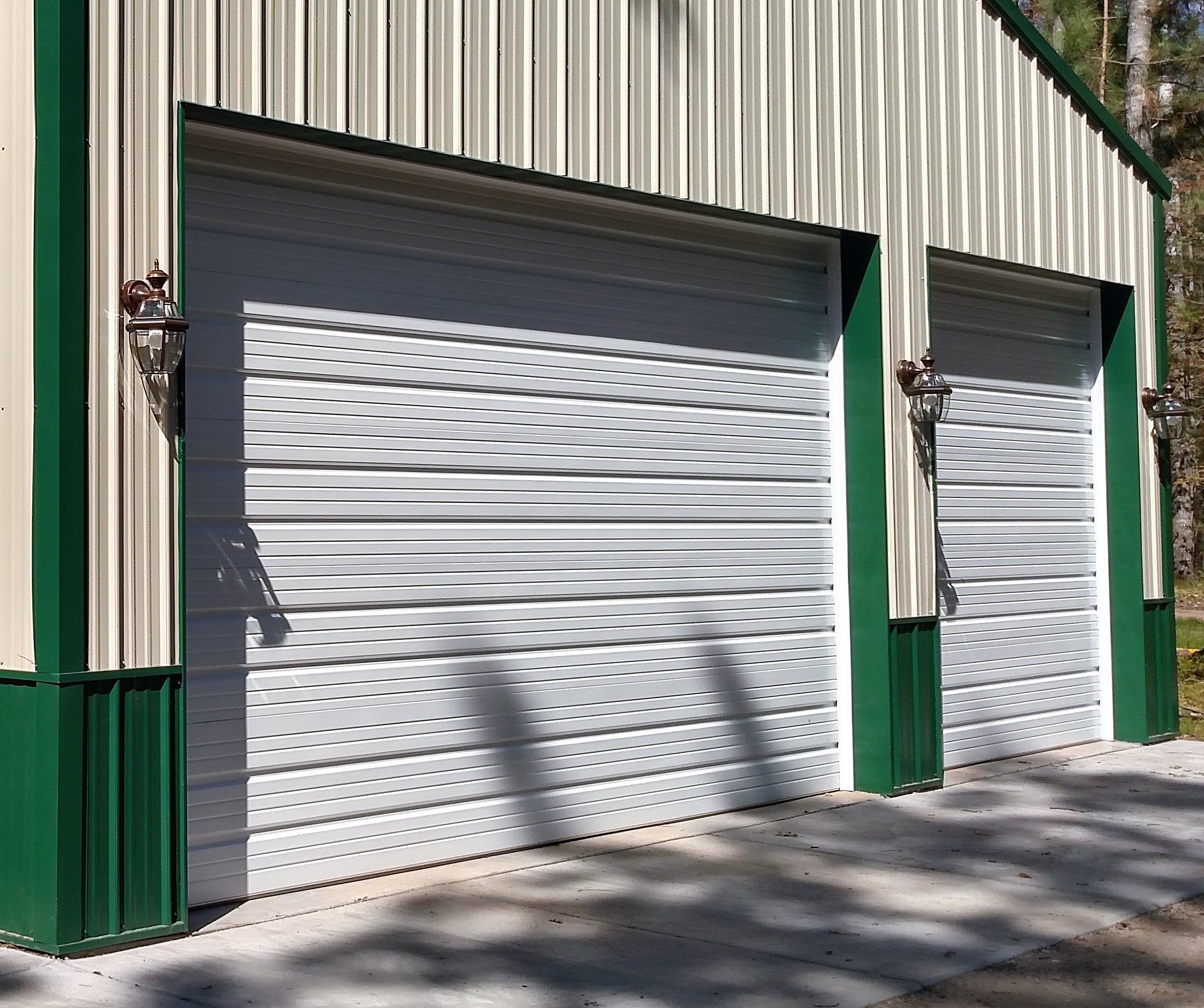

Now I get that they are for outside. I actually put a 2 floodlight motion light on the inside shining up to give basic illumination until I find the light switch. On the outside, I have 3 motion detecting coach lights on either side of my garage doors, They are dusk to dawn, meaning they are on 50% power for 2-4-6 hours after dusk, and illuminate at full power when motion is detected. I have 75 watt equivalent dimmable LED bulbs in them (100w was too bright). They are nice looking when dim, and illuminate very well when bright. I did not wire them to come on all at once, but there was really no need as they are all on at 50% and trigger well when you are anywhere in the vicinity (just ask the deer!).

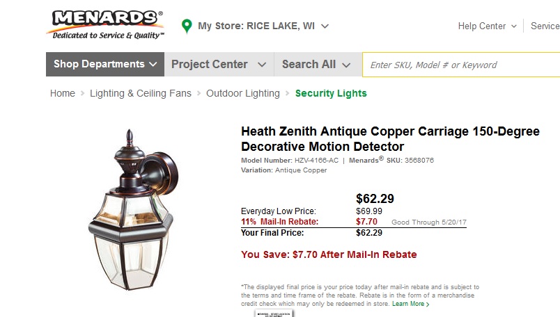

Unless you open the electrical connection to those (not just the three wires pig tails) you won't be able to to have 1 motion sensor trigger all the lights. All the switching is handled internally in each unit. You could get 1 or 2 110v Motion detectors and wire them to control flood lights but depending on your budget I don't know if that route you is what you want to take.
Thanks. That is what I figured and I'm not sure digging into the switch is worth it. I'll just go with the 5 separate lights for now. I had done the separate motion detector that triggered multiple lights in the past and it worked well so I'll keep that in mind.
