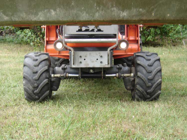

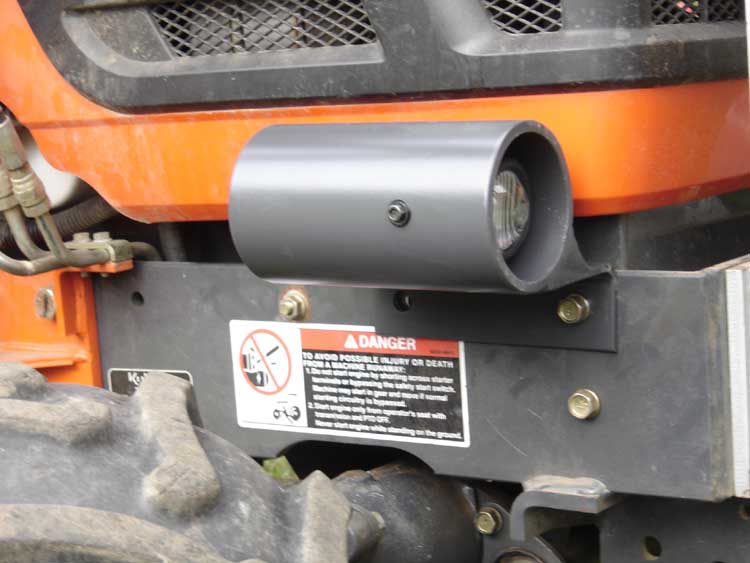

Last year as the days started getting shorter and I was working into the dark many nights I realized that the headlights on my BX23 were pretty much useless in many cases - especially when traveling with the FEL bucket raised - because the bucket blocked the headlights.
So I experimented a bit trying to figure out the best way to mount some lights on the tractor that would allow me to see where I was going when I was carrying a load or traveling with the FEL bucket raised at a good height for travel ( IE just high enough so that it did not dig into the ground). I thought about mounting some lights high on the ROPS but after I experimented with that a little decided that I did not like the lights shining right behind my head and they also tended to attract bugs around my head too. So I decided that the lights needed to mounted low on the front of the tractor where they could shine UNDER the FEL when it was up. I fooled around with a few different ideas because I wanted the lights to"
- not block removal of the cowling
- not get hit by the tires when they are at full lock and at full upwards travel
- be far enough back that I wouldn't break them off driving into a dirt pile
- not interfere with other front mount accessories.
- put off a good amount of light
I ended up settling on some Hella DE projector fog lights which are pretty small and round. Then I got some 1/4 steel tube that the lights would fit into and welded up a 'pod' for the lights to go into. I started this a few months back but just had the chance to finish it up this weekend. I am waiting for it to get dark so I can try them out and see if they work as good as I hope they will.

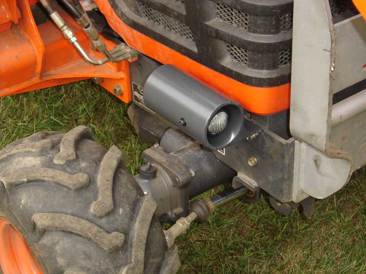

The front tires don't hit at full lock with the axle at the top of it travel...

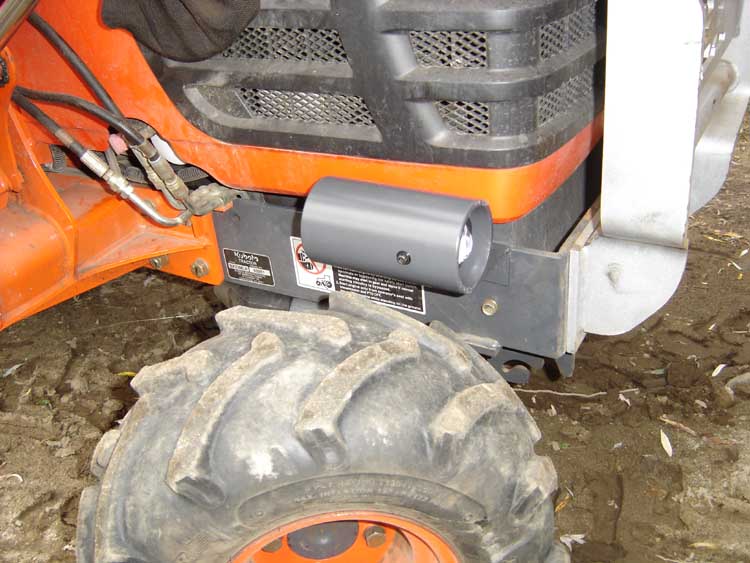

Another view...
   / See under the FEL bucket lights on BX23
Forgot the pic...

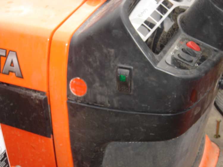

The switch for the lights.

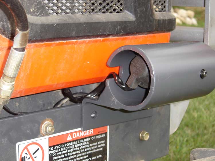

Close up rear view

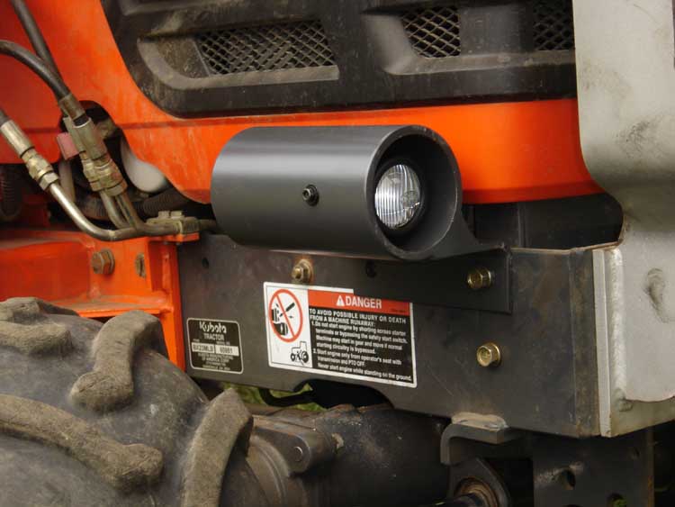

Close up front view.

Another view.

Another close up view.

Looks great. /forums/images/graemlins/cool.gif
Did you lose the rear screw on the housing? /forums/images/graemlins/wink.gif
