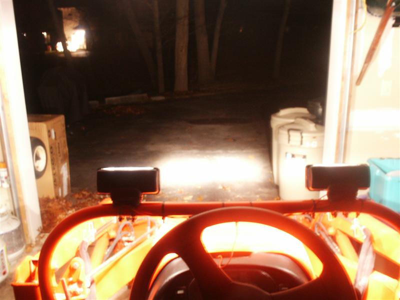

Just finished putting these on. Thought you might like another perspective. My problem was the tractor lights are blocked by the FEL when down. Work fine when it's up. I wanted light shining over top of the bucket. BTW, Simplicity Legacy XL. Mounted them on the crossbar of the FEL. And I was asked before...the bar is stionary so doen't change the angle when the bucket is raised or lowered,

And another from the front.

I originally thought of putting some lights in the same location that you put yours - the problem with my BX23 is there is no crossbar on the FEL like your tractor has. I thought about building a bar across to mount the lights and then came up with the idea of putting the lights in the pods down low. What I could really use is another set of lights mounted high in the front like they put on the tractors with cabs or FOPS setups. That would mean I would have to build a cage structure on the tractor though - maybe next summer /forums/images/graemlins/grin.gif
