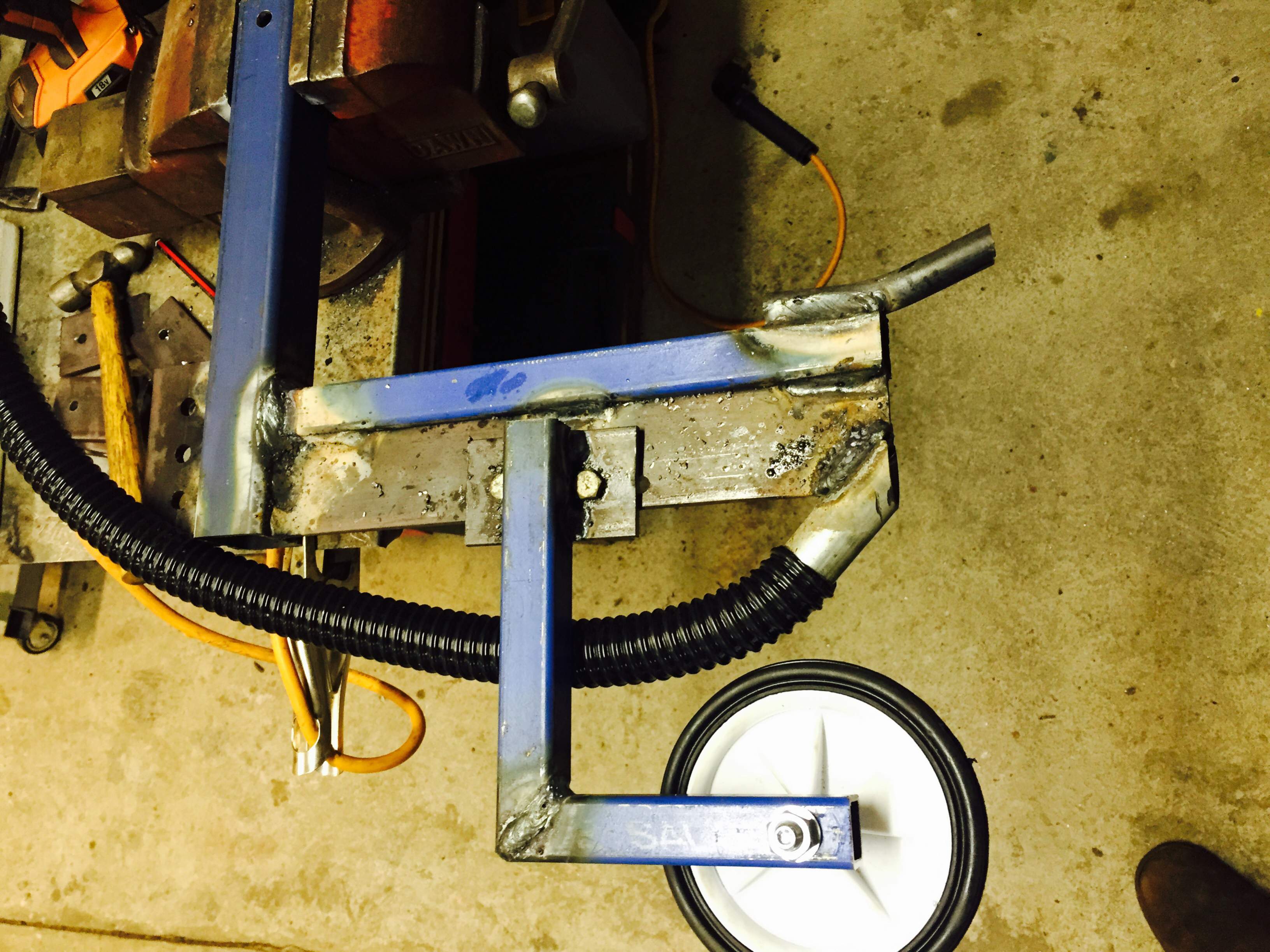

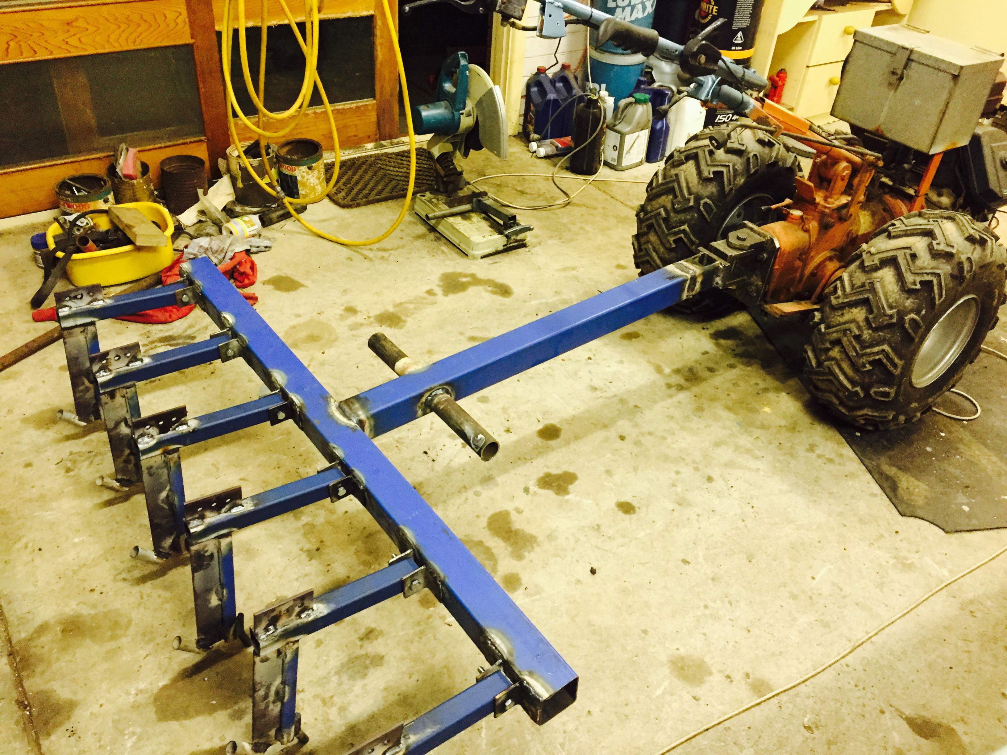

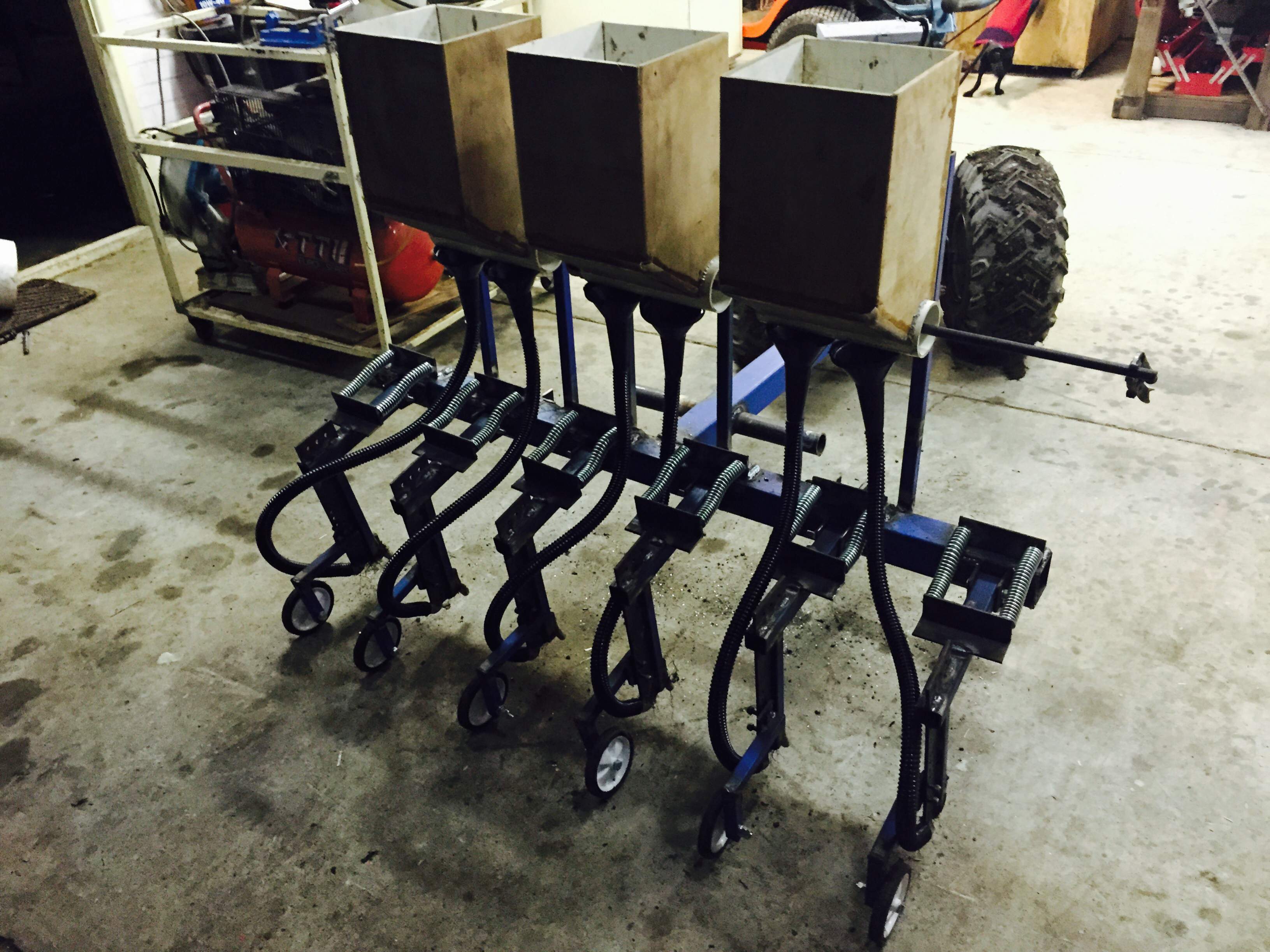

Howdy all, building a seed drill for my Pasquali walk behind tractors.
Independent openers with press wheels, 27 speed gearbox for feed rolls
6 run with 272mm Tyne spacing
Electric raise and lower
/ Seed drill build thread
The seed drop tubes are a vinyl spiral bound hose. I think from memory they are primarily used as a suction pipe for small pumps. The hose I'm using is 25mm or 1 inch in imperial units. It's very flexible and at $5 AUD it's quite cost effective.

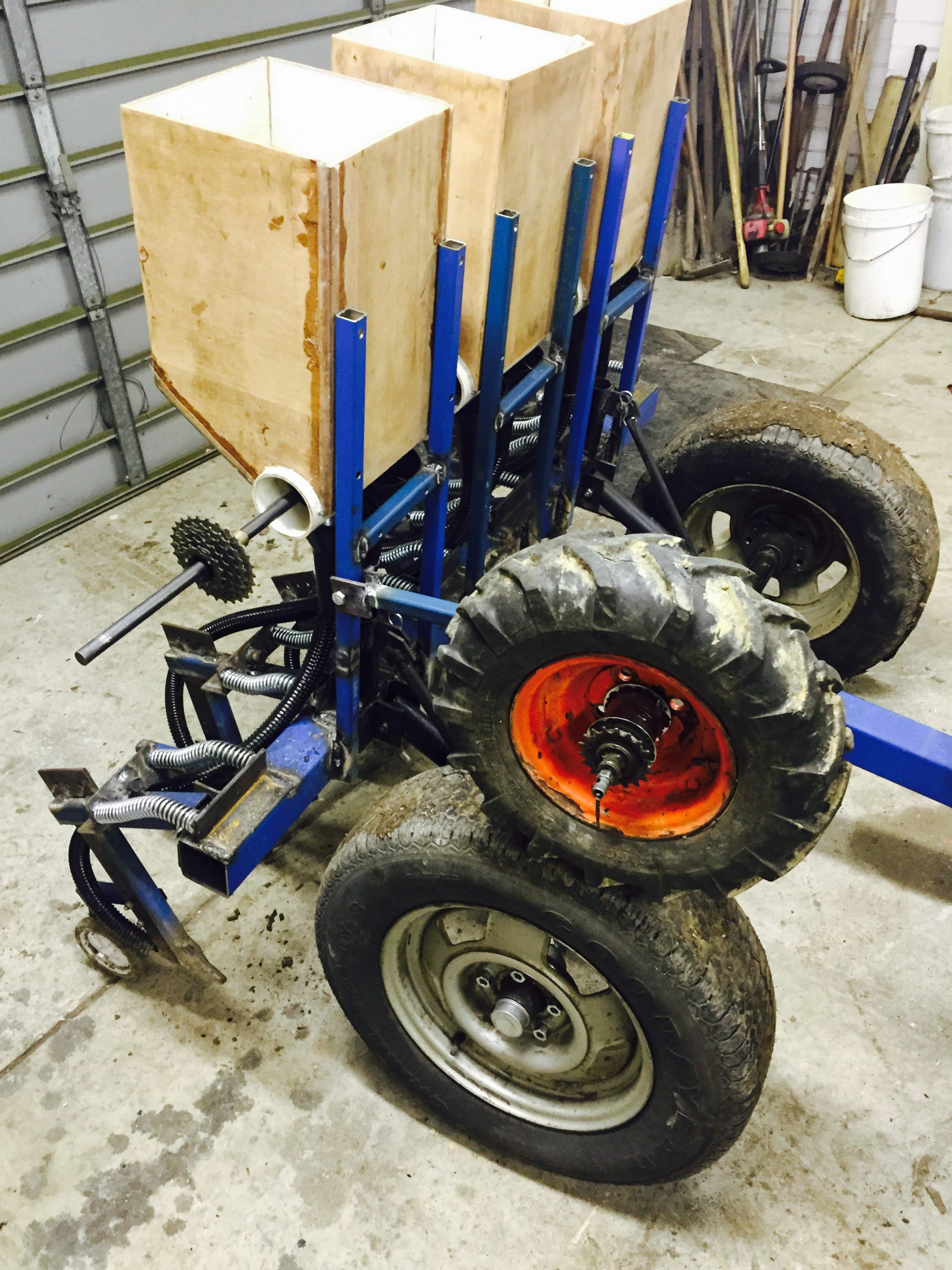

#11
Seed boxes attached now, conducted rip tests yesterday with the machine coming up trumps, now just the metering roller drive and she's ready to get 10acres done asap

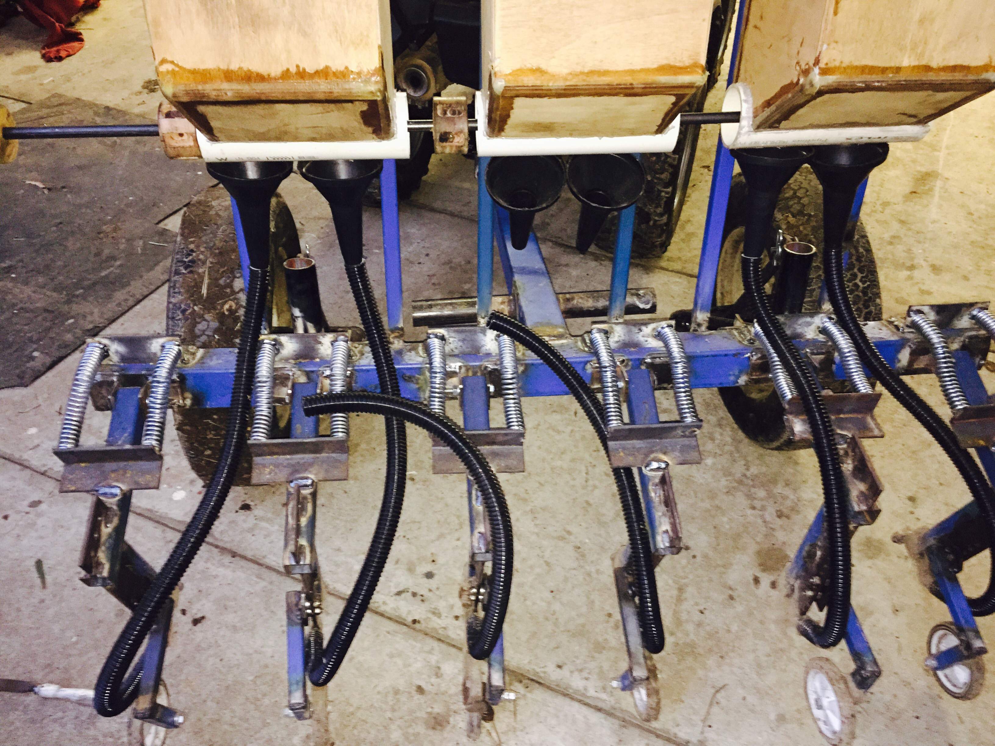

/ Seed drill build thread #12
watching with interest.

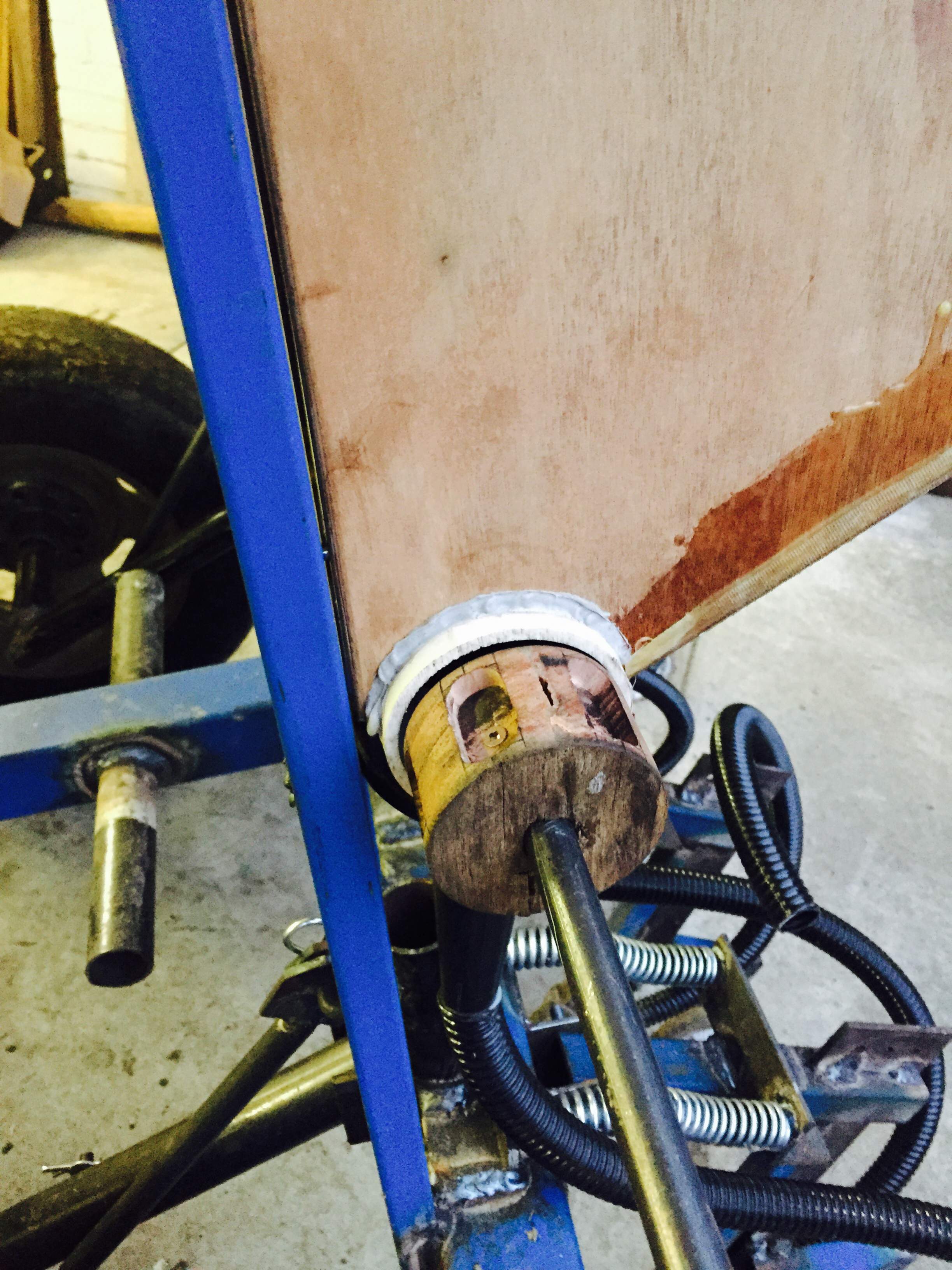

any chance for a couple extra photos of the seed boxes?

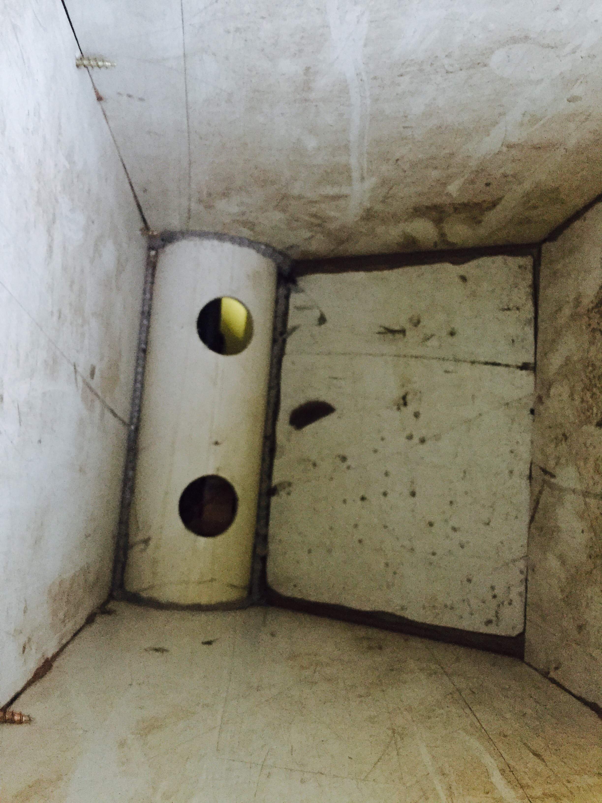

/ Seed drill build thread #14
inside boxes and pipe going through boxes. looks like you are planning some sort of 'auger' to unstick seeds in box and get them to drop down the outlet to each hose?

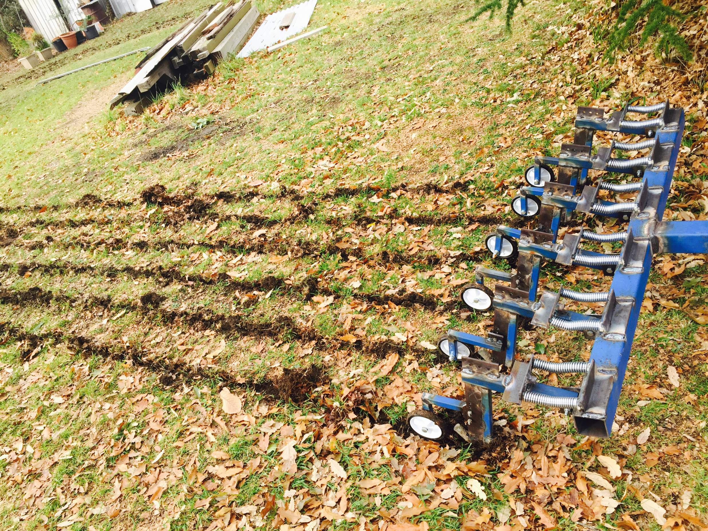

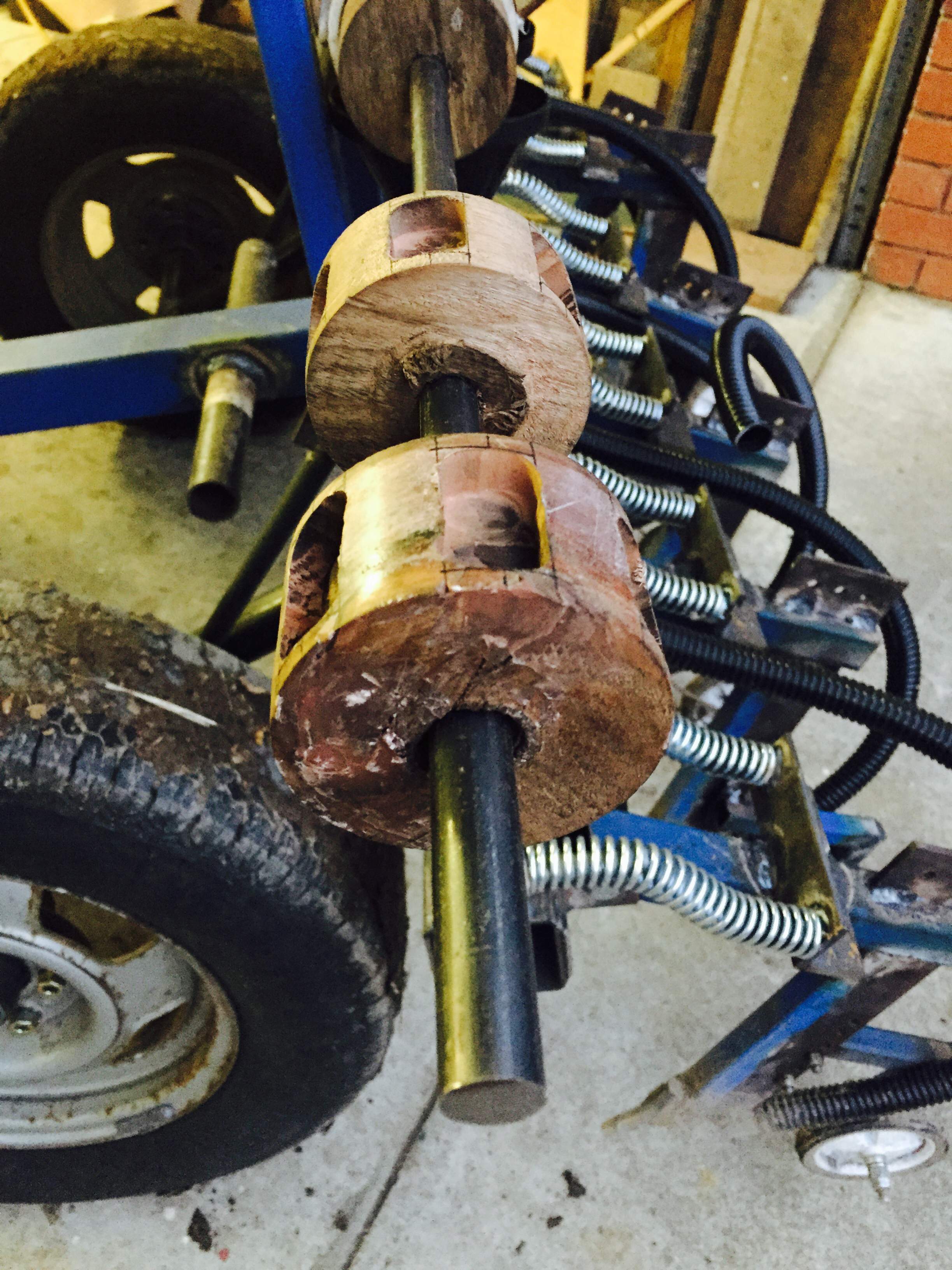

Here are some more pictures getting very close to calibration and running out seed onto paddocks.
Seed metering rollers are made from hard Australian box timber. Slots were milled in with a carbide router bit. Plastic pipe is Australian class 12 high pressure pvc pipe.
Seed boxes are a special high grade quality with a Teflon laminate inside making them completely non stick.

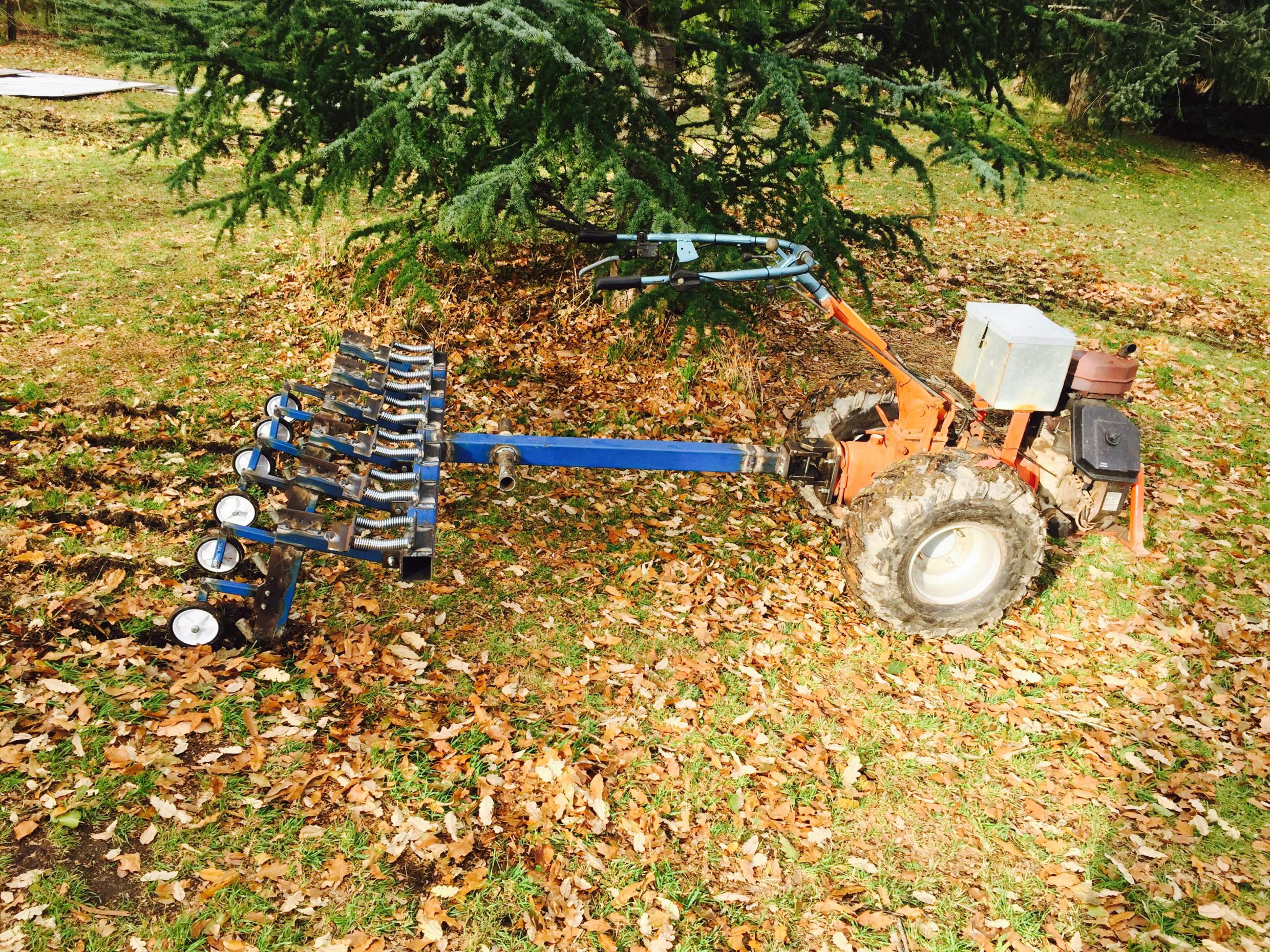

#18
Sown 10 acres with the machine today, did quite well although the Tyne springs are going to be modified to a rubber compression block system as at 10kph behind the bike they are struggling a bit. Seed metering worked perfectly with the rate bang on what I calculated. Hoppers are a bit on the small side for oats, but it's quick to dart across the paddock and refill. 285kg of seed through the machine.
Will keep you posted on some new pasture openers
/ Seed drill build thread #19
awesome! is that a peddle bike gear setup there? so you can adjust rate of seed?
#20
It was originally a bicycle chain setup however that failed completely during the wear in phase, the gears just couldn't handle the torque needed to turn over the rotors, now I'm using a 1/2pitch chain. It's working a dream and just purs along quietly. I am also doing a small seed air powered pasture seeder to mainly do rape seed and fine seeds.
