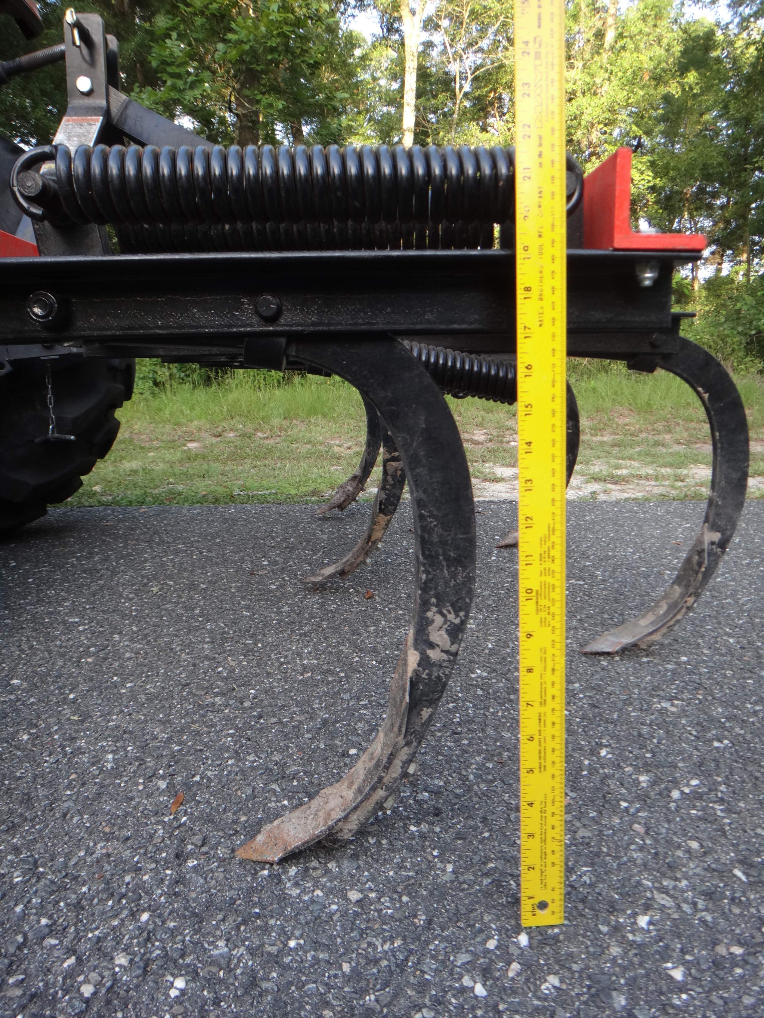

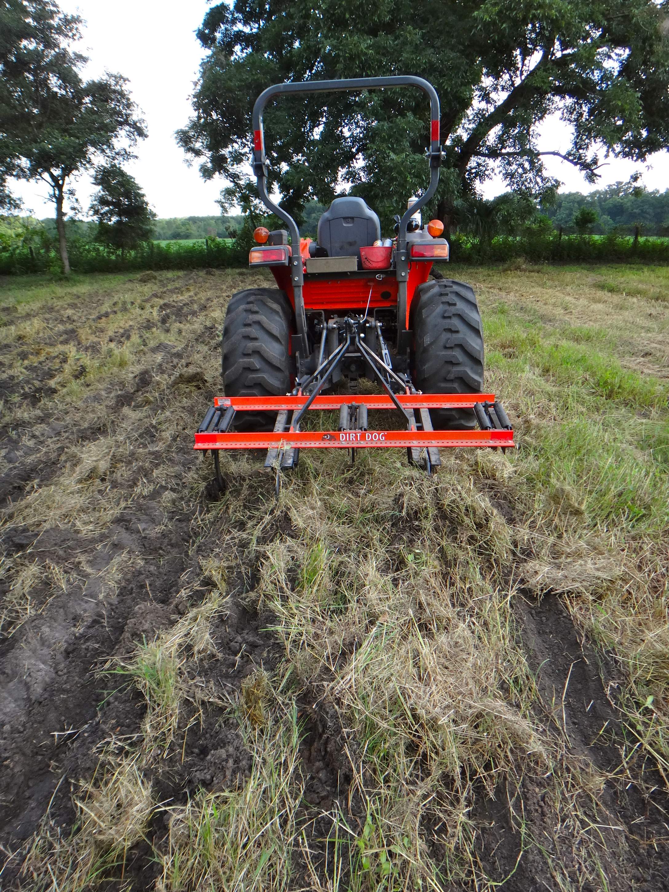

Horses hooves will pack any pasture they are confined in, which will eventually kill the grass.
If the horse pasture is not packed too hard a $900 Field Cultivator will both open ground for seeding and aerate it. Field Cultivators are Secondary Tillage tools. If the pasture is packed really hard a heavier Primary Tillage pasture renovation implement is required.
Dirt Dog makes Field Cultivators with three to fifteen tines.
Pasture grass in photo #1 is Bahia.
LINK: http://www.tractorbynet.com/forums/attachments/339095-dirt-dog-all-purpose-plow.html?highlight=

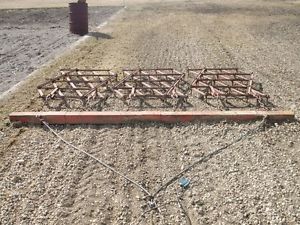

For twelve acres:
After the spraying a couple or three passes with a Harrow (not disk) at different directionsimage.jpeg. Diamond harrows preferably. Then the seeding; perhaps a rotary spreader type. Go with a very light distribution and make passes at different directions. Then harrow again from two different directions and hope for rain that evening.
Mixing pelatized fertilizer or othe granular items with the seed may make the spreading go easier. Depends on the equipment.
[video]http://www.farm-king.com/Region-US/landscaping/drag_harrow/index.php[/video]
The diamond harrow was a very popular piece of farm equipment. Changes in farming methods have resulted in different equipment so perhaps they can be purchased at a very reasonable price.

For twelve acres:
After the spraying a couple or three passes with a Harrow (not disk) at different directionsView attachment 512926. Diamond harrows preferably. Then the seeding; perhaps a rotary spreader type. Go with a very light distribution and make passes at different directions. Then harrow again from two different directions and hope for rain that evening.
Diamond harrow looks similar to what could be used to maintain a horse riding arena, so maybe some double duty there!

Often people will use Loyal Drag Harrow, 8 ft. x 8 ft. - For Life Out Here or similar. I would prefer something more like Spider Rotary Harrow for Horse Arenas by Country MFG. as it gets deeper to deal with the compaction from the weight of the horse.
I am sceptical regarding results possible from Country Mfg. Spider Harrow, based on my experience owning/operating a much heavier Rotary Harrow from King Kutter. KK Rotary Harrow was purchased for smoothing woodland walking trails for senior citizens. I would rate its performance as 'D'. It is gone.
These tools, which are ground powered, are designed to aerate and smooth sand, nothing heavier. In anything but sand, highest hard ground contacts first one tine, then another, so turntable does not revolve, it oscillates, yielding somewhat the effect of a Spike Harrow, but less good.
Rotary Harrows are NOT for relieving soil compaction.

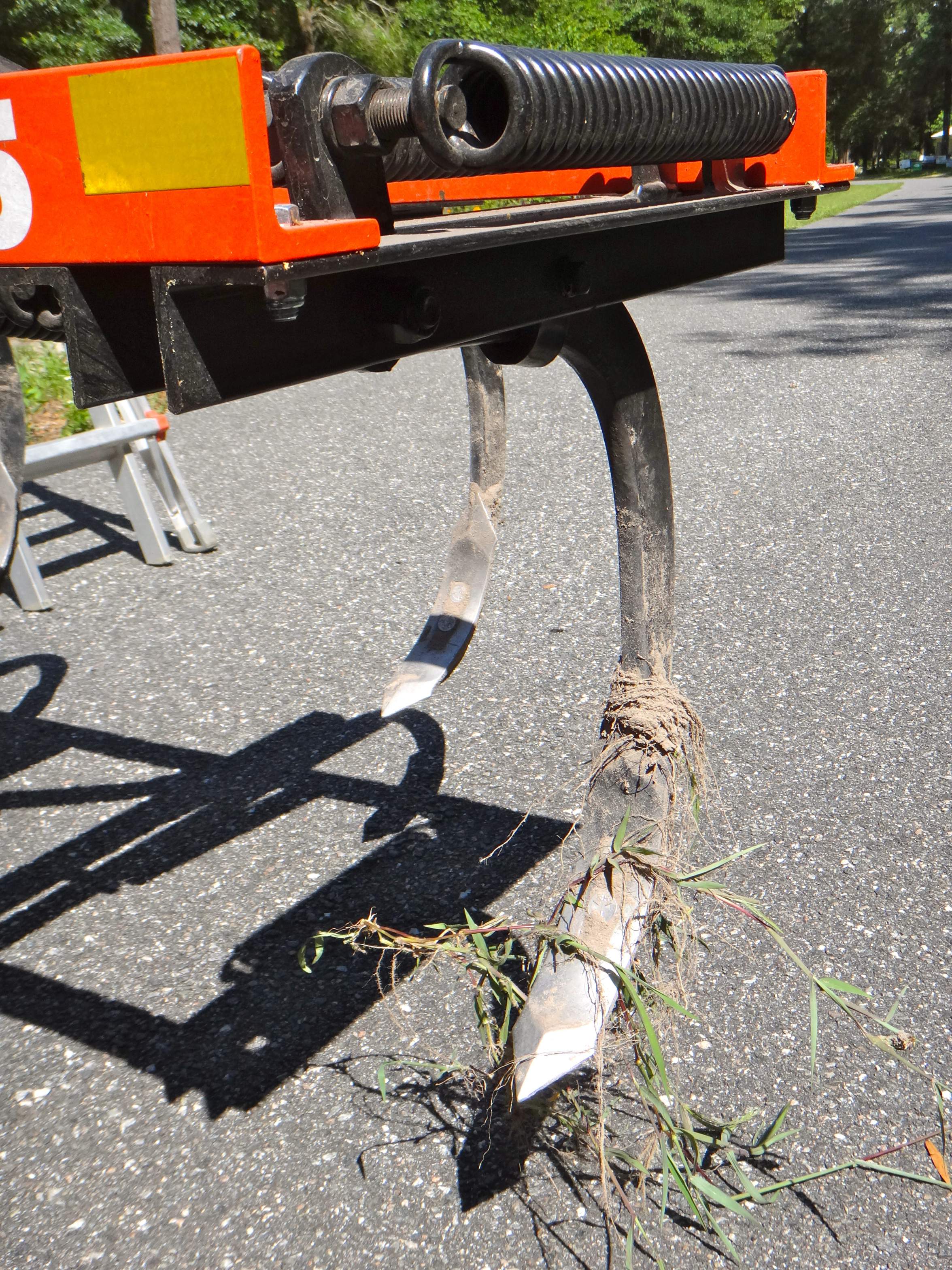

Consider the Field Cultivator, Photos 3 - 4.
