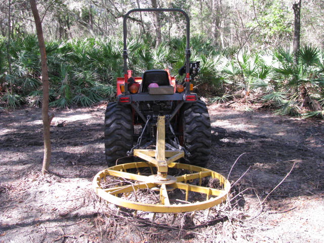

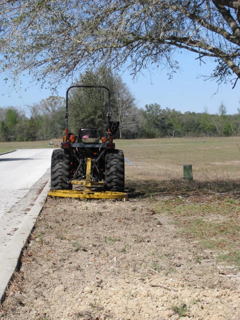

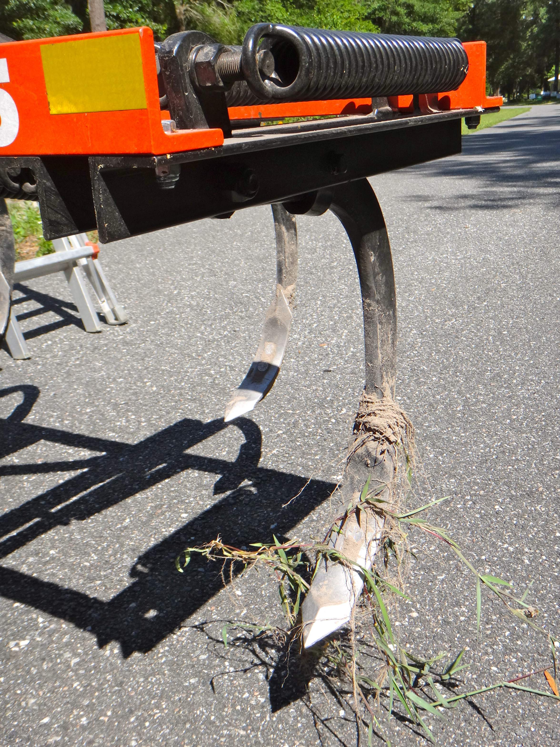

Often people will use Loyal Drag Harrow, 8 ft. x 8 ft. - For Life Out Here or similar. I would prefer something more like Spider Rotary Harrow for Horse Arenas by Country MFG. as it gets deeper to deal with the compaction from the weight of the horse.
I am sceptical regarding results possible from Country Mfg. Spider Harrow, based on my experience owning/operating a much heavier Rotary Harrow from King Kutter. KK Rotary Harrow was purchased for smoothing woodland walking trails for senior citizens. I would rate its performance as 'D'. It is gone.
These tools, which are ground powered, are designed to aerate and smooth sand, nothing heavier. In anything but sand, highest hard ground contacts first one tine, then another, so turntable does not revolve, it oscillates, yielding somewhat the effect of a Spike Harrow, but less good.
Rotary Harrows are NOT for relieving soil compaction.
Consider the Field Cultivator, Photos 3 - 4.
