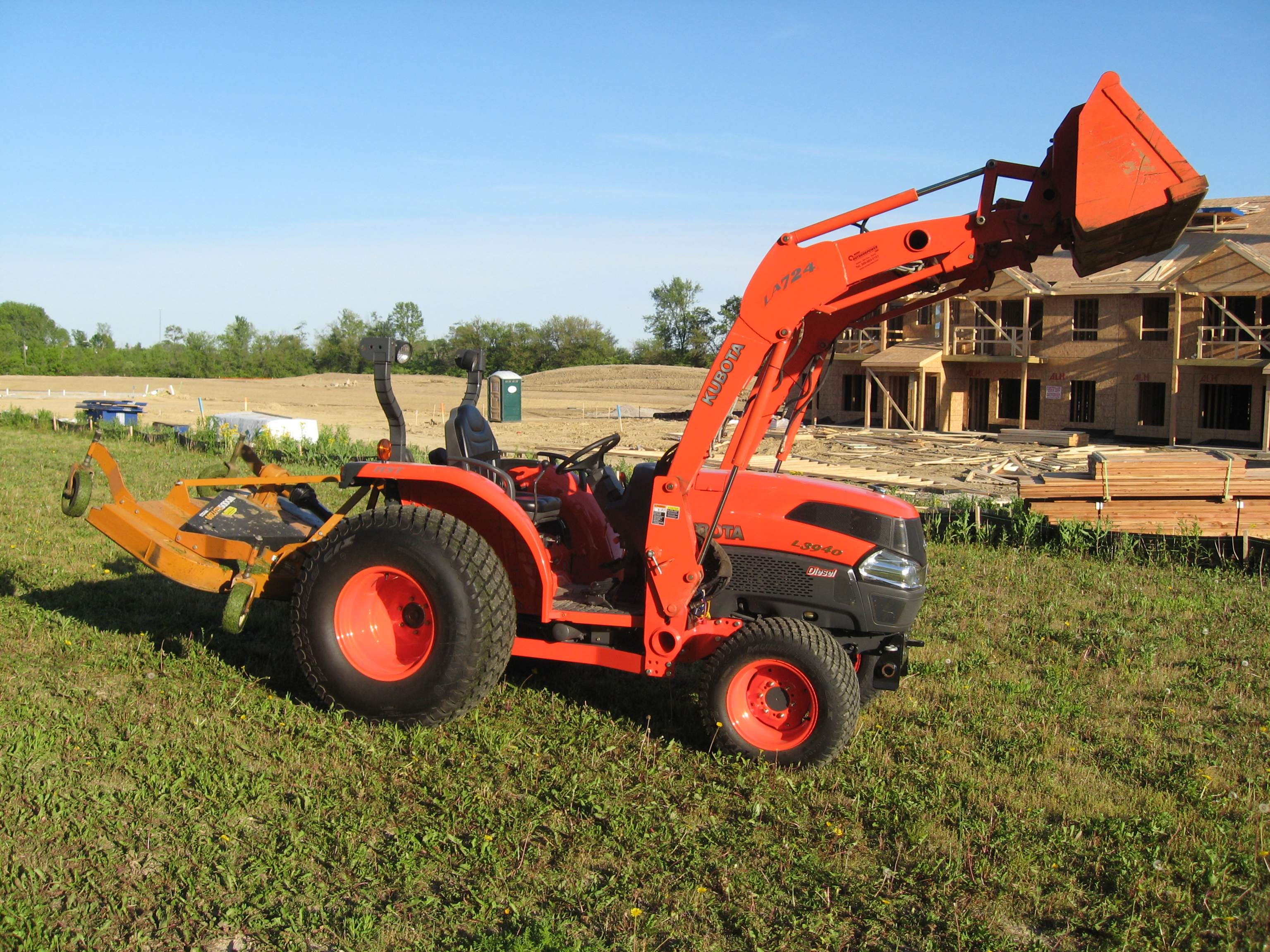

   / Seeking advice from experienced Grand L operators/owners #4
The cab sure does run up the cost of the tractor! I have picked up some some rocks, largest was probably 4' across x 2' x 2'. I think it would be harder to get anything larger in the bucket. I use my tractor mainly to mow 2.5 acres and move snow on a long driveway. My only advise is to make sure the 3240 has the grunt for the type of snow in your area to properly operate the snow blower. My choice would be the 4240, not much difference in physical size. Philip.

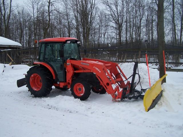

I owned a L3130 HST(compares to L3240) for a couple years,nice tractor but I traded it for L4240HSTC with the 854 loader;;this thing is a beast.Very capable tractor,I snow plow,box-blade,roto-till ect.,have a thumb on the bucket and tooth bar.Cab is great summer and winter.

The main difference between the L3130 and L4240 besides horsepower is weight and physical size.My L3130 had a six foot sub-frame mounted snow plow,the L4240 has a eight foot FEL mounted snow plow.Much heavier at 6500lbs vs maybe 5000lbs.If used in tight quarters the smaller machine is better suited.
My experience; the L3130 when worked hard used one gallon of fuel per hr,the L4240 about one and a quarter gal.per hour.
I kept all my old implements and use them on the new tractor
roto-tiller ,two bottom plow,cultivator,back blade,box-blade ect.,the larger tractor does better with the box-blade.
The main reason I traded was for the CAB,up-graded in size,but would have been happy with a L3240-L3940 HSTC.
In the end I am glad I puchased the L4240,mostly for FEL capacity,just feels saver for what we do.
