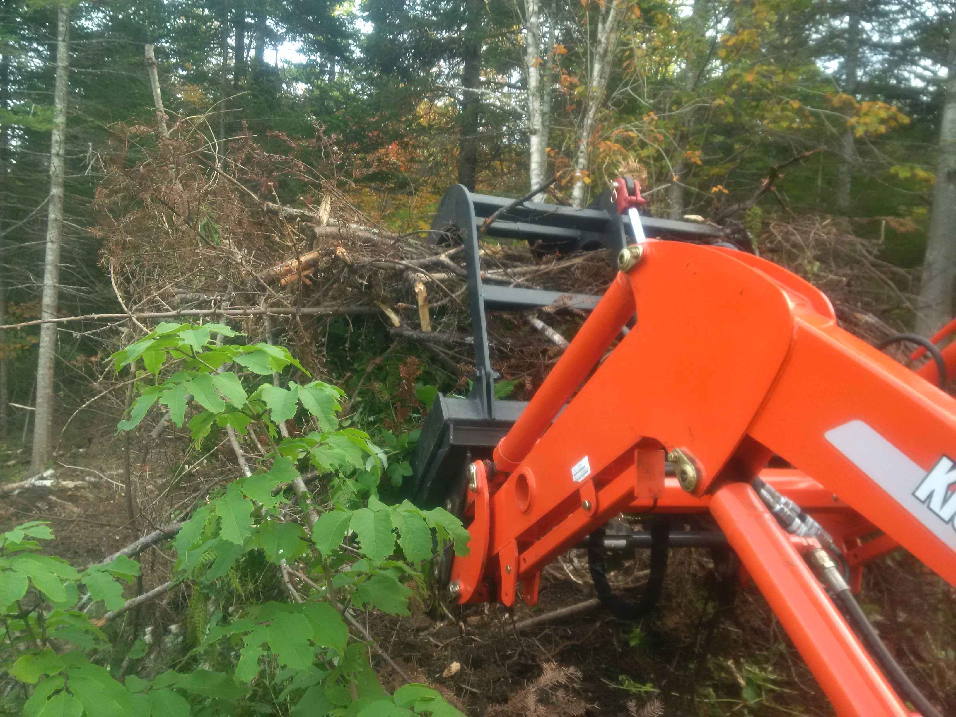

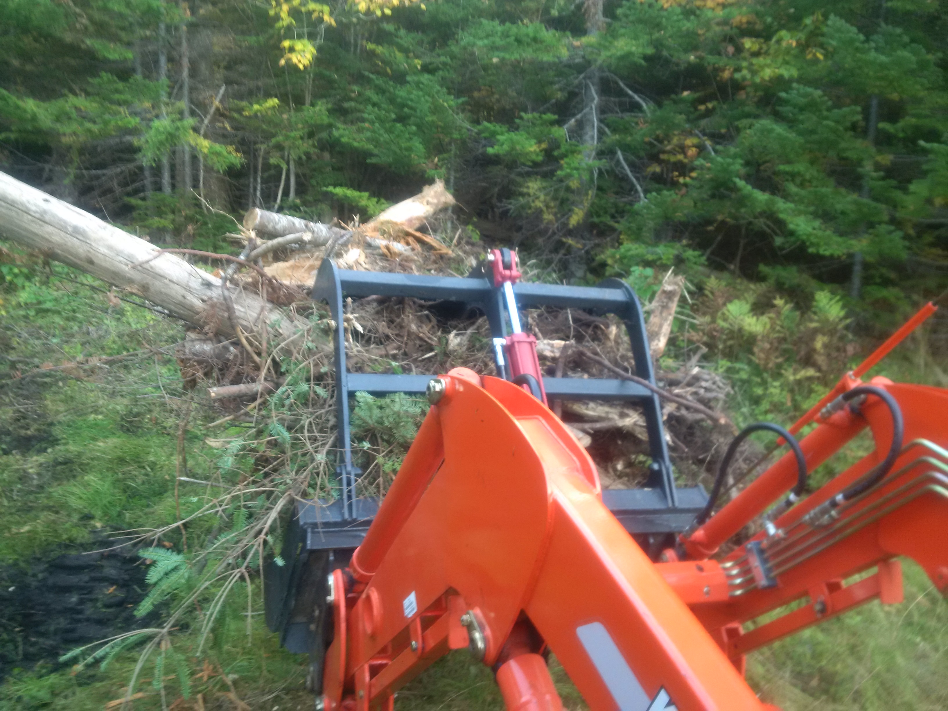

That is the size that I am looking for my CK30. I have one question about the hydraulic hoses on this grapple. Looks like you had to install 2 outlets to accommodate this grapple for opening and closing. Can you show me pics of where those lines go and what had to be added to the joystick for operating this grapple. The reason I ask is what I have to do to accommodate my CK to a grapple. Did the original skid steer quick attach work on this grapple or did you have to modify it. Thanks for any info.
Gilles
Hey Gilles,
As you have already been told - there are 3 basic choices Rear Remotes, Diverter, and 3rd Function. The Pros/Cons of each of these has been discussed in the forums at great detail and you are free to pick which works best for you.
I opted for 3rd function because it felt the most "natural" and easiest to operate. There are pre-made kits to add a 3rd function to your tractor (WR Long being the most popular and the one EA sells). Again I opted to take the "hard way" and build my own set-up. It's actually not that difficult to install, the majority of my issues were in the design/engineering phase.
I have a write-up of my project here - there are also a couple updates thru the thread so everything is not in the initial post.
http://www.tractorbynet.com/forums/customization/358086-kioti-ck-35-3rd-function.html
If you decide to tackle this yourself, there are many many knowledgeable people here that can help you out and answer questions for you.
Best of luck whatever you decide.

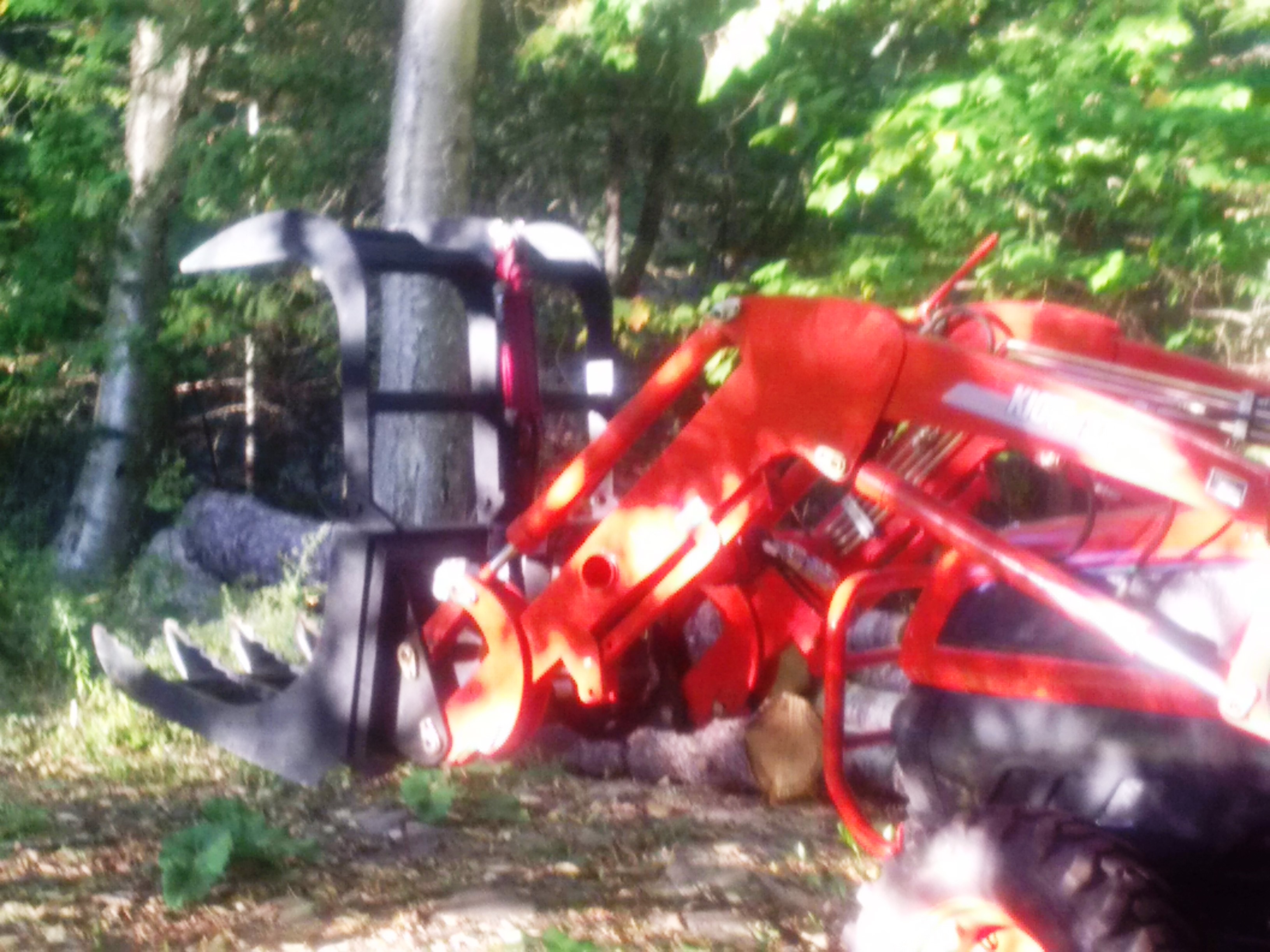

Ritcheyvs, I also have a DK45 and just got this grapple. I like the size and delivered price.
48" Single Cylinder Root Grapple Bucket Attachment — Skid Steer Attachment Depot
