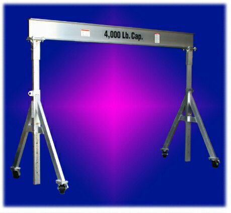

How about make a gantry crane but with turf tires and pulley? You could easily lift them and roll around the yard easily placing the stones where you want and safely. You could tow it with your tlb.
At 1278lb you could build one from 2x10s and it would hold. A 12v winch would lift and lower in place.
While a cool idea, the lifting of the blocks isn't too much of a problem the jd 110 can easily lift the load its grabbing the block without damaging it quickly and safely is the part I am figuring out.
