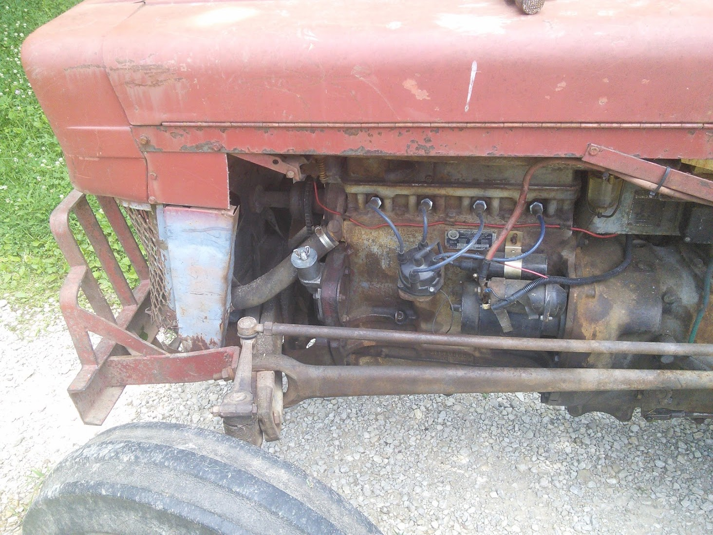

I retired to 45 acres in northeastern Kentucky and need to keep about 4-6 bush hogged and to maintain .78 miles of dirt/gravel road from the nearest public road. It's hilly. Very. I have a bush hog and box blade I have learned to use with my 1965 MF135 Gas Tractor after I learned to drive it. I would not mind adding an auger later.... but... We live 27 minutes from the nearest gas station as a point of reference. I don't need it to make money, just to not have to pay others as I have a limited budget. I have put this off because of this bug thing, but with the vaxx in me, I cannot delay it any longer.
The MF135 was in the barn with the place. It needs rear tires (12.4 x 28's right now but one has fist sized holes and the other is really dry rotted) and the brakes are going. I've jury rigged the electrical and it runs (as you can see in pics). I don't have the correct tools to change the tires, and am an old soldier with some uncooperative less-than-original body parts for brute forcing it.
SO, I am left with (as far as I can tell)
- buying a trailer to transport it (which isn't great, but I could use it for other stuff) and then
shopping around to find a place to get the tires changes (after I drop a fair chunk of cash to buy tires) and having them check the brakes since I already went thru all that hassle/cost
Dealing with the fact that while it is within 4 years of my age, and while the simple is nice, it is a real bear to drive without at least 1 good knee
- Finding someone who will onsite do the tire change (and maybe following a youtube vid for the brakes myself, but we have HILLS and I would like to know what right feels like for a point of reference) and paying for tires/services
- Taking the money I would have spent on the above plus another 2k and picking up some decently maintained tractor nearby that has no current needs and is already in decent shape. Maybe selling the MF to someone who wants to play with it to get some cash back.
Any recommendations?

I think you're saying the tractor is adequate other than tires and brakes. You will not find a "decently maintained" tractor for anything approaching what you'll put into tires and brakes. I would break the lugs loose on the wheels then jack the rear of the tractor, putting it on blocks with the rear wheels off the ground. Removing the tires and wheels becomes simple at that point, though they are HEAVY. Put them on a low trailer or into your pickup and take them to the dealer to have the tires replaced. They can then be reinstalled onto the tractor. While the tires are off is an excellent time to pursue the brakes. I know nothing about your clutch, engine, or anything else but for me the tires and brakes would not be a deal breaker. It should be a fine old tractor if you don't need a front loader.

This makes sense, I went out after I saw this and did some heavy penetrating oil on them, I may be able to apply a big enough lever to try this route. I had given them some tentative tries before I decide to make my post and they may have been on there 20-30 years! Thanks.
