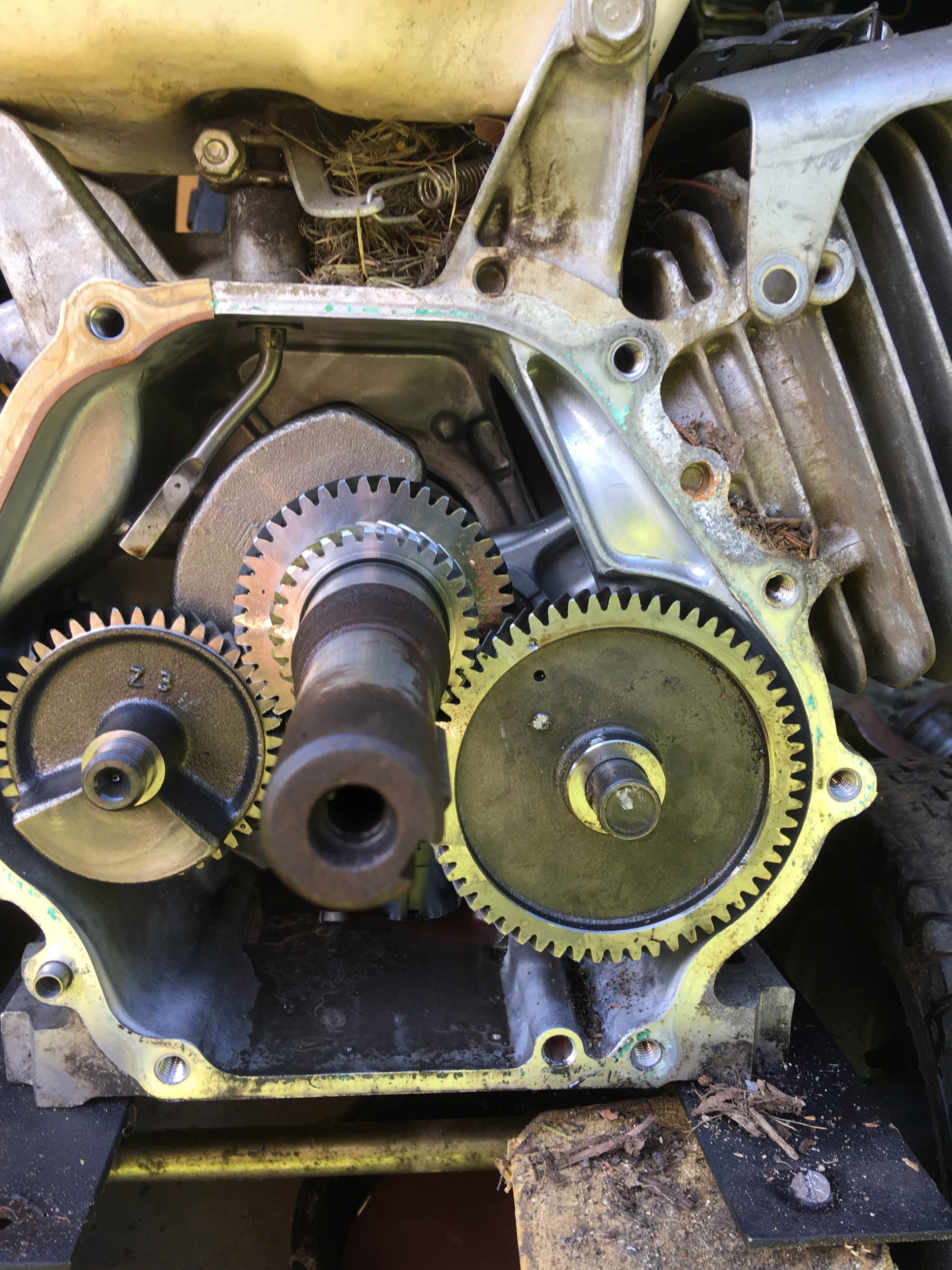

Guys-thank you all for comments. Pulled the front case off. Everything looks good. No parts in bottom of pan. I pulled camshaft, looks new. Tappets dropped down so nothing frozen. When I first got this treasure-remember it was out on road with a "free sign"- guy in neigborhood died and his kids came to clean out house.

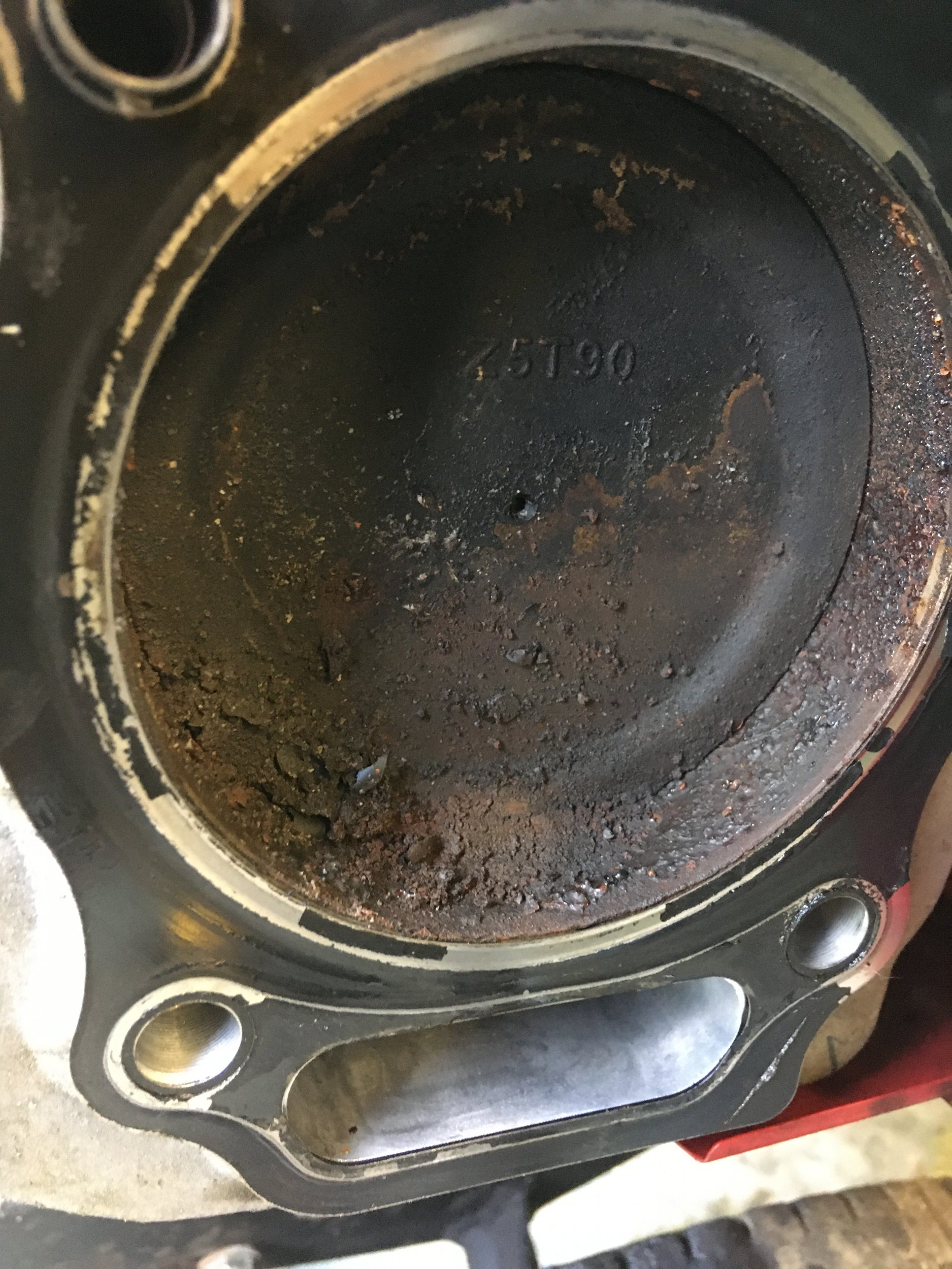

In anycase I'm thinking I will prop up on its side and flood piston with Marvel Mystery-and the put a bar on crank nut and try to work it-as some have suggested. the crap on top of piston is like dirt-its loose.
If I get it to turn overfreely then my question is timing-like a dummy I did not make any marks when I pulled cam out

That's good as the marks are there. That cylinder looks kind of nasty. You are going to have to clean what you can up top , remove the rod cap and push that piston out to clean up the cylinder, rings and piston. If it is dirt, things probably aren't going to go well unless it sat with the plug out for awhile. Maybe rust? Mark if you want, use that smart phone camera as that is your best friend when you are not used to having something apart.

"T"- I used a small wire wheel on top 3/4" of bore and then used a crocus cloth-cleaned up so it would hit TDC-it was "locked' at about a half inch from TDC. I'll take pix in AM. It still would not rotate and I could not see what the obstruction was-took the cover off the fan and it now rotates but I still did not see what the obstruction was. Stay tunned.
Oh-also I took damper out and now I'm having a hell of a time getting it back in while keeping timing marks lined up.

Is something binding the flywheel, did you check that out?
If not, take the cover off the PTO side of the engine and find out what is going on inside.
I seriously doubt is is anything to do with the cam, they have a steel cam, not plastic like some of the cheapie engines do.
