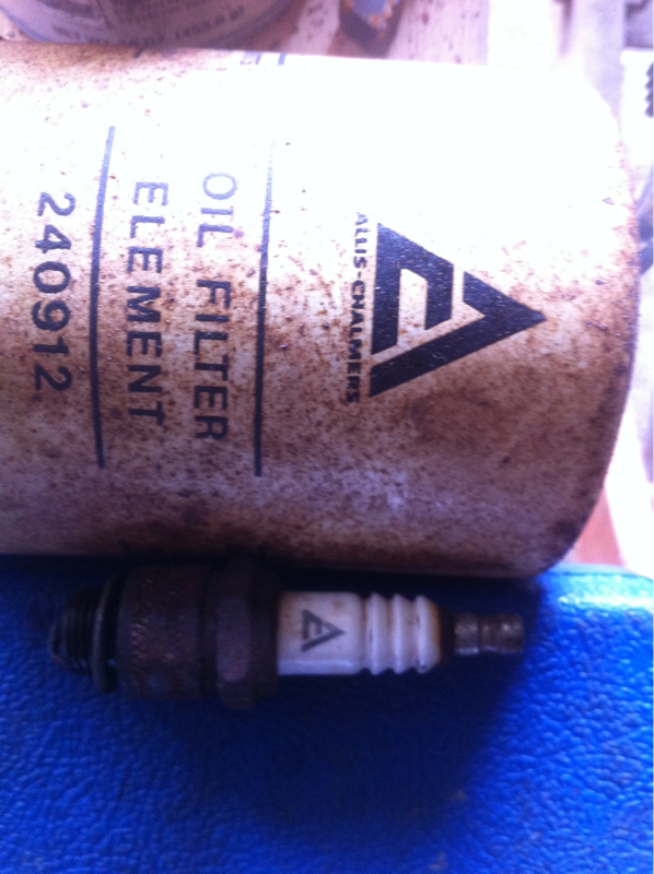

Put oil filter on wd45 filled with oil and mmo(wanted to try it) Put carb on and hooked it up. Cleaned fuel bowl and screen then flushed line. Tossed battery in and finally got to crank it over. Let if puke ATF out of cylinders, tossed plugs in, turned on key, rolled over, and no spark. Picked up new 6v coil, points, and condenser on the way home.

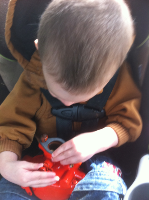

My chief mechanic making sure I did it right haha. I like all the AC parts that were on it.
