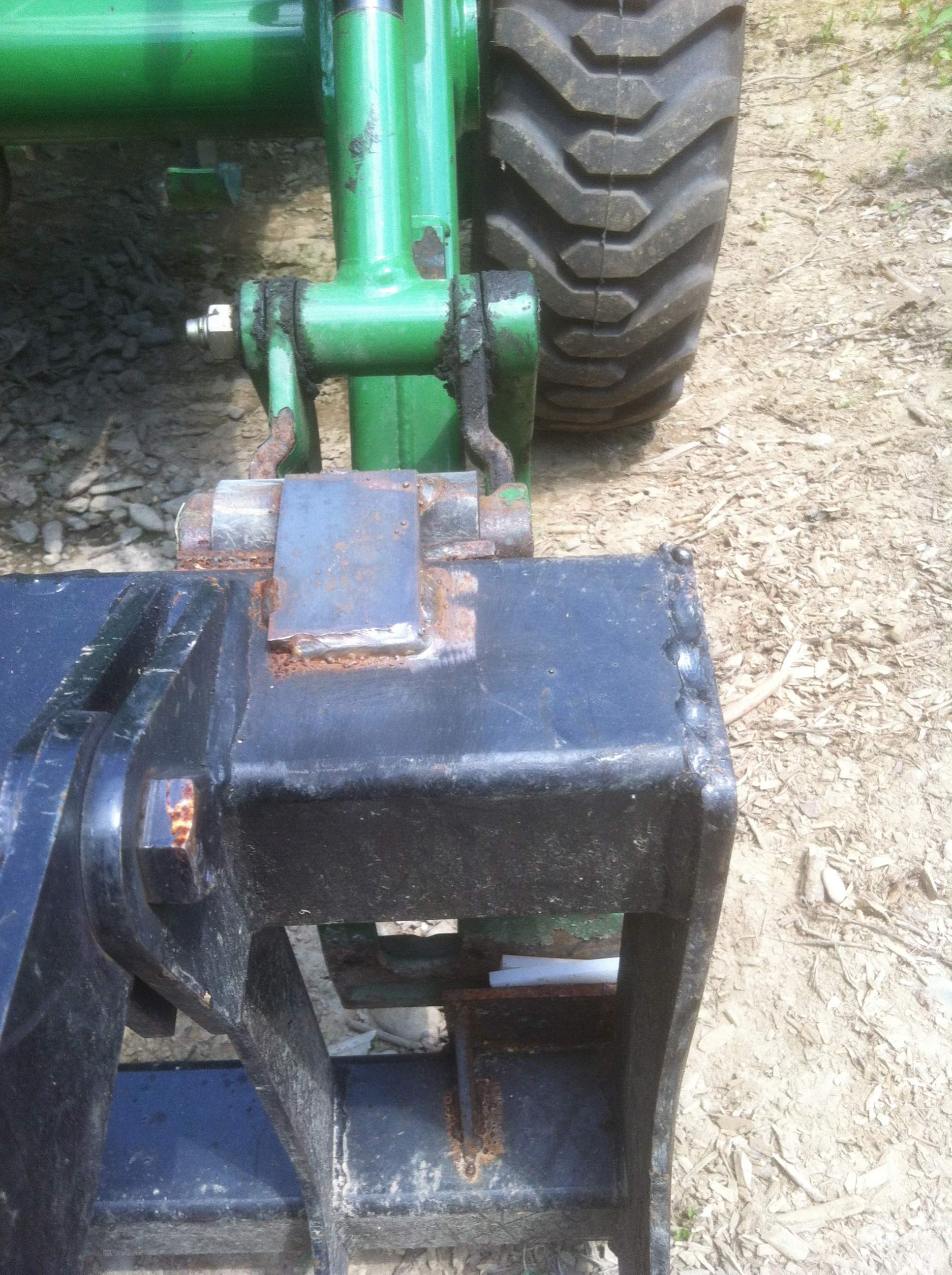

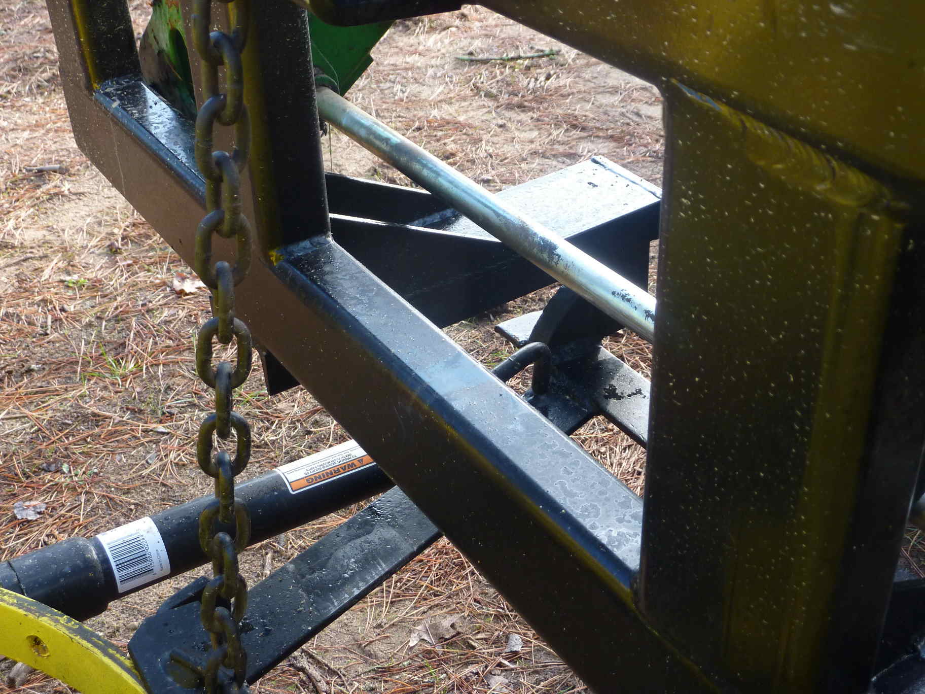

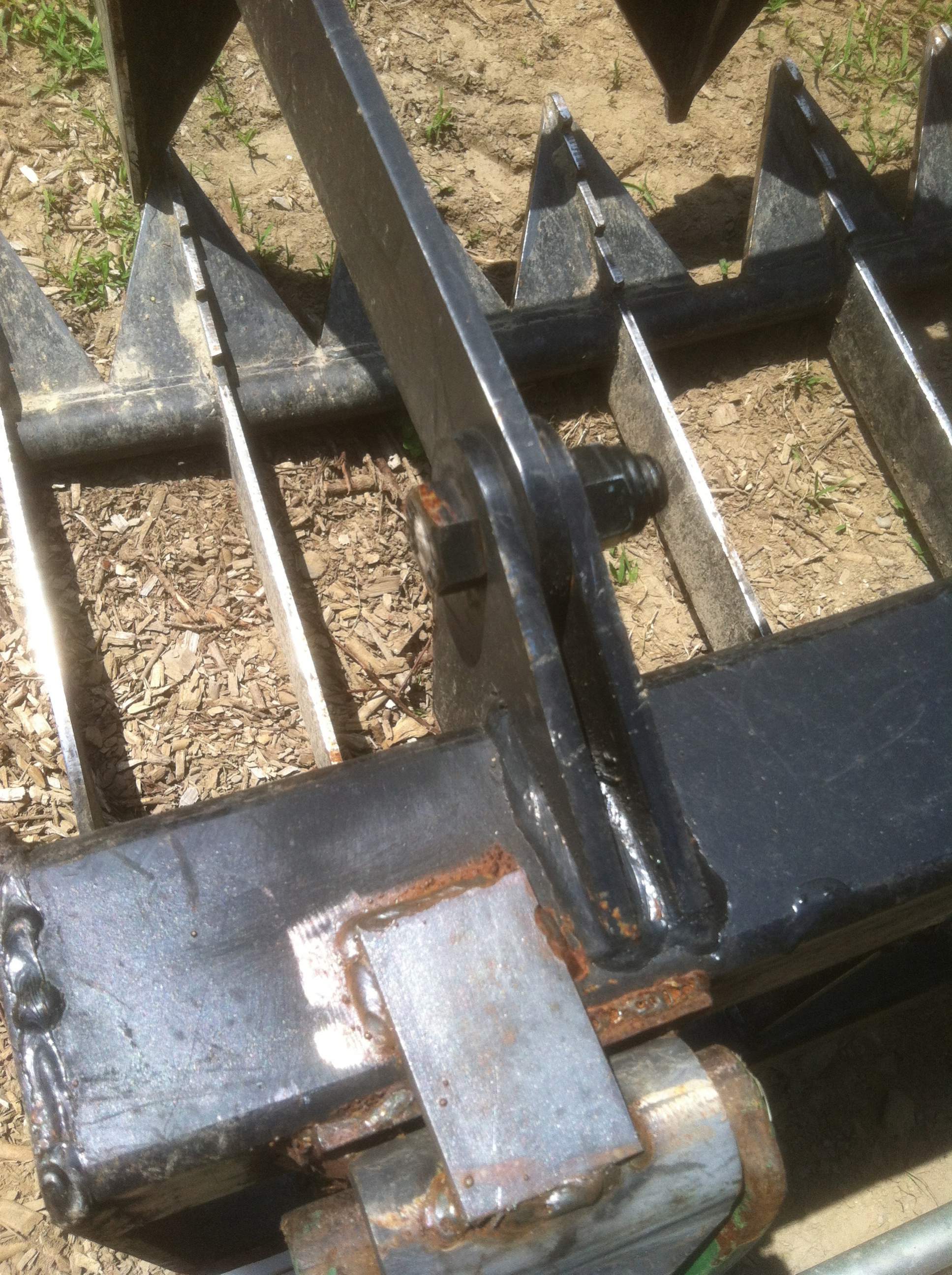

My two cents- I'm a Wildkat fan. the 48" Economy is a heck of a value-and just right for a 3320. If you are buying this to move brush, buck logs etc its perfect. remember-every pound of steel in the grapple is one less pound of payload. granted there is a trade off on durabiity but if you damage this thing with a 3320 you are truly a "cowboy"! IMO perfect match for a 3320. there are a ton of posts on this subject and a ton of Wildkat 48 "fans". check it out.
couple of pix of mine- I ordered without the JD hook up and installed my own
Unless you add the re-enforcement to the top of those JD hooks.....you are asking for trouble. This is what I wrote about above. With a heavy load you are liable to open those hooks which could result in expensive repairs to your loader and your grapple. It happened to me with a Gator product....which is made similar to that shown in your pics. LOOK at the JD hooks.....they have a gusset plate on top of that hook to add strength.
You have allot of leverage on those hooks with those long grapple teeth and a heavy load that may be waaay out to the side. Easy to bend those hooks if you don't have proper support!
I built a snow blade for my loader last year and IIRC the gusset plates were about $6 each. You also could make your own.....just look at any JD bucket to see how to properly do this.....or look closely at the pic below.
OK....stepping down from my soapbox....again. ;)
Agree- those pix were "in progress" . see attached-Probably could have made them bigger/wrap around but I think they do-that plus "Operator common sense"

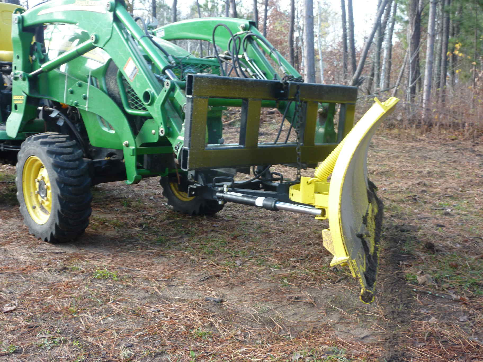

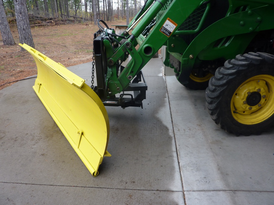

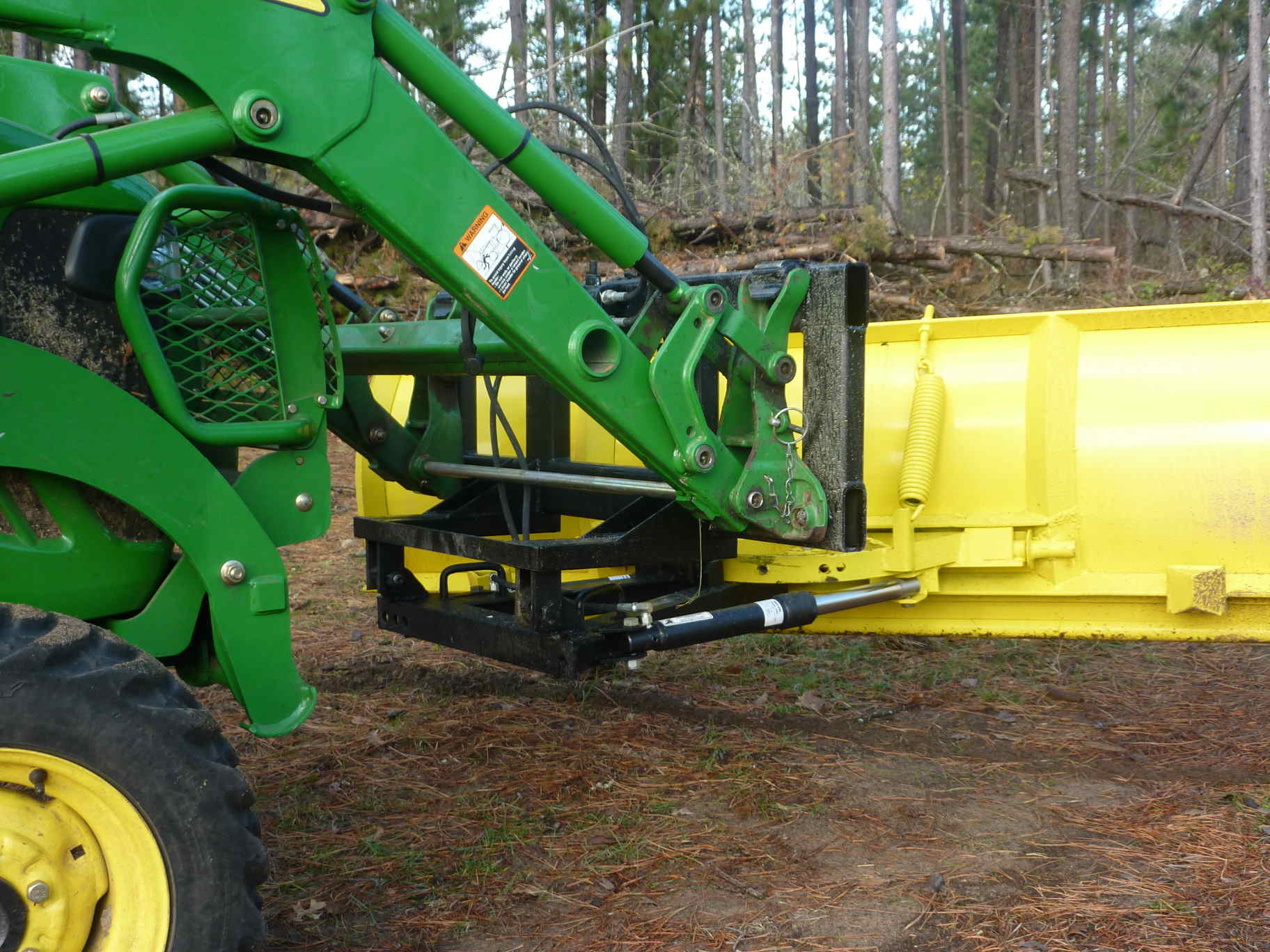

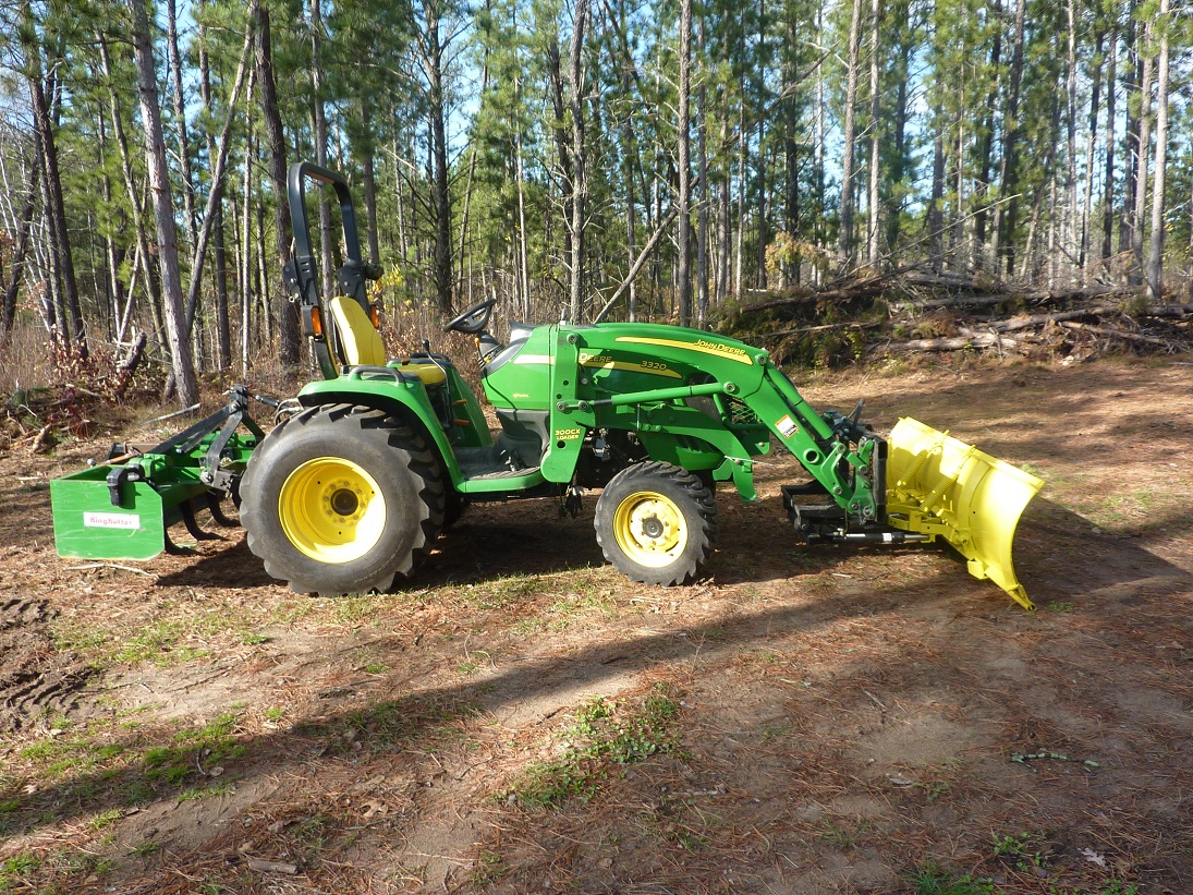

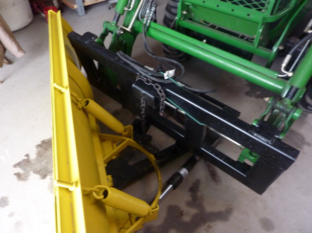

OK....at the risk of trashing this thread....here are some pics of my snow plow build. The novel thing about this plow is how I kept it from getting too far forward of the QD mounts....but kept it as a floating plow - which is good for rough surfaces IMO.

Very nice- nice welds-Also that is a nice "rot free" Meyers. First one I built I had the arms on the front of the plate- thing had one heck of a turning arc- I've since shortened but the attachment point is now directly UNDER the plate-not to the rear like yours. again, nice job.
That's what immediately struck my eyes. Very nice! thanks for sharing. You pulled that out just now and took pics to tease us . . didn't you!:licking:
