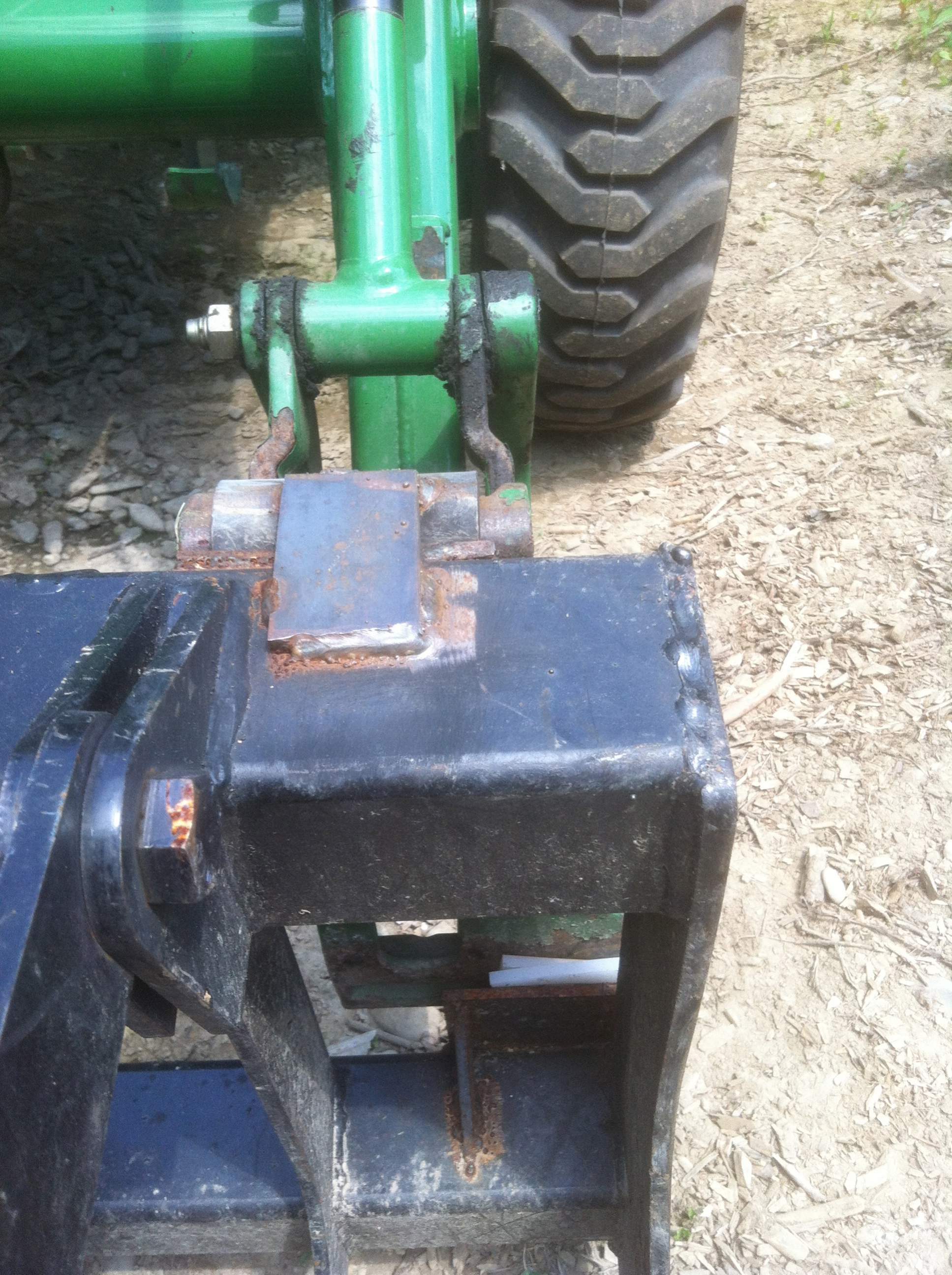

The pics you show above are the same as I recieved from Gator / Markham. BEWARE....their are no gussets on the top of your JD QD "hooks". If you pick up max loads those hooks will spread and you may break your loader. I did. It cost me about $500 to fix my loader and rebuild the mounts they way they should have been from day 1. It only takes a few dollars worth of gussets and a little welding to fix it right.
The other thing....if you do much brush and log work your bound to run branches through the openings between the loader masts. That could be hard on your grill or radiator. (dont ask me how I know) May as weld some protection in that area too.

I'm just taking a break from shoveling beach sand....so I dont have time to search for my modification thread now. May post it this evening or tommorow morning. Take a look at any JD bucket and you will see the way they add some re-enforcement to the bucket "hooks" at the top of the Quick Tach bucket. The gussets (re-inforcement) plates are not found on these grapples. They should be....or when you pick up max loads (with those long tines on a grapple especially) those unsuported hooks will open up and all the load will instantly be applied to the bottom pins. Yes, you can buy the gussets over the parts counter at the JD store for a few bucks.
At that point the bottom pin will break away from your loader mast and the casting that has the hole will likely break. The casing and the timing bar will break - if it's done as I did it. Then your faced with repair parts and fixing the blasted grapple too. ALL BECAUSE THE MANUFACTURER IS TOO CHEAP TO PUT A FEW GUSSETS IN PLACE LIKE THEY SHOULD. The cost could not amount to $5. during the manufacturing process. Big whoop.
Obviously these manufacturers have never really tried their product on a John Deere tractor or they would know enough to make the needed changes. It aint rocket surgery. (can you tell they pissed me off? :D )

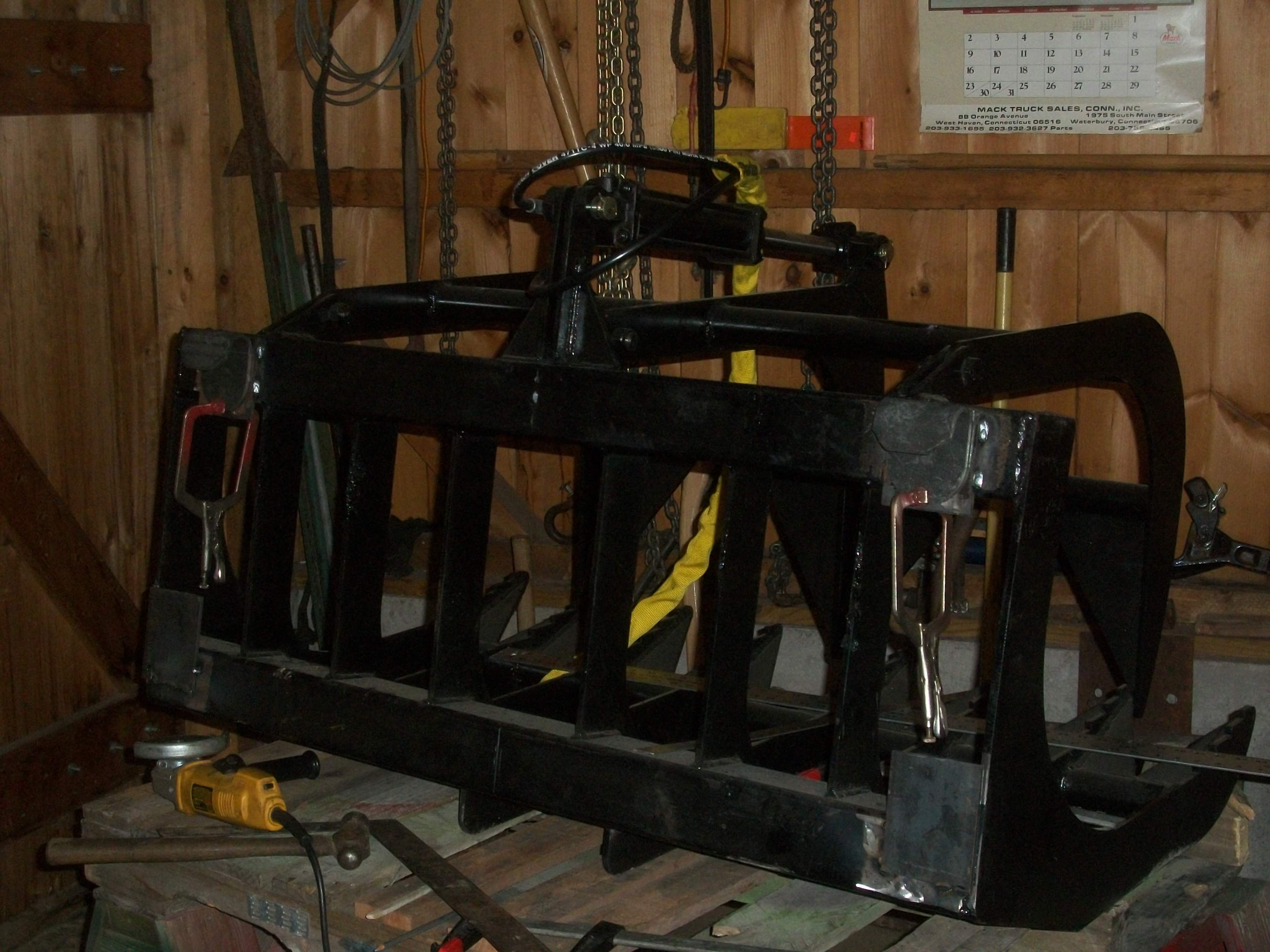

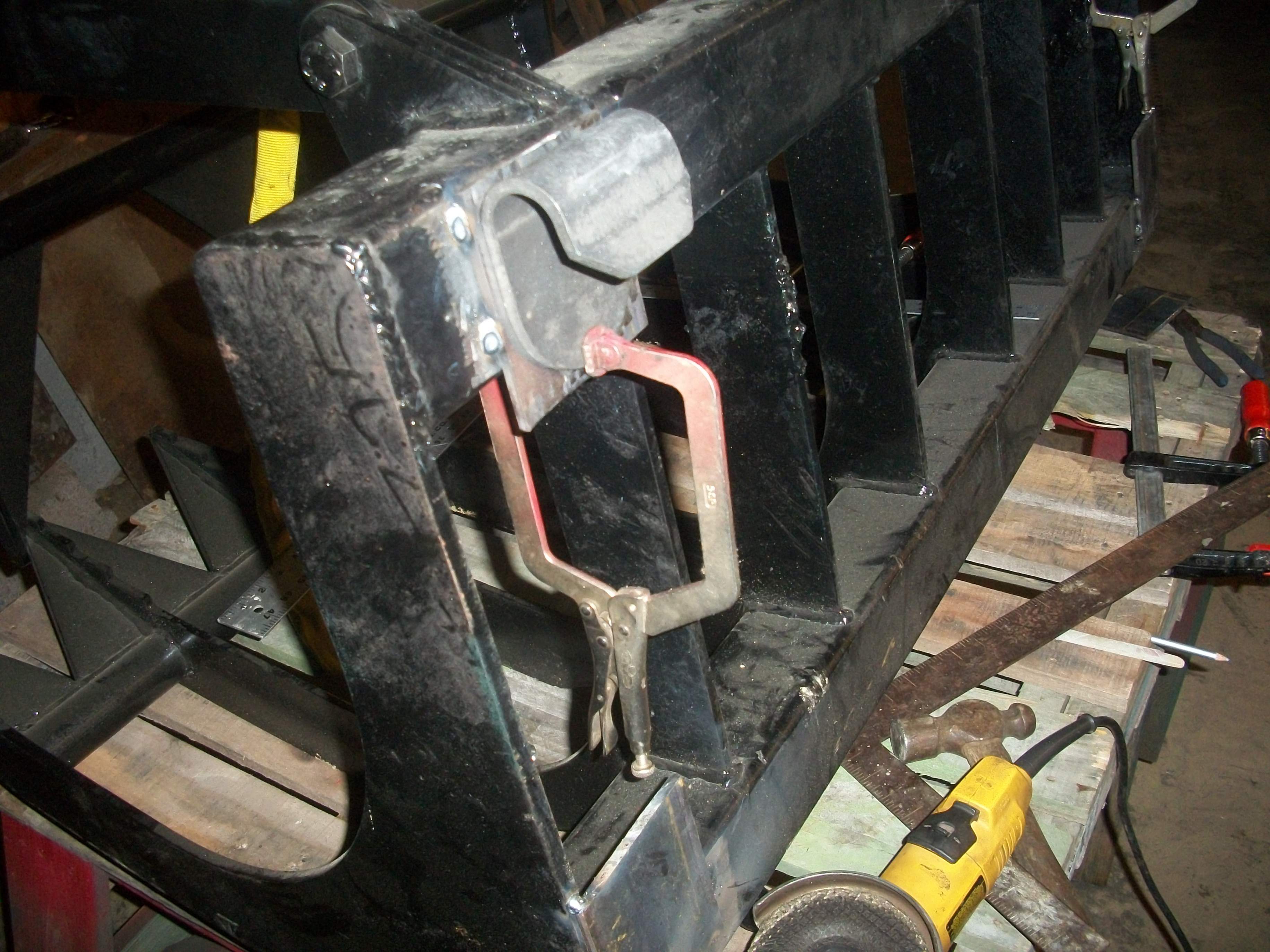

My two cents- I'm a Wildkat fan. the 48" Economy is a heck of a value-and just right for a 3320. If you are buying this to move brush, buck logs etc its perfect. remember-every pound of steel in the grapple is one less pound of payload. granted there is a trade off on durabiity but if you damage this thing with a 3320 you are truly a "cowboy"! IMO perfect match for a 3320. there are a ton of posts on this subject and a ton of Wildkat 48 "fans". check it out.
couple of pix of mine- I ordered without the JD hook up and installed my own
