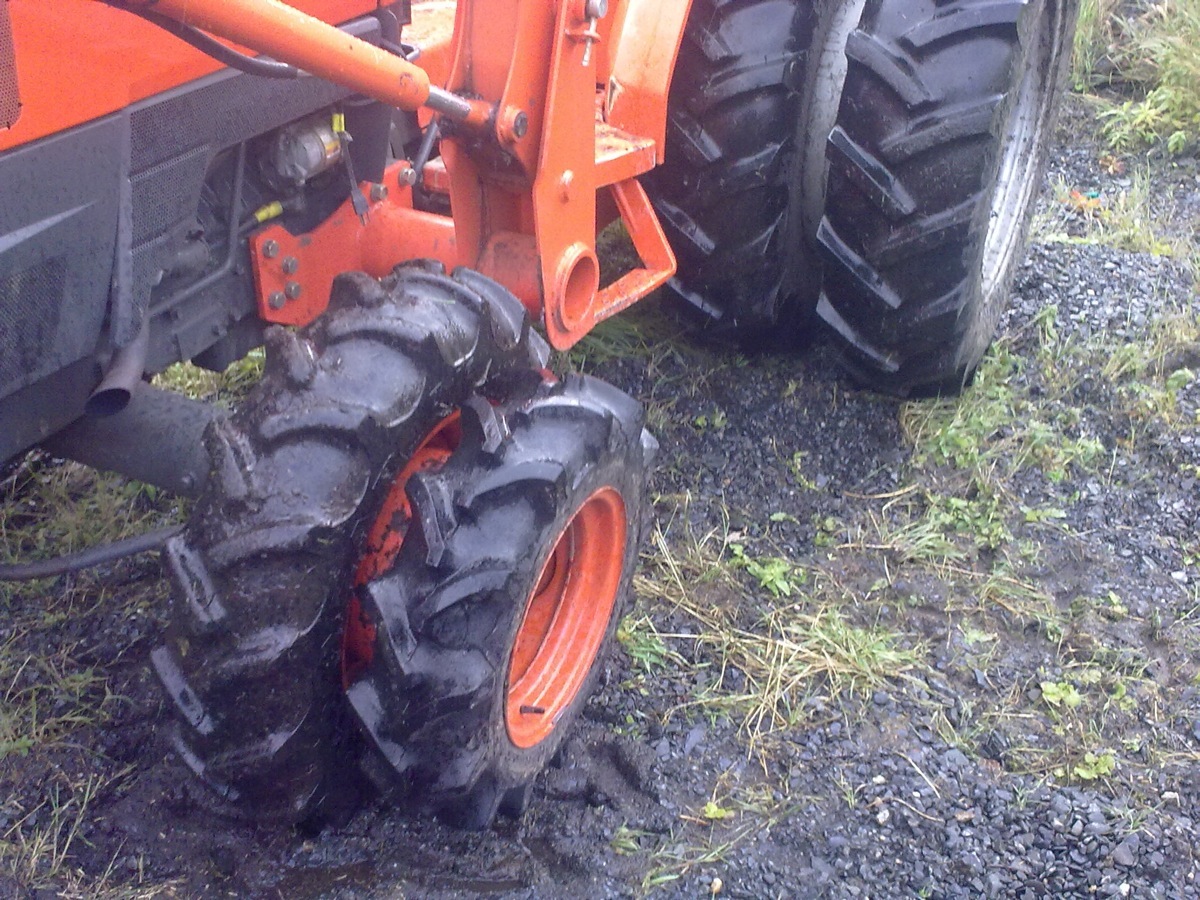

Another option is putting duals on. Besides extra traction and flotation it will give you a lot more stability. For my use, my little kubota would be worthless without them.
Rick
   / Selection criteria of ag or industrial tires #25
Rick
I have often thought about doing that but I didn't know if anyone made a kit for it.
Is yours a custom one-of-a-kind type setup or does someone actually make a setup for it??
I was also concerned with the added stress on the front axle/spindle assemble as well as the steering. The duals would give the wheels/tires combo more leverage on the axle. Do you have any issues, or diffulcity steering?
I am not worried about the rears, It is always the fronts I have problems with and would probabally only want the duals on the front anyway. With a full bucket, there usually isnt much weight over the rears anyway, at least in my case.

I made the fronts myself as I couldnt find them anywhere. I also used the next size smaller ag tire to give me more clearance on the loader frame and didnt need the extra floatation on the hard pack.I got some extra rims, cut out the center, had the welding shop in town roll me out a couple circles(u might be able to find the right size pipe) the same size as the cutout center and then welded it to the new rim on the under sized tires. It has worked well, the only thing I did bend both front tie rods right after I got the tractor but I attribute it more to being a newb. Was ripping up tundra in 4 wheel drive and doing it a bit to aggressivly for a l2800.
Rick
Unverferth.com had the rears

here you go, doesnt effect the steering at all on the hard pack and digs in and acts as a sort of rudder in sand giving more precise steering and less push.
Rick
