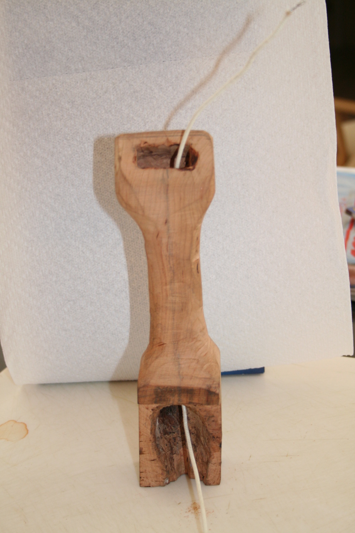

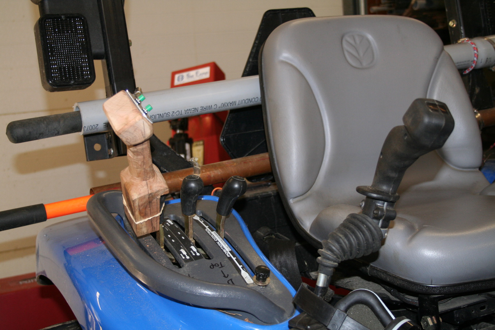

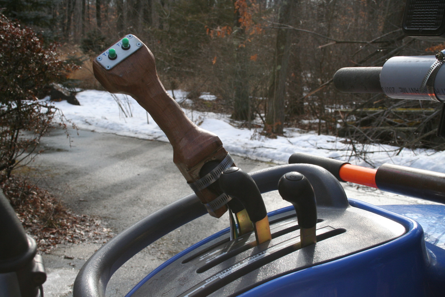

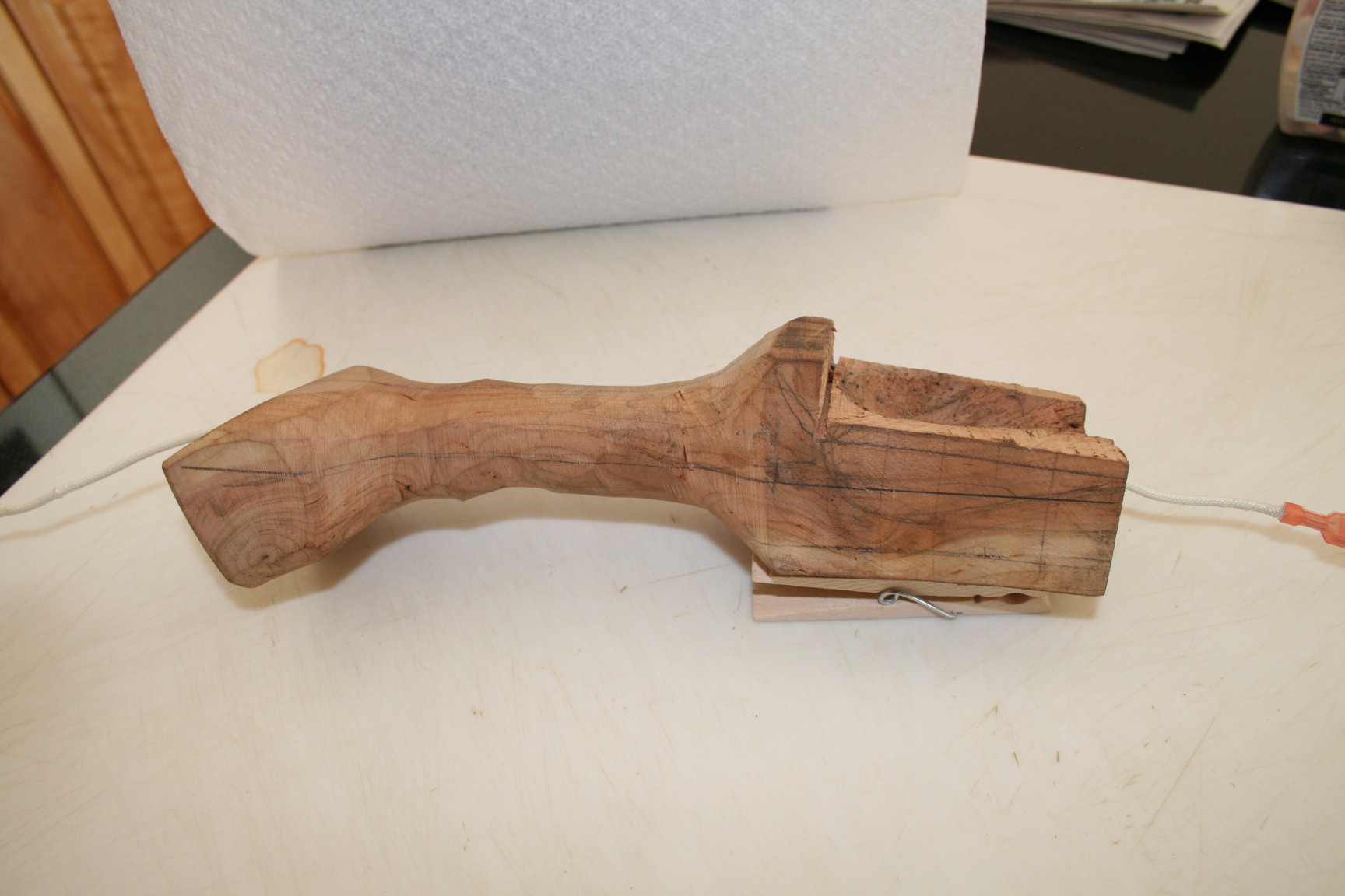

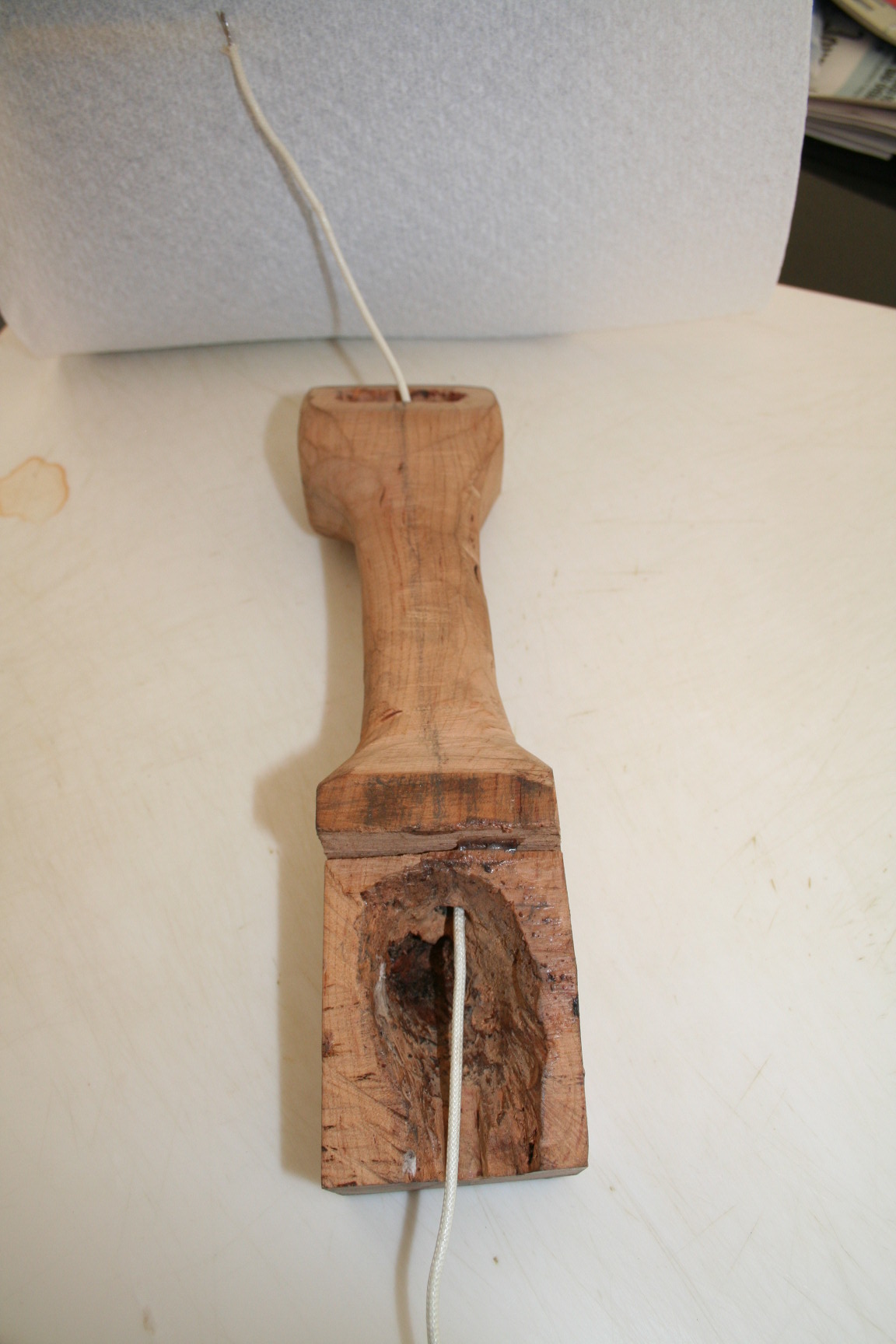

I hit a soft spot on the block , a buried branch , that's the tear out at the bottom of the recess for the valve handle. When I clamped the handle in a vise to hold it while creating the recess I started getting some splits so I stopped and soaked it glue over night. Today I got some hardening preservative and will let some of that soak in as well. I drilled a long hole down the center axis for the wires. You can see a center line on two faces I was trying to follow with a hand drill and a 5/16 12: bit. Not a high spiral so there was a lot of back and forth to clear the chips. I felt it drift when the bit hit another soft spot about 2/3 of the way down but by that time I just kept going with a little prayer. Exit hole was about 3/8 up and to the right but did not break out so it will work fine. The Deutch connectors came in and I wired up the solinoid end. Nice weather tight connectors.
I was thinking the handle was going to be 90d from where it is but when I sat in the seat this felt much better. I think I will deepen the socket for the handle a little more and use a couple of band clamps to hold it on. It looks like it could be a lot shorter than it is but that would be either start over of cut it down and add some material , or maybe cut a section out of the middle.
Well that can wait a bit. Coming up on the bracket for the valve I think.

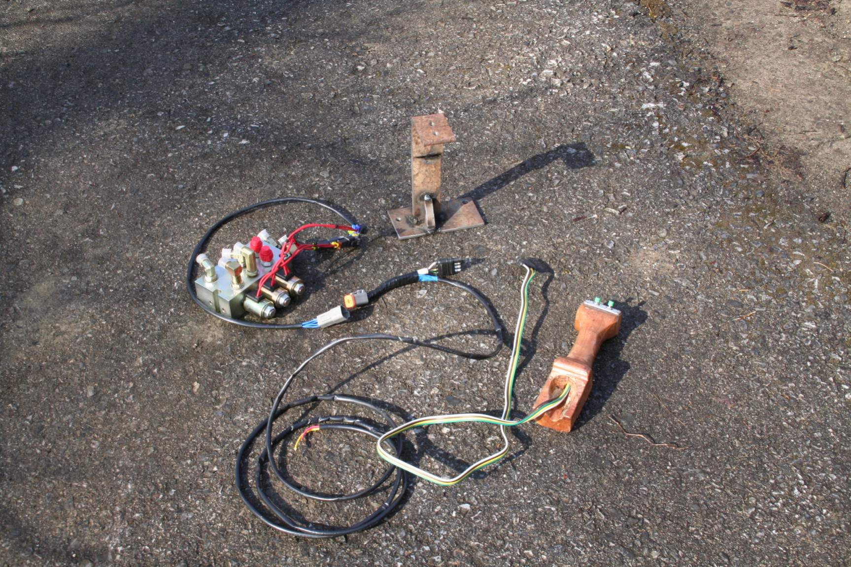

Thats the wrong valve. I suppose I could have put toggles in the Fel joystick handle but then I would have to set that , move my hand to the remote valve , do what ever and then remember to dump the toggle.
I am using the switches for a selector valve for T and T.

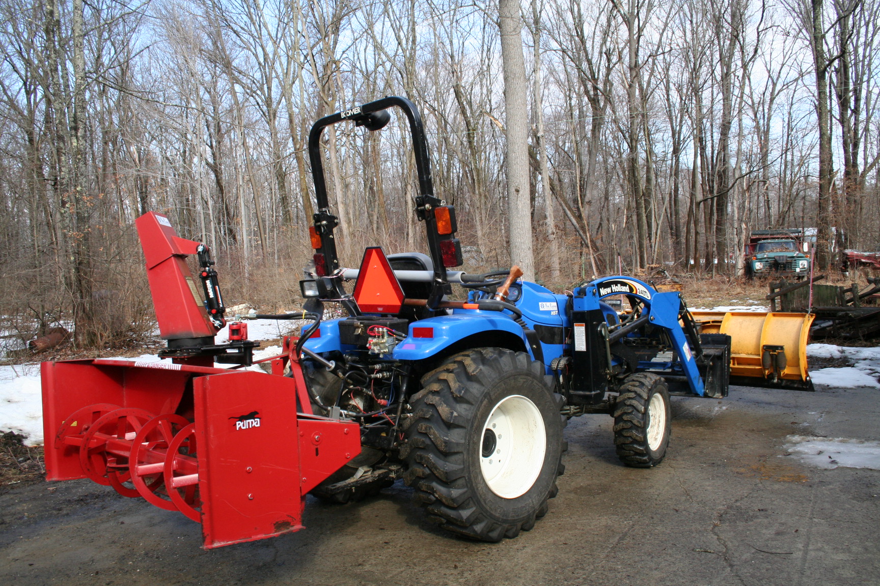

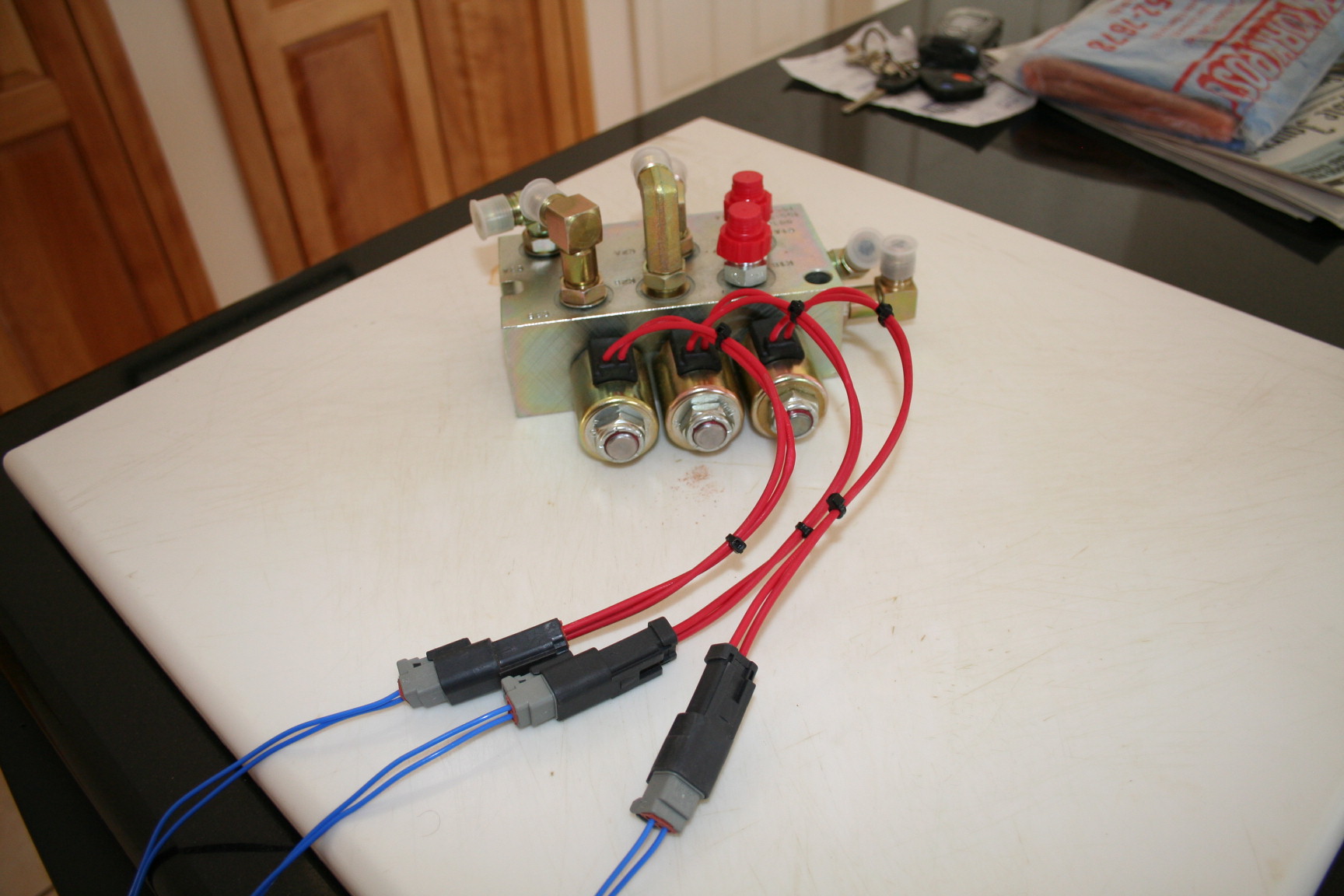

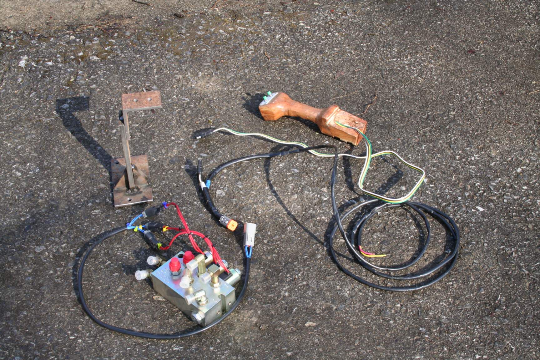

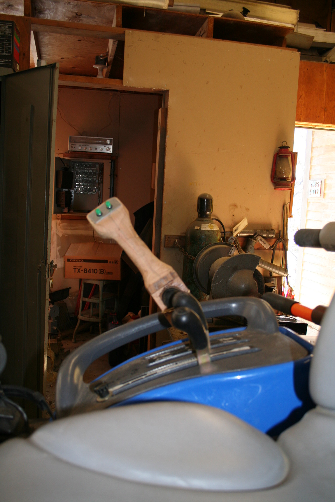

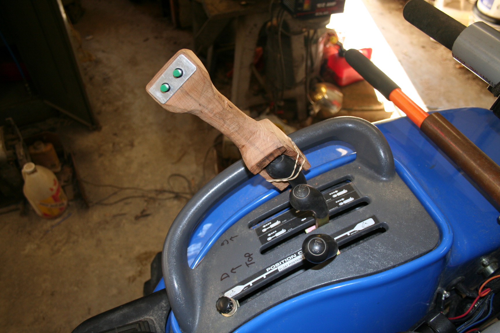

I like that grip. But if I made one like that it would come out looking like my wooden one. I am almost finished with mine. Pictures show all the parts in the kit. I generally do not like to modify the tractor so I like band clamps. I did drill two holes in the cross bar that holds the tool box and SMV sign. Figured the ROPS police would not come calling. I had an interesting process for the hollow in the handle to make it fit around the tractor valve handle. I roughed it out with a drill and then chisel. The I used carbon paper between the grip recess and the valve handle and used a Dremel with a rasp bit to remove material where ever the carbon paper touched. when it touched all around it was finished. I really like the Deutch connectors and was well along with cables ends when I realized one end had to go through the slot where the valve handle protrudes through, so I had to make one end a 4 pin flat trailer connector. I did not want to cut off the ends on the solenoids plus Deutch has a really nice hold down bracket for the connector. Pretty heavy duty bracket to hold the selector valve but I had to get past the toolbox , over 8 inches. The cross bar on the Rops is not plumb and the valve looked not right with the plumb not correct. I have not decided whether to make a wedge or just use washers. It's about .5 inch spacer to make the valve plumb. It is plumb in the picture. Grip is installed , wiring is done , paint is drying on the valve bracket. I have to check for shorts at the last connector , mount the valve , and then it's hoses. What a great price on those valves, wonder why they were surplus. I see they are selling about one a week.
Long story about why there is a plow and a snow blower. 12 years ago smaller tractor then plow then big snow storms then blower then bigger tractor. If I was starting over it would be a cab and blower om front ,I guess.
