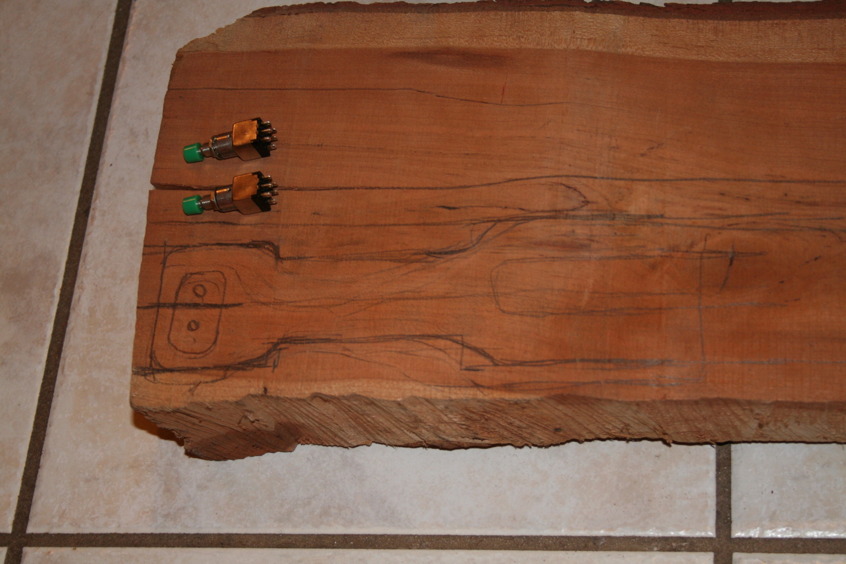

/ selector valve #66
Well, I finally got a chance to paint the bondo knob and finish the switch mounting plate. Also the switch came in. Yea, I made the switch recess in the knob and the hole in the mounting plate without having a switch on hand for measurements. But the switch supplier (delcity.net) had good dimensions on it's website and in their catalog. I went by the dimensions and hoped for the best. This is the DPDT rocker switch I used: Del City Item 7500011
This is the drawing with all the dimensions and circuit diagram: http://www.delcity.net/images/linedrawings/7500011.pdf
First pics are of the switch and the switch plate. The terminal on the center lug in the first pic is a "flag" type, also from Del City. Part No. 192175. I am using them because of the limited depth of the hole in the knob. The wires will come off the side instead of the bottom like with regular terminals.
This is the finished knob:
The bolts sticking out of the shaft at the base of the knob will be replaced with setscrews. The next one compares it to the original shift knob I copied. It turned out a little "fatter" than the original but that doesn't seem to matter, as you can see above, my thumb lands on the rocker switch just right. I used Rust-Oleum orange and it's a pretty good match.
Next I need to mount the valve on the FEL and do all the plumbing and wiring.
