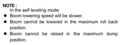

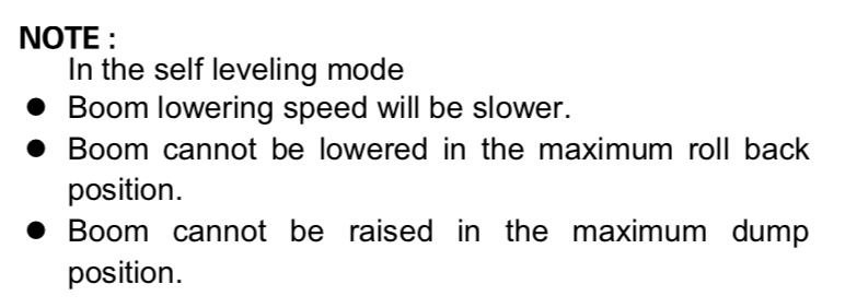

Just confirmed, it does in fact self level when moving FEL both up and down (via manual). What I remember now is that IF you let it self level going up and THEN you curl/dump it will not go back to a level position when lowering. It stays in the position you left it in when you took over control. Does that make sense?
Also from the Manual:

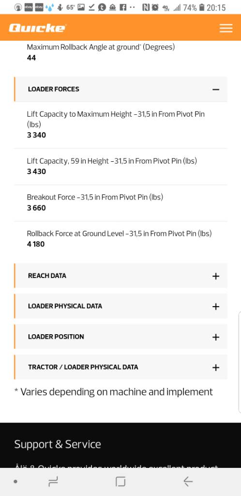

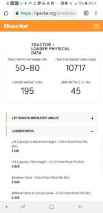

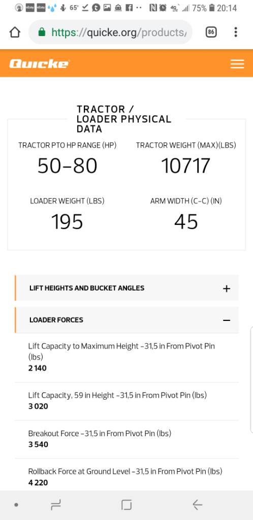

I am sorry if I insinuated that you are not familiar with self leveling loaders. Was not my intent. The Massey website is wrong. Loaders are made by Quicke as I am sure you know, and are their X3 models on the 4700. Click the link.
The MSL is rated higher.
X3S - Frontloader | Quicke | USFrontloader | Quicke | USScreenshot_20181231-201428_Chrome.jpegScreenshot_20181231-201505_Chrome.jpeg
X3S - Frontloader | Quicke | USFrontloader | Quicke | USView attachment 585301View attachment 585302
Sad that the manufacturer and the retailer can't get their specs the same.:( Still does not answer the question of the JD specs. Because of the differences and normally most of the equal sized tractors are some what close in specs, I think that I would believe the Massey specs over the Quickie specs. You have conflicting specs that are the opposite of what others are listed as.
If I was a person considering purchasing one of these, until I was shown otherwise, (Massey acknowledging that their printed specs are wrong) I would be matching the Massey specs vs any other manufacturer (JD as an example) that I was considering.
