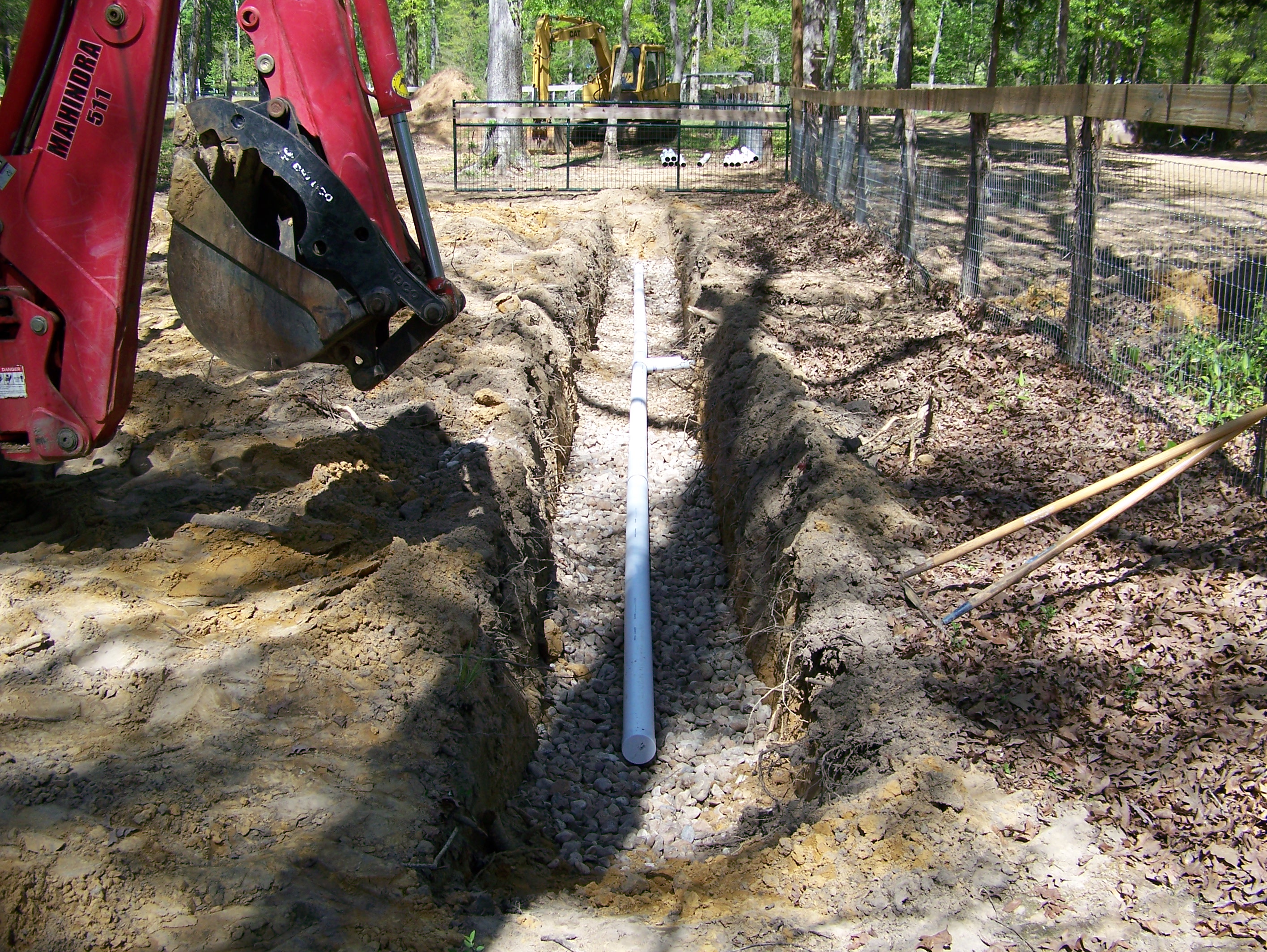

When my field line was backing up and broaching the surface, I found out my field line ran under my driveway to my barn where my heavy equipment comes and goes. Since I had a backhoe and an excavator, I dug a hole for a second tank, then dug a new field line. Picked up a new 500 gallon for $500. Around $1000 in gravel, and around $150 for pipe and tar paper................and lots of grunt work.View attachment 494064

I think he said he isn't allowed to do that on his own. It has to be installed by a licensed septic tank person ,and inspected.

Right. They spell out every detail. Won't even let me use sand - has to be gravel which adds a lot of cost. Soil sand is 6 feet down so I have to fill to that with gravel - $8000 worth. Pump system, two tanks with settling chamber. Who cares, not inspector's money.
