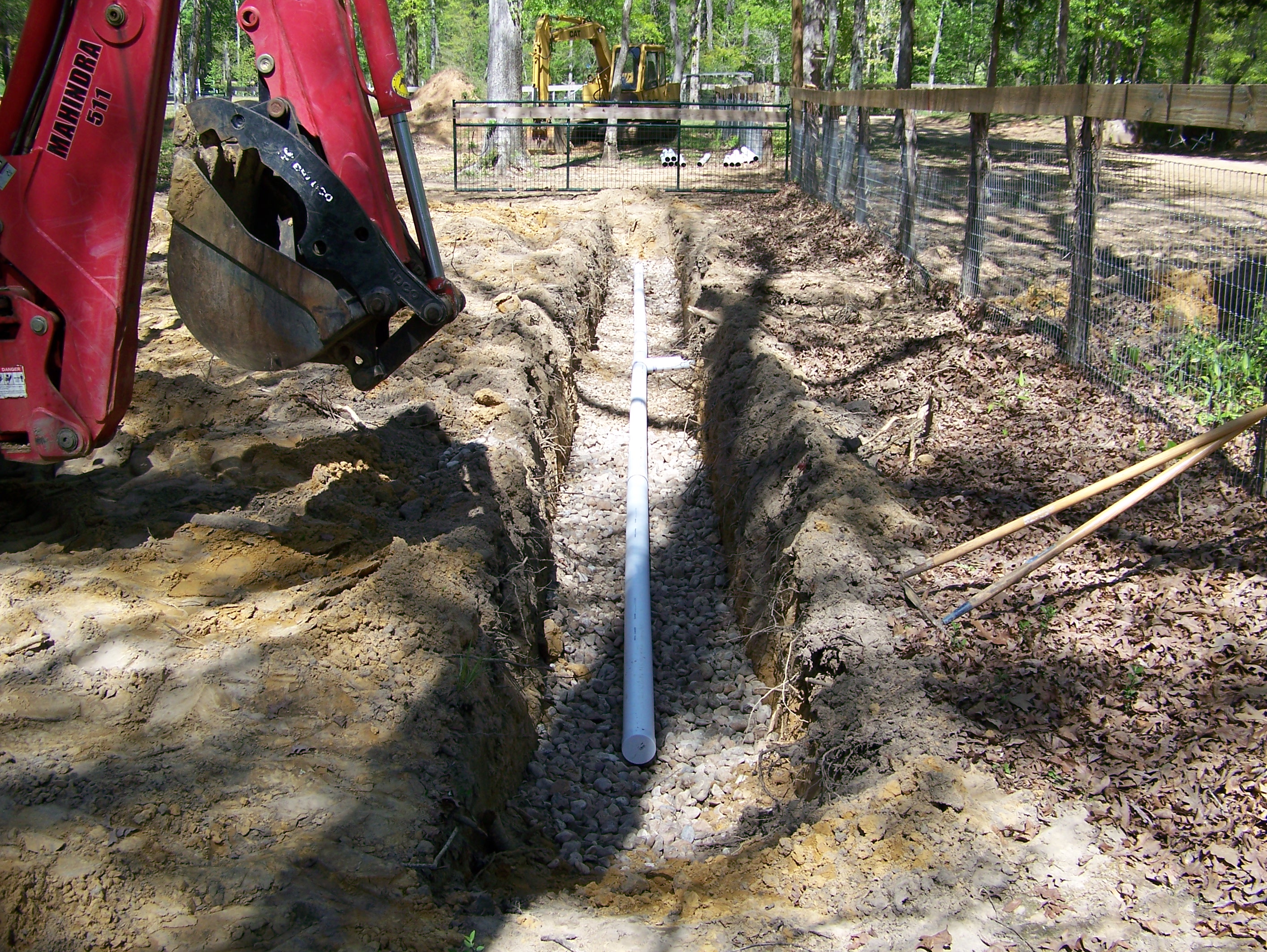

When my field line was backing up and broaching the surface, I found out my field line ran under my driveway to my barn where my heavy equipment comes and goes. Since I had a backhoe and an excavator, I dug a hole for a second tank, then dug a new field line. Picked up a new 500 gallon for $500. Around $1000 in gravel, and around $150 for pipe and tar paper................and lots of grunt work. 3-24-16 Drain Line 7 Feet From Fence.jpg
Heck, if nothing else, rent a loader/backhoe and dig your own field line longer, or run a T and a new leg of field line.
