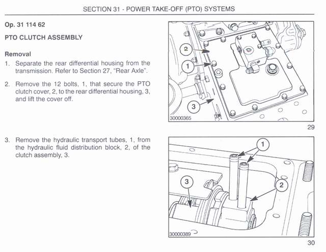

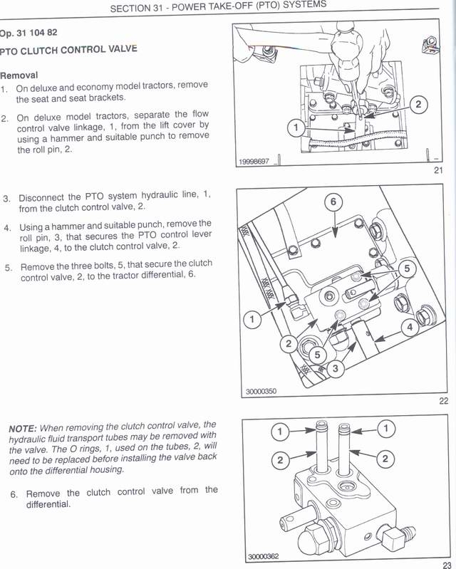

Doing a search on TC35 PTO issues, I find 2
One is taking the seat pedestal off and doing something with the valve body or stop
The recall involves the replacement of a PTO stop plate and does not involve splitting the tractor. Repair time should be 1-2 hours according to CNH.
The other involves splitting the tractor.
   / Selling tractor looking for fair price advice #36
This explains it better
Tom, I think the dealer will first remove your seat where there is an access port to the PTO control valve and cover plate on top of the rear transmission. He will remove the valve and plate and inspect your PTO clutch. If it is only a damaged stopping plate, that can be replaced without removing the entire clutch.
If the complete clutch has to come out, the Repair Manual calls for splitting the tractor between the front transmission case and rear transmission case so the shaft the PTO mounted on can be driven out the rear of the housing to allow the clutch to be removed. This is a much more critical issue than just replacing the stopping plate.
I don't believe the dealer will be able to tell you how big a job it will be until he gets the cover off the transmission and inspectes the parts.
I've uploaded two diagrams. The first one shows how to access the PTO valve through the access under the seat. The second shows the plate the PTO valve is mounted on and what the clutch looks like with the plate removed. The flat plate on the top of the PTO clutch with the notch in it is the PTO stop plate and what may be damaged on your tractor. Of course, it also might be ear on the PTO that slides into the slot. That would mean the whole clutch has to be removed.
