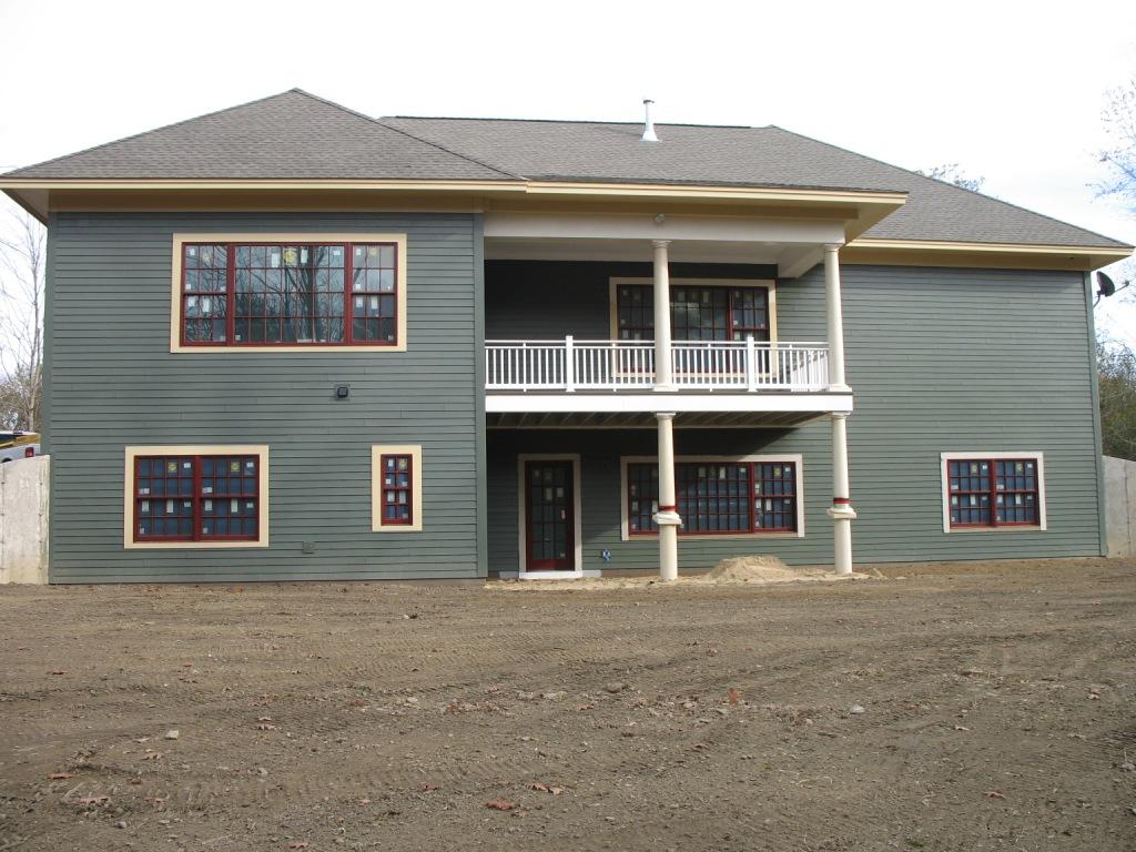

I'll try to get some posted in the next day or two, I see uploading PICs is a bit more complicated (PIC sizing wise) than in 2011. The outside of the house doesn't look different from others however the walls are 2.5" of EPS, 8" of concrete and another 2.5 EPS. I used all the James Hardie Products on the exterior over the ICFs, the Build Block brand of ICFs have webs every 6". The house is approx 1,736 sq.ft footprint in the basement and on the 1st floor. My wife and I ran PEX over EPS in the basement slab and installed Slant Fin Radiant Baseboard on the 1st floor. Since taking occupancy this past Nov we were averaging (when it was below freezing all the time) about $12.00 a day for the boiler, hot water heater and cooktop.

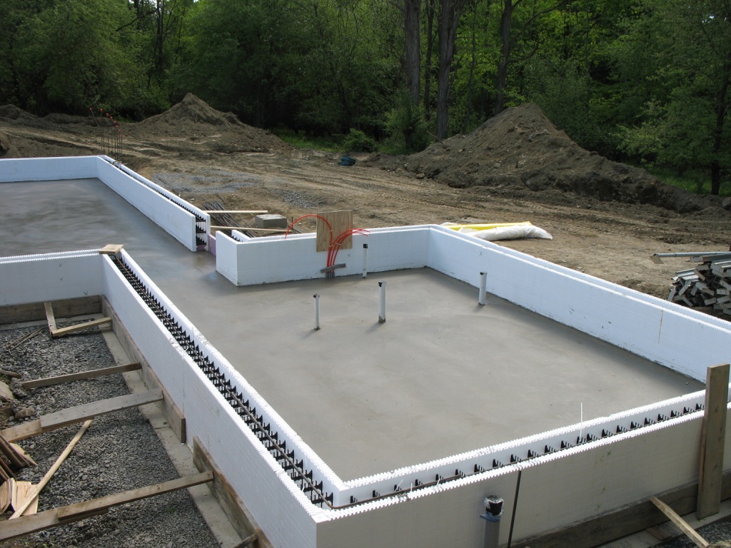

2013 Insulating Concrete Form (ICF) Project
Eddie,

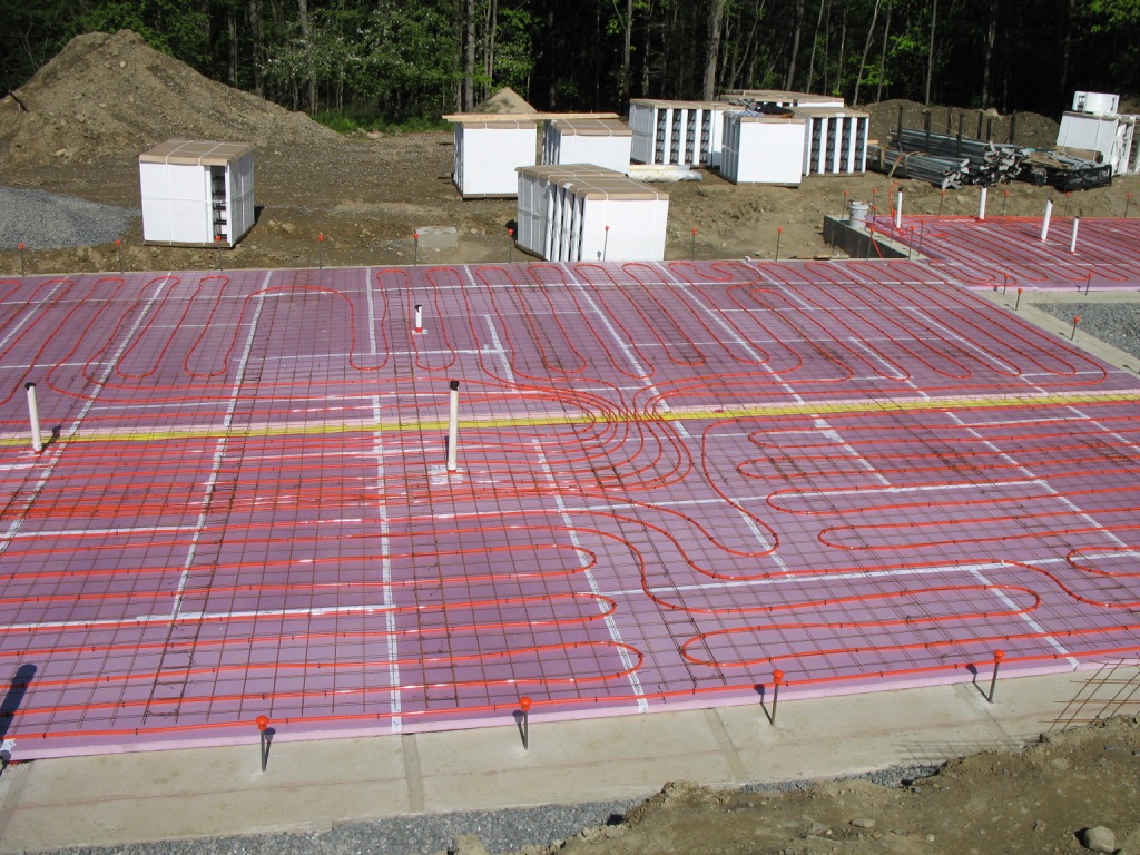

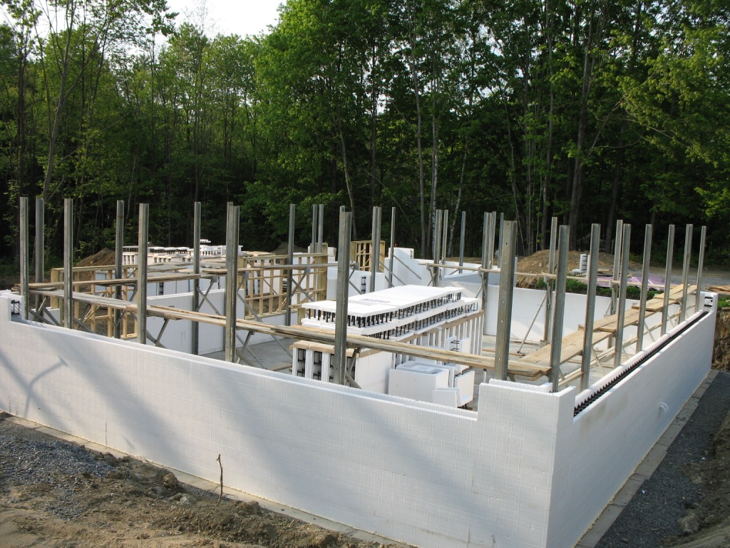

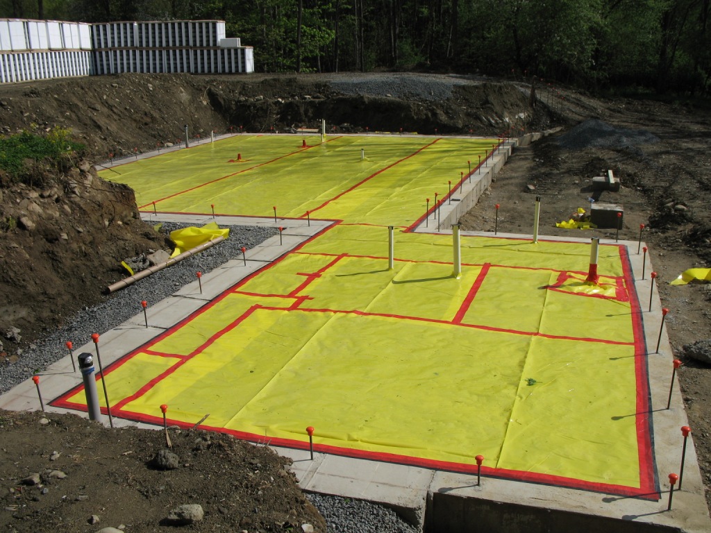

My wife and I followed the PCA (Portland Cement Association) 100-2007, Prescriptive Design of Exterior Concrete Walls for One and Two Family Dwellings. New Hampshire requires a Single Family Dwelling construction to follow 2009 IRC and R611.1 in that document allows for either PCA100 or ACI318. Because of our Soil Composition we opted to go with PCA 100. Our footings were 30" Wide X 12" Height with vertical rebar. IMAGE # 3714 depicts the footings already down, in-ground plumbing accomplished, 6" drainage pipe inside and outside the foot perimeter, 3/4" crushed stone between footings, Stego Vapor Barrier applied. IMAGE # 3766 depicts Owens Corning Formular 400 applied over the Stego Barrier, seams tapped with Tyvek Tape + NIBCO Barrier- 1/2" PEX stapled on top of EPS + Welded Wire Mesh over that tied together w/6" overlap. IMAGE # 3786 depicts the most critical stage in building an ICF Structure, setting the two courses of block which were shimmed LEVEL (double checked with Lasar), glued to the footings using Wind Lock Foam Adhesive then Cable Tied every direction side X side, top to bottom. Once the blocks were glued and tied we poured the 5" slab in-between the empty blocks and adding wooden blocking on the outside for reinforcement. IMAGE # 3817 depicts we're underway with the window and door "Bucking" Installation, i.e., Treated Wooding Frames = I.D. of the Window and Door Rough-In rqmts. For the doors I added an additional 7" to the sides and top to allow for Door Swings and to be able to install the case next to the door jams vs. sitting out way on the interior walls, my 8" core Blocks = a total 13" depth exterior to interior surface. Also, this image shows the Concrete Sub's Vertical Bracing attached to the slab and screwed into the ICF Webs. That痴 it for now, more to come tomorrow?.

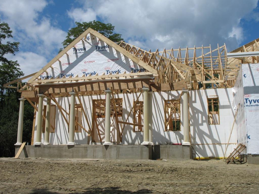

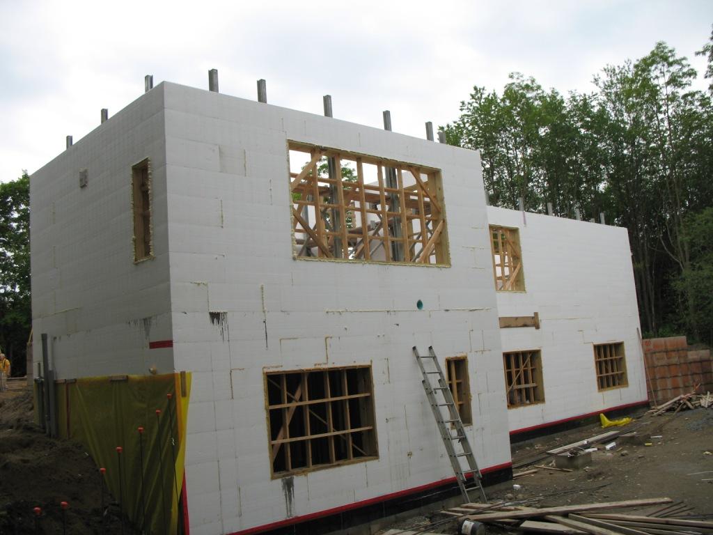

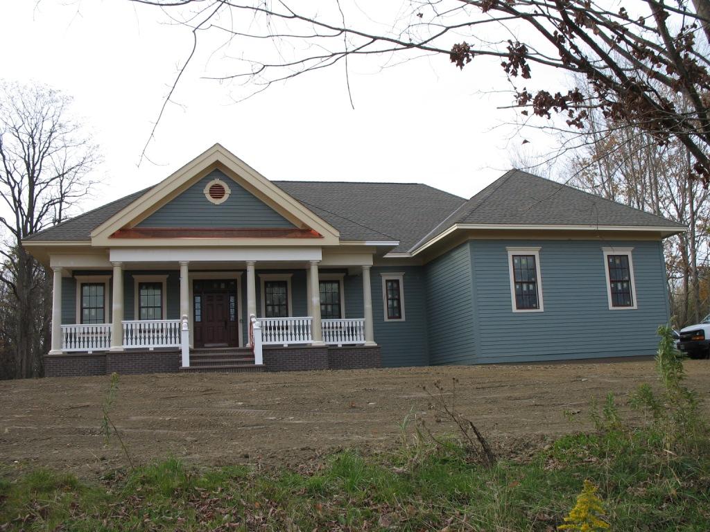

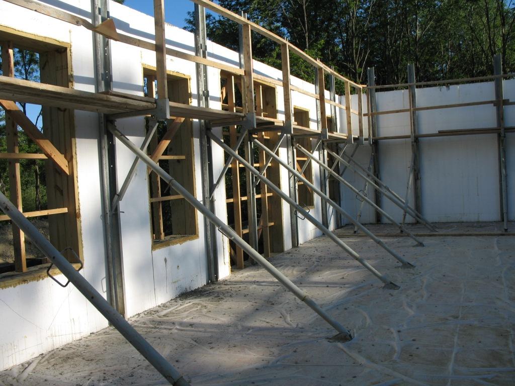

   / Semi-New Member Returns after Building an ICF House
Re: 2013 Insulating Concrete Form (ICF) Project

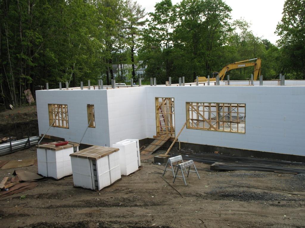

CONTNUED........... IMAGE # 3814 depicts the completion of the Basement Level ICF Stack (9" ceiling height) with a view of the Walk-Out Basement; all other walls below grade. For waterproofing, coating of TAMKO TWP-2 Water-Based Primer then TAMKO's peal and stick TW-60. As a final layer I added a sheet of TAMKO 15mil Vapor Barrier with seams taped. Below Grade and rear walk-out ICF walls #4 rebar horizontally/continuous with the appropriate overlap splice in each course and tied. #4 rebar installed vertically throughout depending on the wall location and PCA-100 load calculations. Stirrups, #5 rebar and various custom bends ordered from a local steel company. IMAGE # 4014 shows the addition of the 1st or Main Floor (10' Ceiling Height). You can see the Window and Door Bucks, the beginning of the 1st 10" thick Retaining Walls to the right and the Stego Wrap is clearly seen to the left over TAMKO. The Floor Trusses are 20" Open Web Design to allow for easy HVAC runs, Top Bearing Cord resting on LVL Ledger Board tied to the poured ICF walls using Simpson Strong Tie's ICFVL Ledger Connector System. IMAGE # 4054, just an inside view of the Vertical Bracing screwed into the floor trusses over on top of the sheathing to allow for 1st floor ICF Block Installation. IMAGE # 4253 depicts the front elevation of the house, I used HB&G's 12 inch PermaCast Structural Load Bearing (18,000 lbs max) Columns on both the front and rear elevations, double stacked in the rear. In this PIC the hip roof trusses and front gable are visible. IMAGE # 4499 is the Rear Elevation as we scrambled to get everything primed and painted with a finish coat, 90% Finish Coat complete before the winter. For the exterior envelope I used all the primed James Hardie products, i.e., vented and unvented soffit, lap siding, etc. Also used AZEK and BORAL Truexterior material for trim + AERATIS T&G Decking for the rear porch. Before the siding was applied, at top of Stego and TAMKO waterproofing to planned bottom of lap siding I applied STYRO Industries TUFF II Pre-Mixed Coating over their fiberglass mesh. I used it on my previous build and had no problems. James Hardie was installed over the ICF Blocks using Simpson Strong Tie's Simpson DSVT212S #10 x 2-1/2" QuikDrive Collated DSV Decking Screws @ spacing every 12". All cuts in the Hardie products were primed and lap siding butt joints flashed. IMAGE # 4505 Front Elevation and ready for finish coat once we get through this too long winter. So, long story short (if there can be one) if anyone plans on building an ICF Structure please don't hesitate to ask any questions. As you can see my April '13 thru October '13 Build was fun filled
