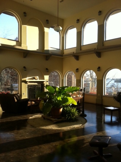

   / Semi-New Member Returns after Building an ICF House #29
We went with ICF as well. We went with a Spanish style and enjoy the feel of the solid home. Our floors are also concrete.
   / Semi-New Member Returns after Building an ICF House #30
Very nice. I bet you forbid little kids from playing baseball around those windows!
