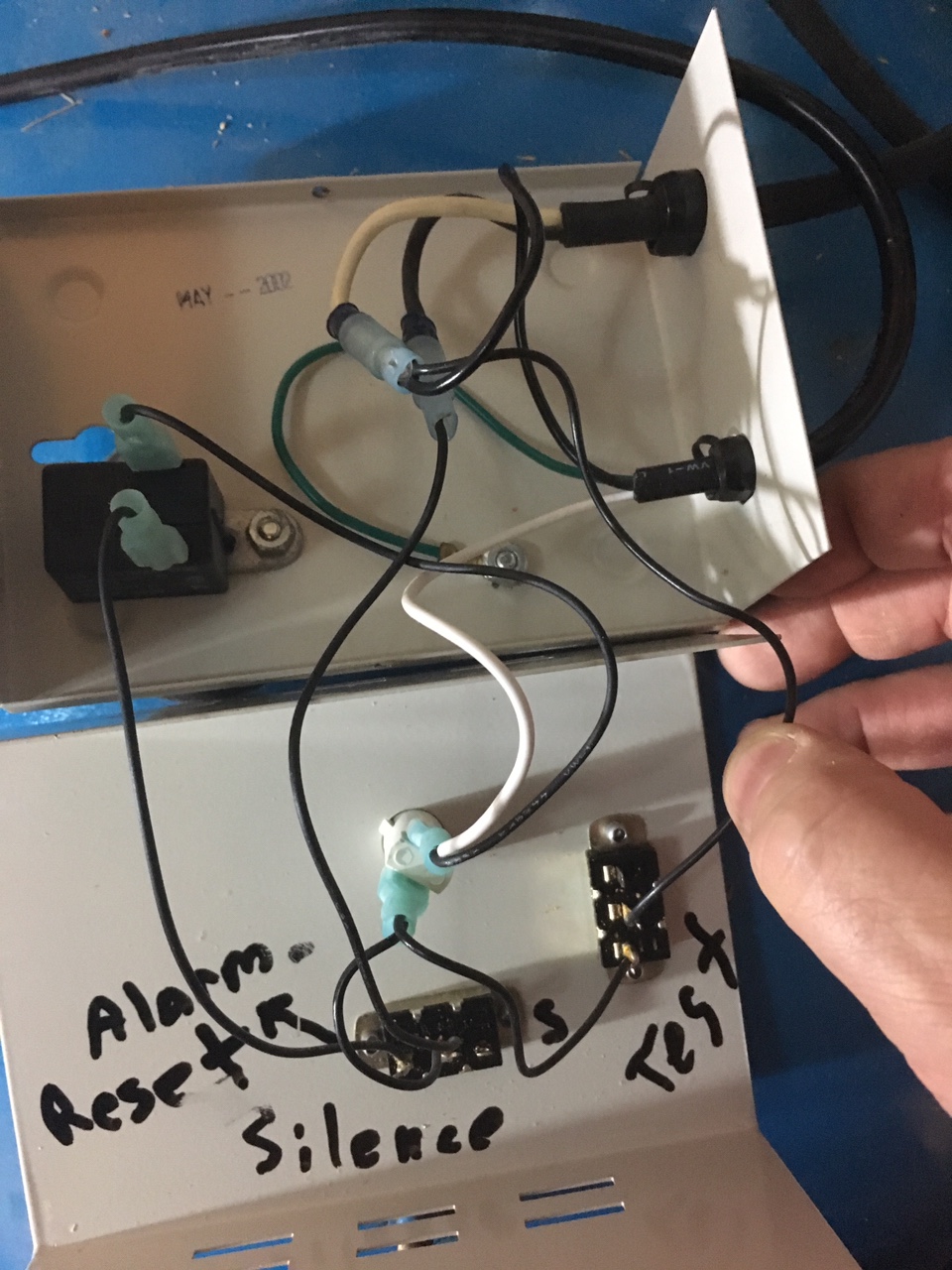

Don’t need to disconnect them. And I did check, and there is no continuity. Here is a better picture of the wiring. IMG_0939.JPG
Anyway, something even more weird happened - the buzzer has now stopped sounding off when there is no alarm condition! I was playing with the box, and it just sort of faded out after humming a bit like it was trying to start, as if there wasn’t quite enough power getting to it. I can still get the buzzer to come full on by turning on the test switch, no problem. (BTW, the light comes on at the same time.). But the “spontaneous” sounding off in normal operation mode has now stopped!
Also, the light does indeed come on when you flip the silence switch over to “silence”, which I suppose makes sense.
Will try unplugging it and plugging it in again tomorrow, but for now the problem seems to have resolved itself!
   / Septic Alarm went off #86
Its the test switch going bad. This picture fixes the issue i had with the wiring question i had. I thought all 3 tabs on the silence switch had wires. Now i see exactly what the issue is. The test switch is failing and allowing a test function to operate when it doesnt call for it.
Well, like I said, the problem seems to have resolved itself for now, but if it happens again, I will just snip the test switch wire and see if that stops the buzzer.

OK, OP here. I have now opened up the alarm box (which, fortunately, is inside the cottage), and tested the wires going out to the float. Joy! That circuit is open, meaning the float switch is off, as it should be. (Remember we tested the functioning of the pump earlier, by running water enough to fill it up and then listening carefully outside to hear the pump star and stop after the water ran for a while.)
So, the problem is inside the alarm box, which is of course very simple, and as far as I can tell consists of a buzzer (the dark shadow in the corner), a light (the white thing with the green terminal connectors), and two terminals/switches (one of which silences the alarm buzzer, and one of which tests the alarm buzzer). My guess is that one of these switches is defective, or MAYBE the buzzer itself.
Next step is to check and see if I can get parts for this thing.
One thing that confuses me is why there is a (hot) wire which coming from the receptacle plug and going down into the cable that goes out to the float switch. Why would we need power to go out to the float switch? Is there some sort of step-down transformer?
I just happened to be in my basement looking at my septic alarm and thought of this thread. My septic alarm in the house plugs into dedicated non-GFI. Then they ran Romex out to the tanks, but the Romex is marked low-voltage. Are you sure that wire out to the float switch was really “hot”?
