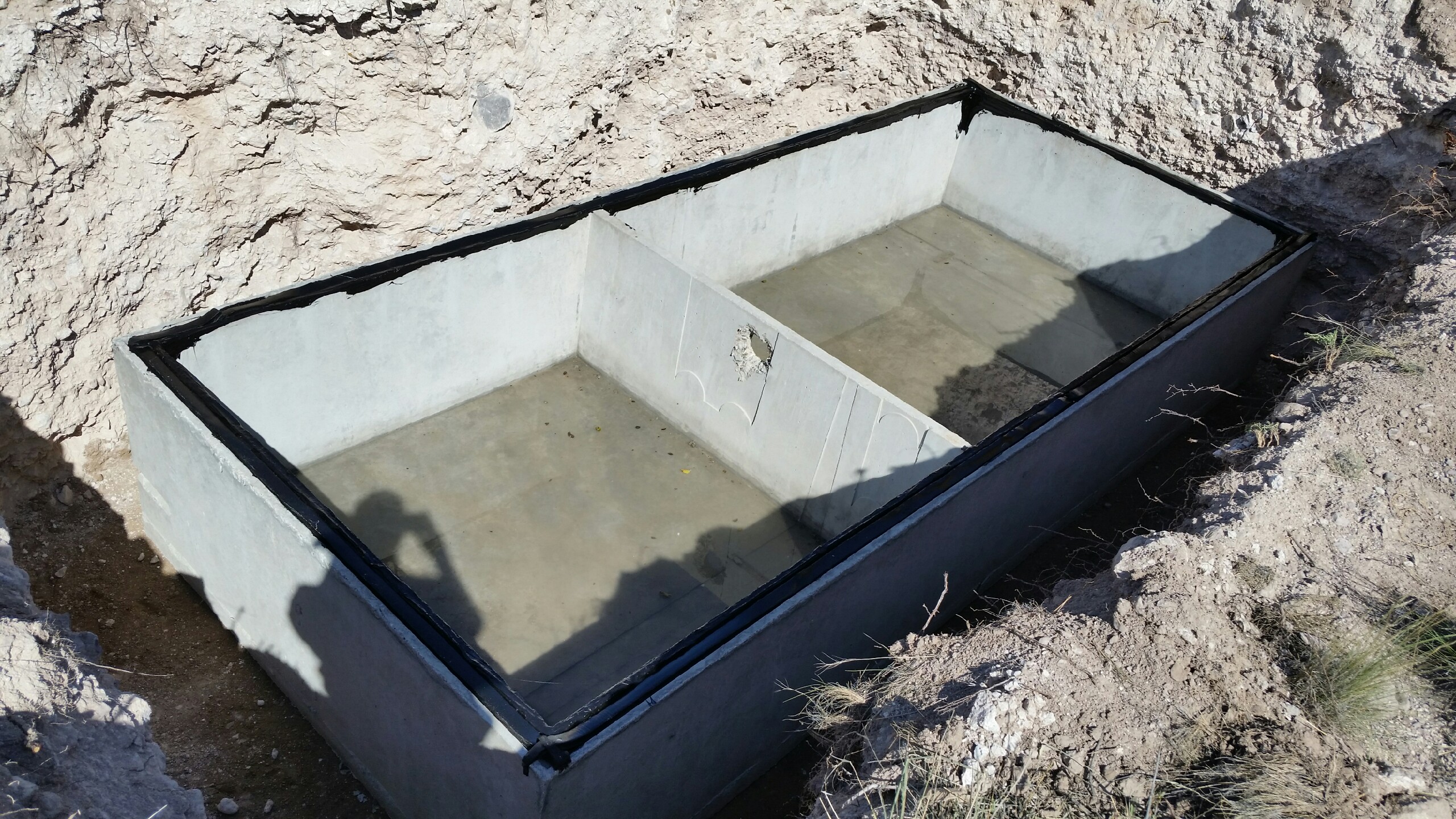

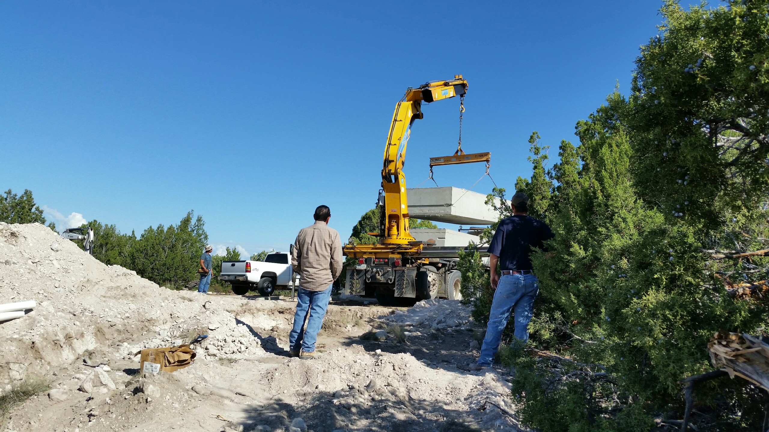

#73

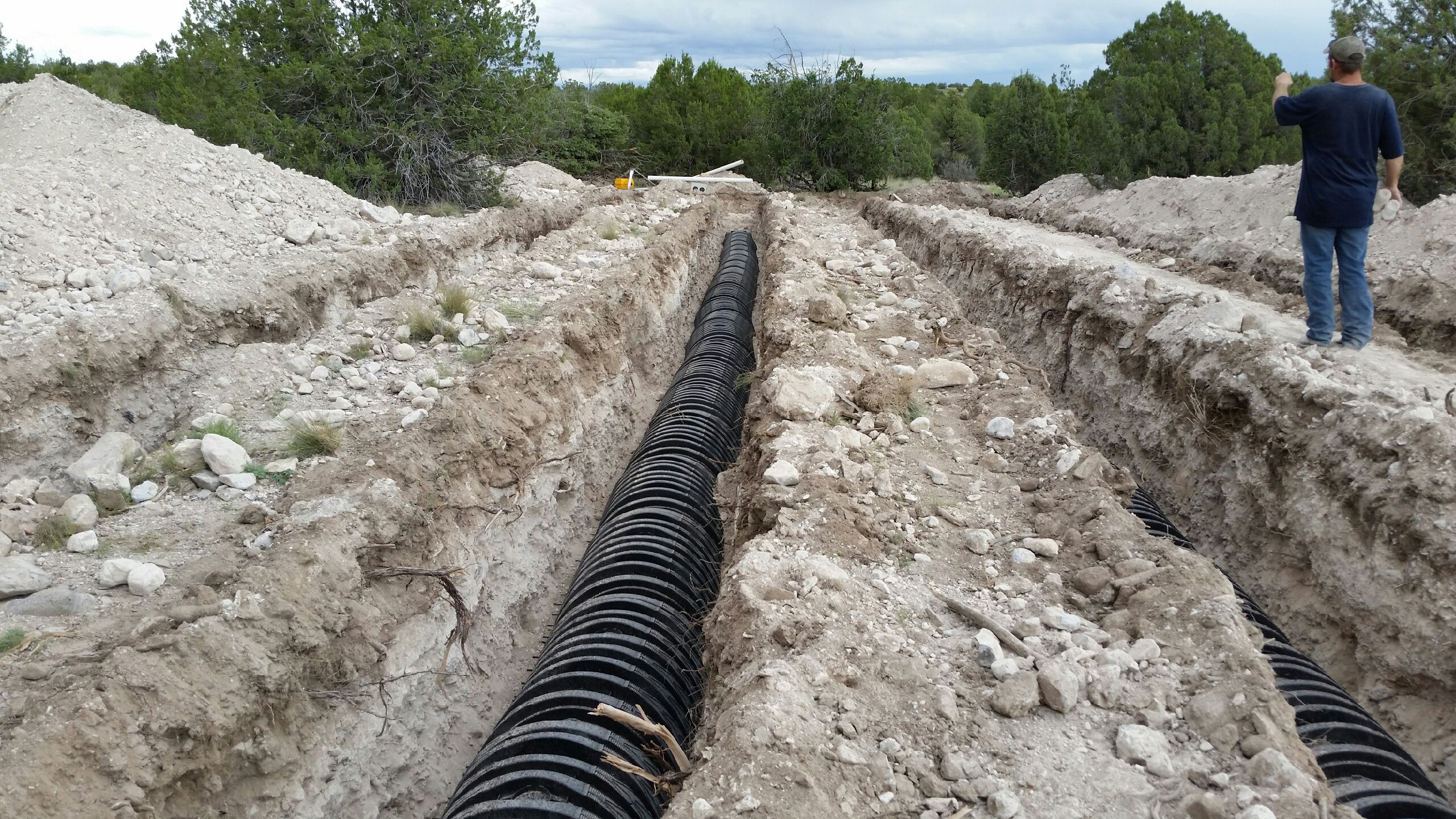

They installed the field and tank
   / Septic System - Infiltrator System #74
WOW! Now that is a drain field !
#75
It's a little overkill but that's just that way I do things. :dance1:
This septic system/leach field will outlive me and the next family living on that land will thank me for building it that way.
I went with 89 chambers and a 2,500 gallon tank. Total, including all supplies and labor was around $10k
   / Septic System - Infiltrator System #76
That is an amazing price... just about what my Washington neighbor paid for permit and engineering...
Looks very good and something to be proud of.

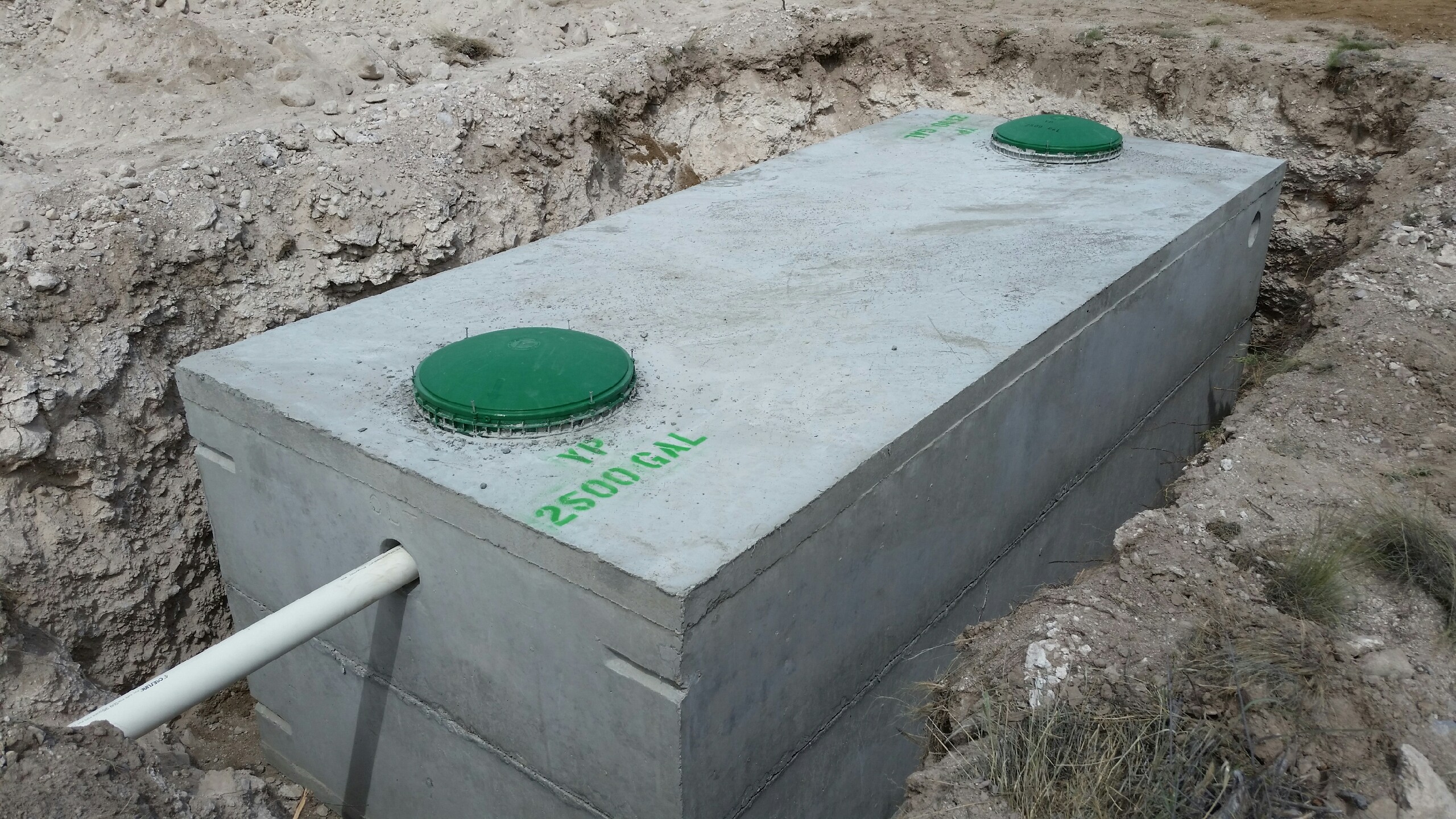

Looks good . Some risers on the tank to bring the lid's to the surface may not hurt.
I agree. I ordered some 12" risers to install. Is it OK to let the risers sit a few inches above ground? This way it's easier to find and to pump when that time comes.
