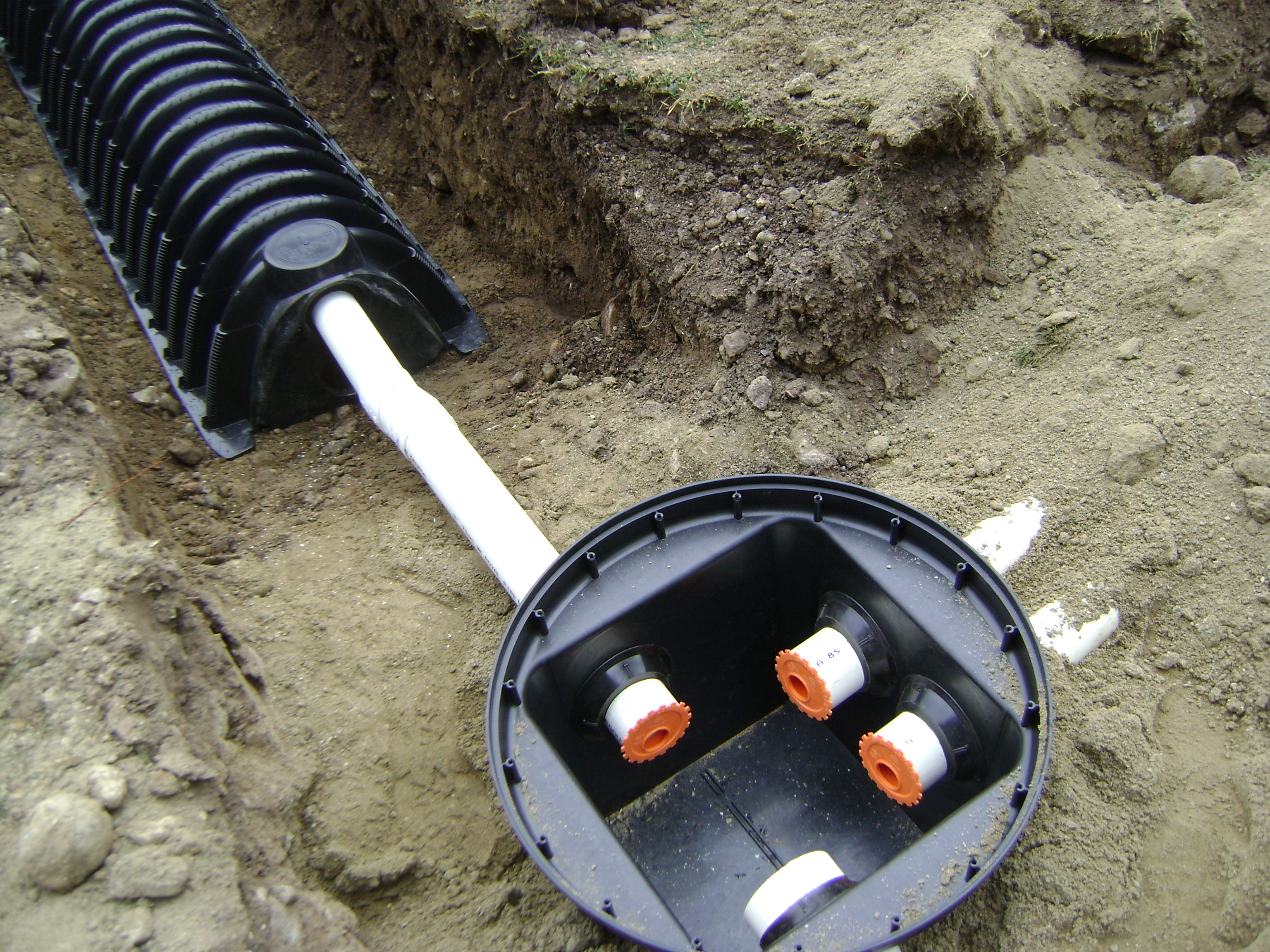

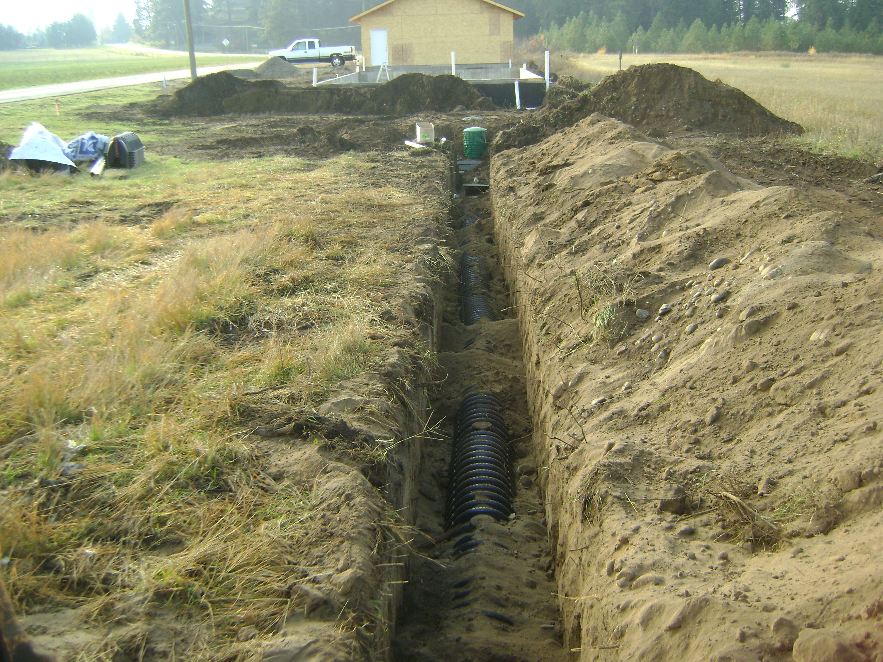

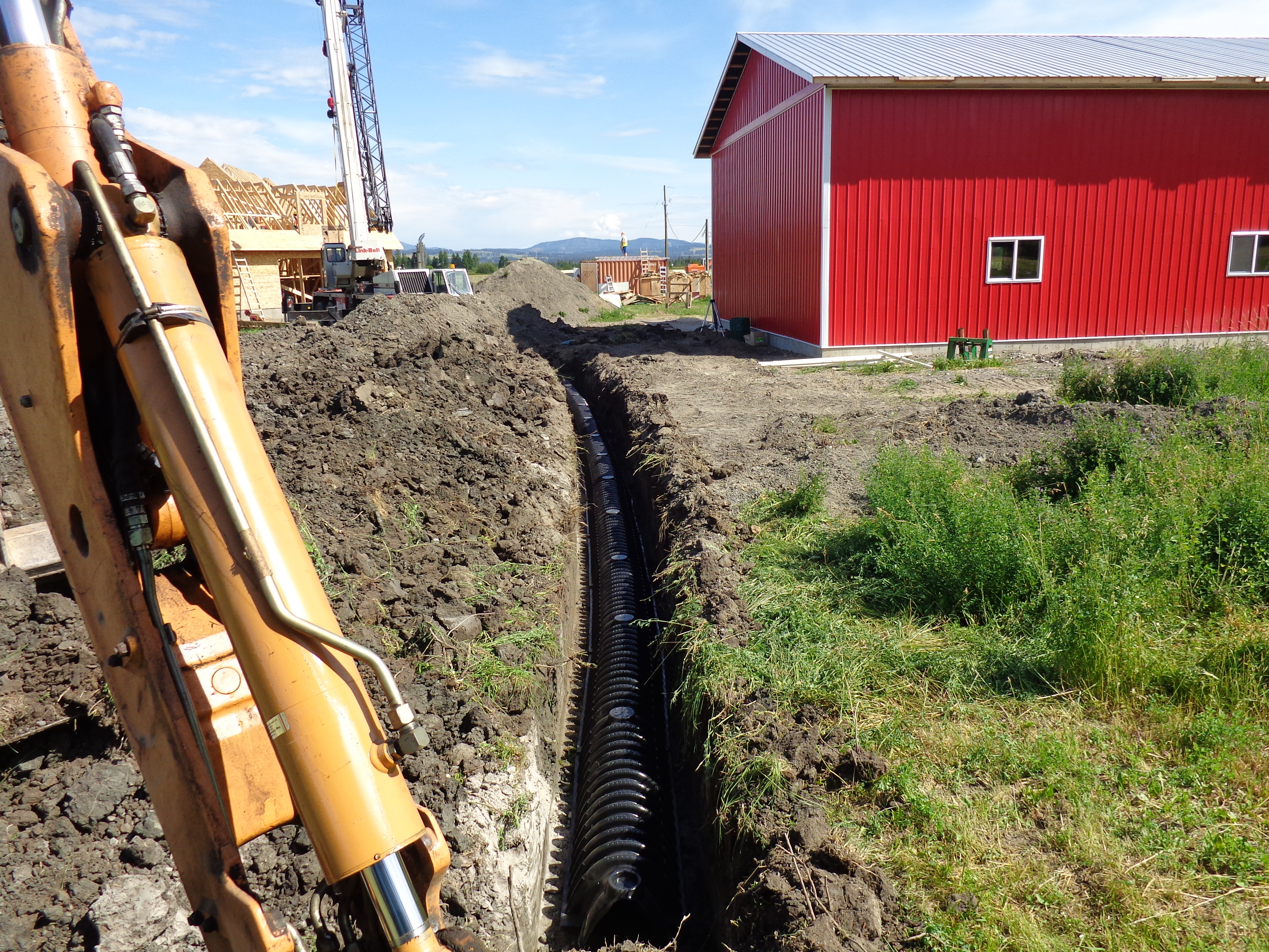

I would definitely go with a D box. I don't have your info for calculating the proper hydraulic loading rate for your field but a level D box with speedy levers so each run gets equal distribution. The chambers are louvered so infiltration of native soil isn't a problem. If the soil is such that it takes water well using it for back fill is fine as long as the field is not to deep 24 to 30" is ideal. So oxygen can can get into the field and feed the bacteria. If 4' deep I'd rec-comment either washed rock or coarse sand which is more reasonable to buy and will do the job filled to within 12" of the surface.
These are pics. from 3 different fields.
