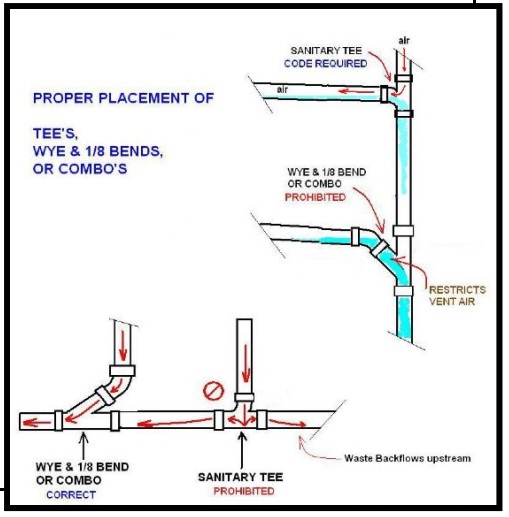

Might just be the way the vent was installed. I'm not a plumber either, but the correct fittings need to be used and not just a regular Tee's, and how they are installed is another issue
