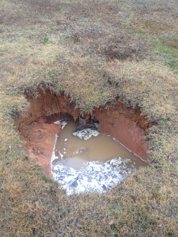

This how I found mine yesterday. It needs some maintenance :)
Now, YOU have a problem. :D

The funny thing is we were planning on moving the tank because we are fixing to build a packing shed with kitchen for processing vegetables. We just are starting a little sooner, I won't have to poke around the yard to find it. Who wants to help???? Peanut butter sandwiches and water will be provided.
Yes, I would say you need it immediately! Sorry for the problem you have. We have our system pumped every three years and it has been in since 1985 with zero problems. I do have a garbage disposal that injects a bacteria into the system each time you hit the on switch. Everything is fine as of now.
Down the road from us we had a system fail, I assume it was never pumped and the guy had a water softener system that he auto back flushed and pumped into his septic tank. Costly situation for sure.

Thanks for all the help guys, I will get it pumped.
