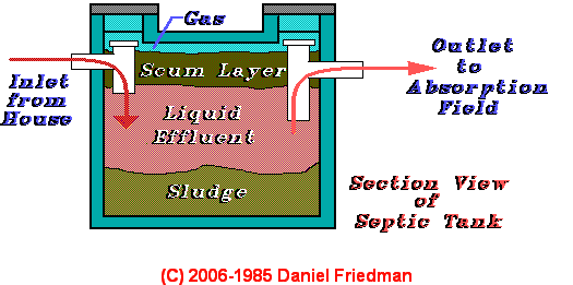

No, previous post was right. Two 45s with a short section between, clean outs every 50 feet. Reason being, most snakes only reach 50 feet and most snakes hate 90s. Make sure there is a tee at the tank outlet too, makes it harder for solids to float into the drain field.
Not questioning you, but can you show me a picture of what you mean, so I can understand this idea?
/ septic tank question #35
Is this what you mean?
/ septic tank question #36
If we are talking about the t on the outlet, yes. Great picture. Stuff will 吐loat in/on the scum layer and the longer tail on the t is to keep liquid only in the drainfields (absorption field). Once solids start entering the field, it becomes a big issue. Next thing you know, the tank is overflowing and someone called and complained. It may very well be salvageable but (at least locally) the inspectors know zip about it so they condemn and order all new.

There are baffles at the top & bottom of the tank between the inlet & outlet pipes. That should prevent scum & sludge from migrating from the inlet side to the outlet side. Unless of course you dont pump the tank occasionally then the sludge eventually makes it's way over the baffles & into the outlet pipe then plugging the leach field.
