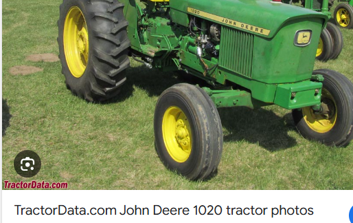

There haven't been that many Deere's lacking a front grille, so that's your clue. Trouble is, that one doesn't look like any of those I know (eg. 2510, 4040, etc.).
/ Serial Number Decoding #5
Your tractor appears to be a 1968 model 1020.

Also think a JD 1020 from Dubuque and pic confirms it is a 1020, to me. 4 cylinder diesel. Curious if that is a molded weight added ahead of the grill.

I don't understand your statement. I still think tractor in your original photo is a 1020

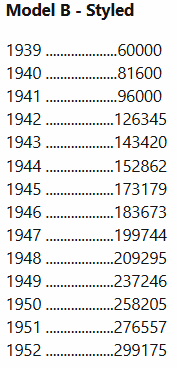

Congratulations on being able to figure it out. I have a JD B that we believe is a 1954. The SN tag was painted when they restored the tractor. I can’t figure out what the SN tag says and we’ve tried quite a few things to remove the paint so we can see it - so far, it hasn’t been successful.
/ Serial Number Decoding #14
You have a very nice appearing model "B". JD B is definitely not a '54 as last model manufactured was a '52. Model 50 replaced model B.

/ Serial Number Decoding #15
Ok..
So, then this is an older tractor than what I was originally told. The tractor was my Father’s Uncle’s tractor that his daughter had refinished and I purchased it to keep it in the family (I can still remember when I was little and I could stand in the tires).
I’d love to get a serial # authentication through JD if I could figure out what it is.
