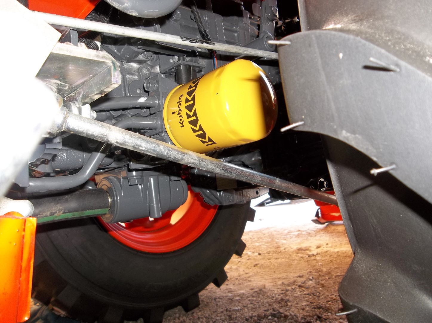

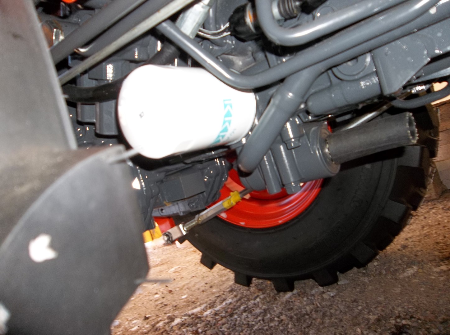

   / Servicing Trans and Hydraulic Filters on B2601? #4
Like I said in your other thread, you are right....the manuals suck! LOL. Nothing is accurate at all.
Anyway if you are using Kubota filters here is where each go.
   / Servicing Trans and Hydraulic Filters on B2601? #5
Sitting on tractor yellow is on left, white is on right.

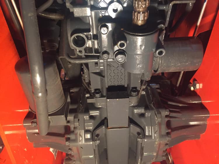

Thank you,,
My Oil Change with filter is completed. Lol
I'm not sure what filter is what when it comes to the two Trans and Hydraulic filters.
The OEM filters present ( photo ) don't seem to have any # numbers on them.
The two Kubota filters I have with the correct part numbers are White.
One is just slightly longer than the other. Both White.
