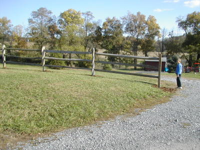

I've always just used the dirt from the hole. They won't go anywhere. I'm moving a rail fence that is 6-7 yrs old, just took rails down and pulled the posts out of the ground, used the FEL to pull the really tight ones. I did take the suggestion and put one of them in a 4" pvc sleeve, because I might want to be able to remove it to drive thru that section. For a gate post, I did tamp it with stone dust (thats what it's called here). It does pack good, will see how it handles the kids swinging on the far end of the gate.
